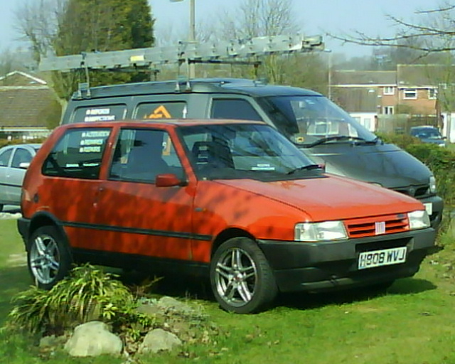

Slow progress over last couple weeks but finally got somewhere today.

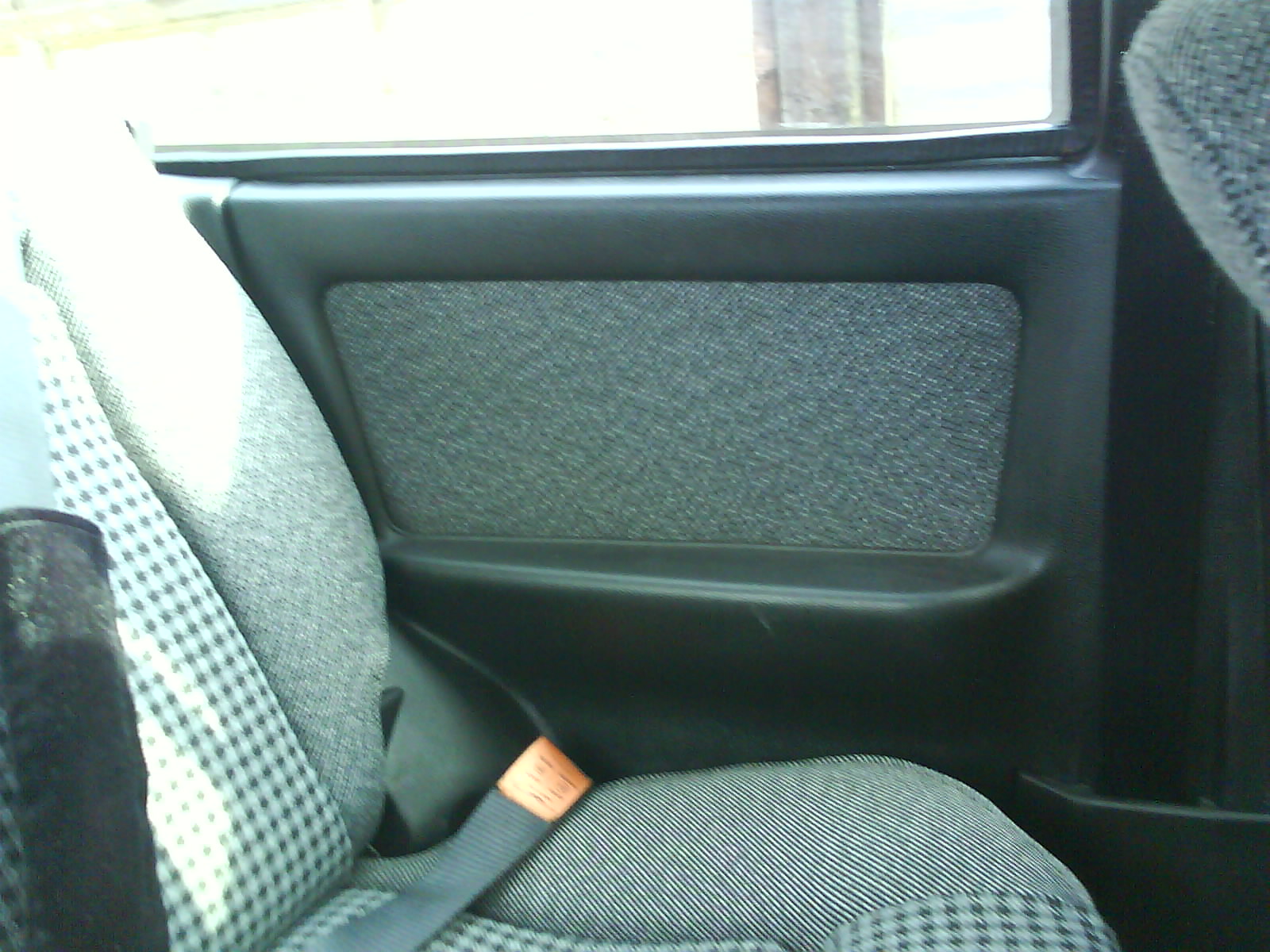

All front and back interior is now fitted (no more ****ty brown bits)(y) except the front door cards as i need the electric windows.
also got all the wheel arches on.
new clear side repeaters.
colour coded wing mirrors.
side skirts should be next.

Good progress Dale!
Only thing I don't like is the side repeaters. They look too modern for me and lose the 'angular' characteristics of the Uno design. Just my personal opinion though, not a criticism :)
Otherwise excellent job so far (y)

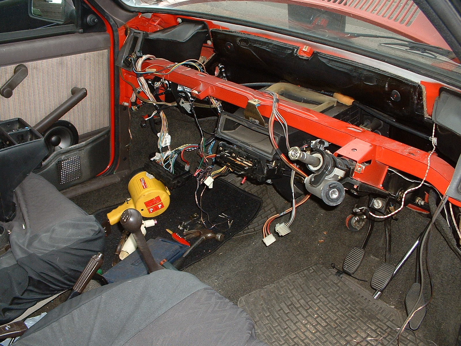

Edit: Interesting to see how without the dashboard the front of the mk2 is almost identical to the mk1! I know all too well what it's like to swap dashboards and wiring over :bang: ;)

Just a thought but if the door cards dont have holes for the winders then just cut holes out for them.
As long as the holes you cut are smaller than the base of the winder you wont see them and will look like they are meant to be like that

I think Dale intends to fit electric windows eventually and doesn't want redundant holes left in the door cards ;)

and i do have the front door cards from a turbo with the holes for the electric windows which i have all the kit for. :D

It's not that difficult, I retrofitted electric windows from a mk2 turbo into my mk1 45S. If you can extract the electric window loom in its entirety from a Uno fitted with them then it's possible to fit it into a non electric window Uno loom and make it look like a factory fitment. I did it without any horrid Scotchlocks or nasty crimp on connectors and only used the original Fiat connectors! Have a look at the wiring diagram in the Haynes manual and you will see it is actually a rather simple circuit. It's the central locking system that's way more complicated, hence why I never fitted it to my 45S.

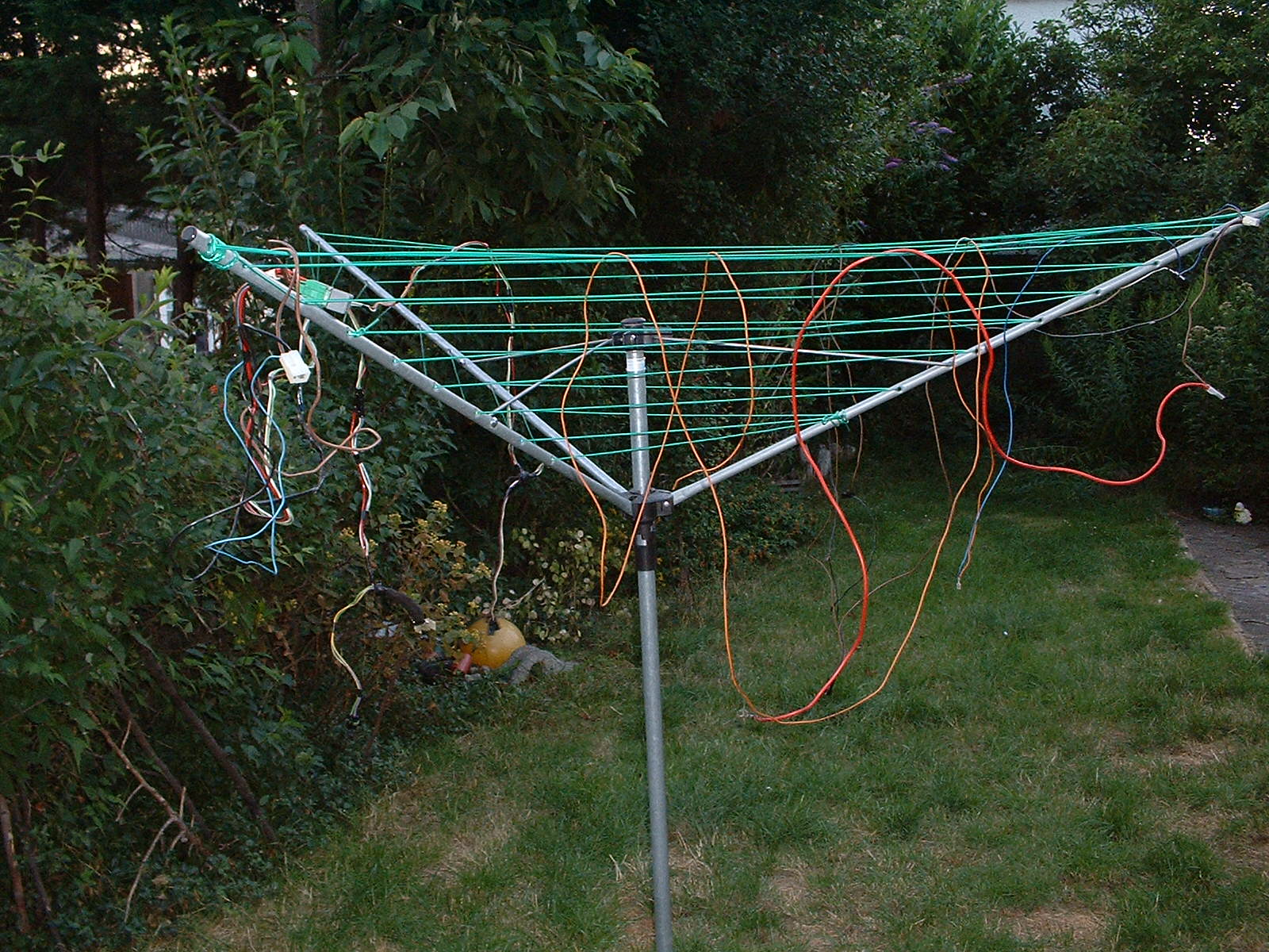

Here's a picture (below) of a mk2 Uno Turbo electric window wiring loom being hung out to dry! It had a lot of sticky goo on the wiring from insulating tape so I gave it a good wash and clean. Worked a treat after fitting as well (y)

It's for the windows and it's just a relay with the fuse holder clipped onto it. Electric windows are actually very simple - compare the wiring schematic for those with the wiring schematic for central locking (in Mr. Haynes' manual).

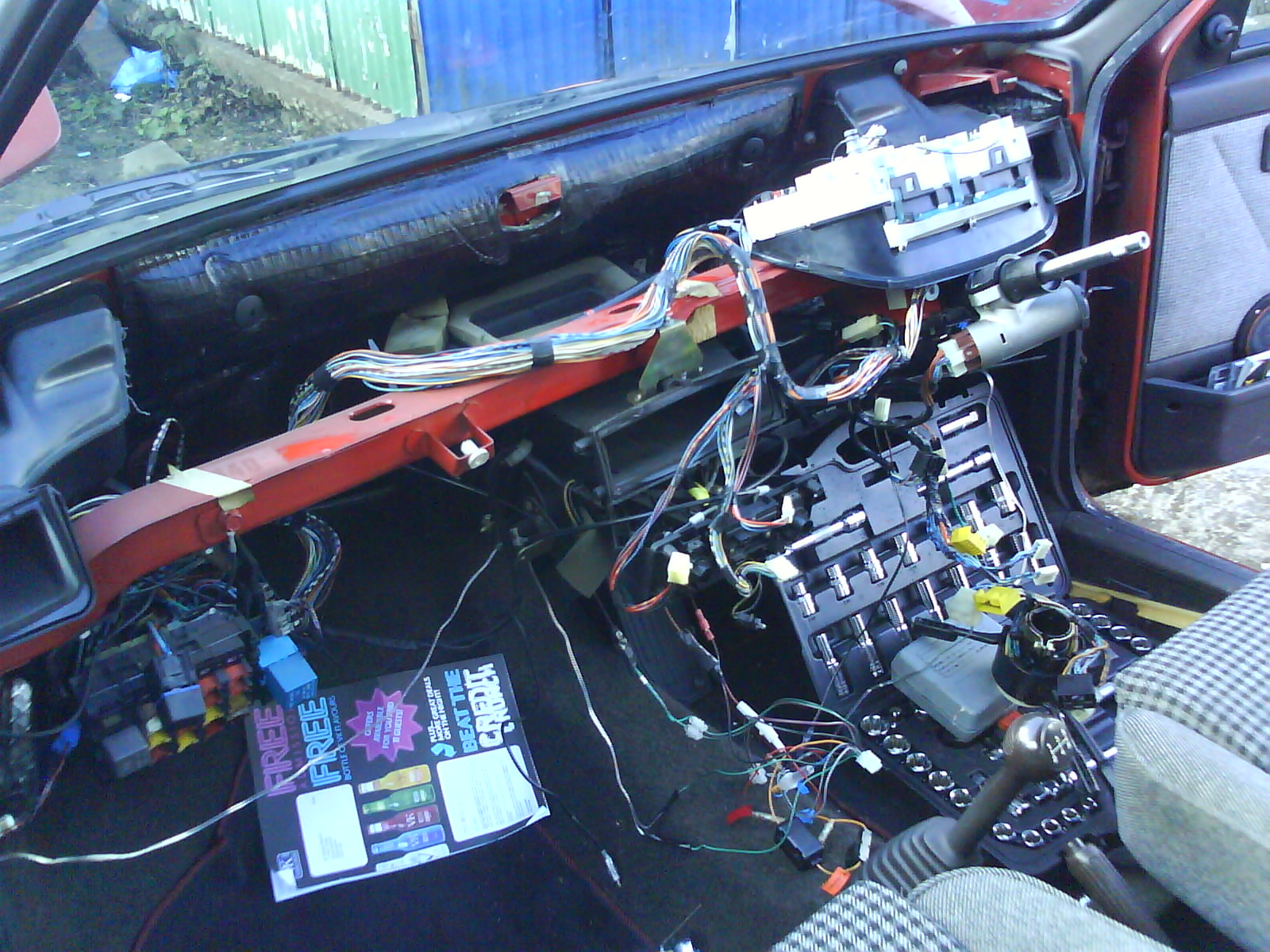

And if you're prepared to fiddle with watchmakers screwdrivers you can unclip the individual terminals from the UT wiring connectors and then refit them into the loom connectors in a non electric window Uno. Takes about an afternoon to do it properly, with the biggest pain being removing the dashboard to get at the under dash wiring. At the end of it though you get electric windows that look factory fitted (y)
im going to have some more fun with removing the dash again then.
ill have a read up in the haynes manual and hopefully get a nice sunny dry day to fit them (y)
