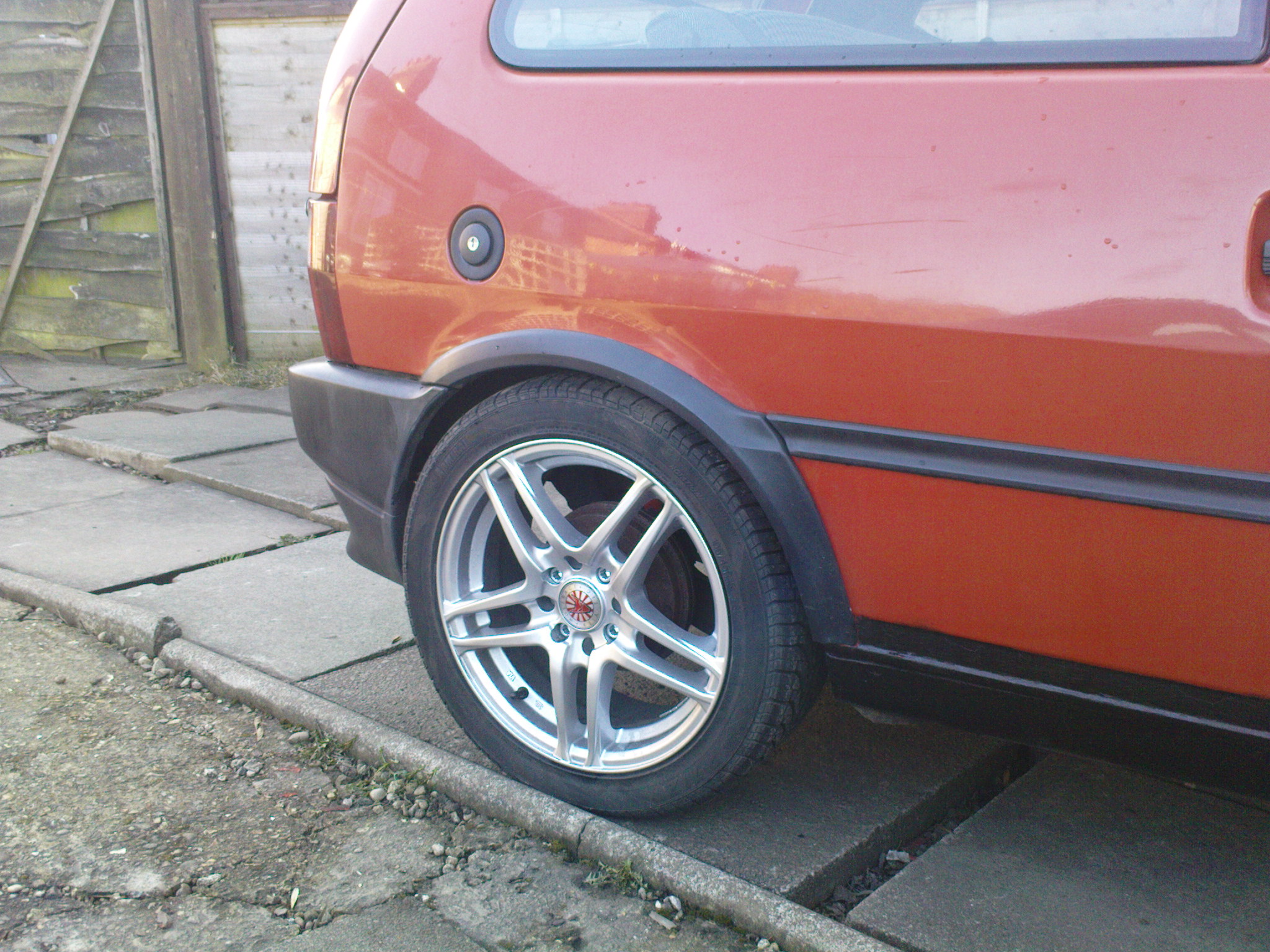

i need help!
i put the back lowering kit on to find out how low it would sit and oh dear it was low.
seems as though 15s were a bad idea ha.
i couldn't go over a stone without it scraping so iv took them off and out the original springs back in.
what is the best/quickest and easiest way to solve it.
i hear of the arch trimming and rolling, but i don't know how to do it so if there is a guide to do it that would be great.
but i was thinking of downgrading to the original turbo alloys maybe....
because even if i make it so i can use my car without rubbing, i cannot have anymore than 1 person in it and i cant wang it round corners.
any ideas?

i know some people have no problem dropping them a fair bit, but it sprung to mind that it aint gonna be too practical as i am going on holiday and taking the car and i only own this car so if theres a problem i either have to put something back to how it was or do a quick fix.
the drop at the back i did looked like the pics,
which looks great. but i couldnt go over a stone or slight turn without rubbing.
when i got my wheels the place i got them from rang up wolfrace and said that they are going on an uno and everything was ok.
also i guess having strut braces would help with the roll, but i do need my car to be a bit more practical. so a slight but good looking drop is what im gonna go for.
if i had another car i would of kept it that low and done work on the arches but i dont so im buggered.
but im currently looking at the 35mm drops to see what it will look like.

Strut braces give rigidity to the body shell, they have no effect on body roll. To reduce roll you can fit stiffer springs and/ or a turbo anti-roll bar.
A 35mm drop is practical for every day use but 60mm will run into problems with speed bumps and will probably knock your fillings out driving on pot holed UK roads :p
Sounds to me though that your offset may not be correct as Dunc pointed out. What size tyres are you running on your 15's?
i think 35mm at the mintue is thr sensible choice:D
on the tyre it says 195/45/15
what offset should they be?
