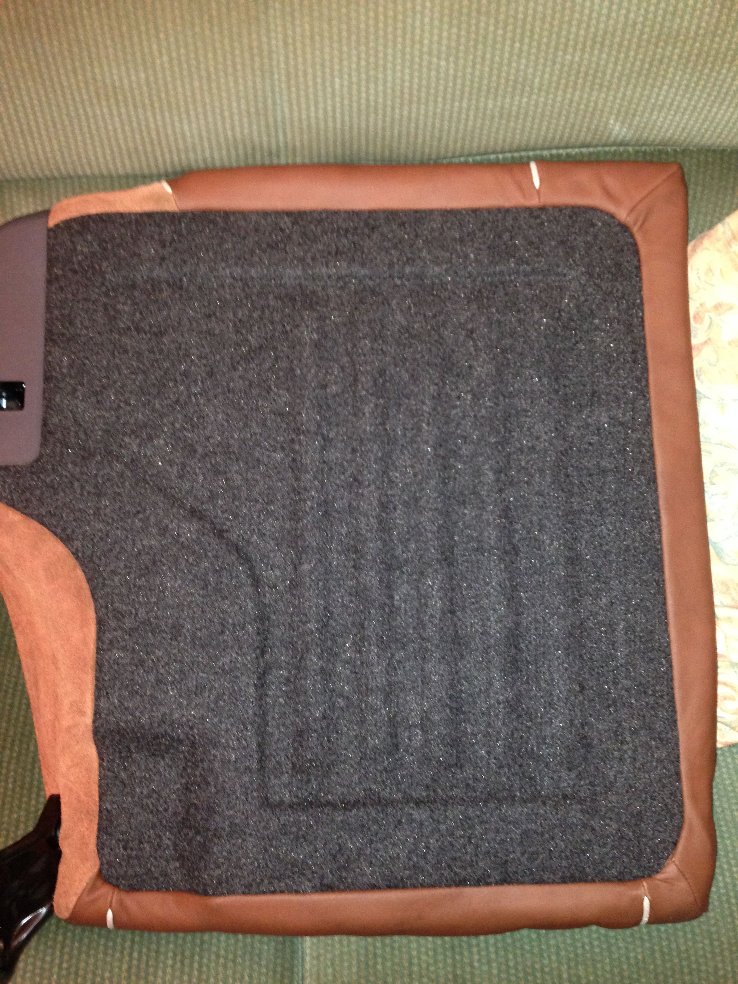

Removed the rear seat backs, and roughly cut the trim to suit:

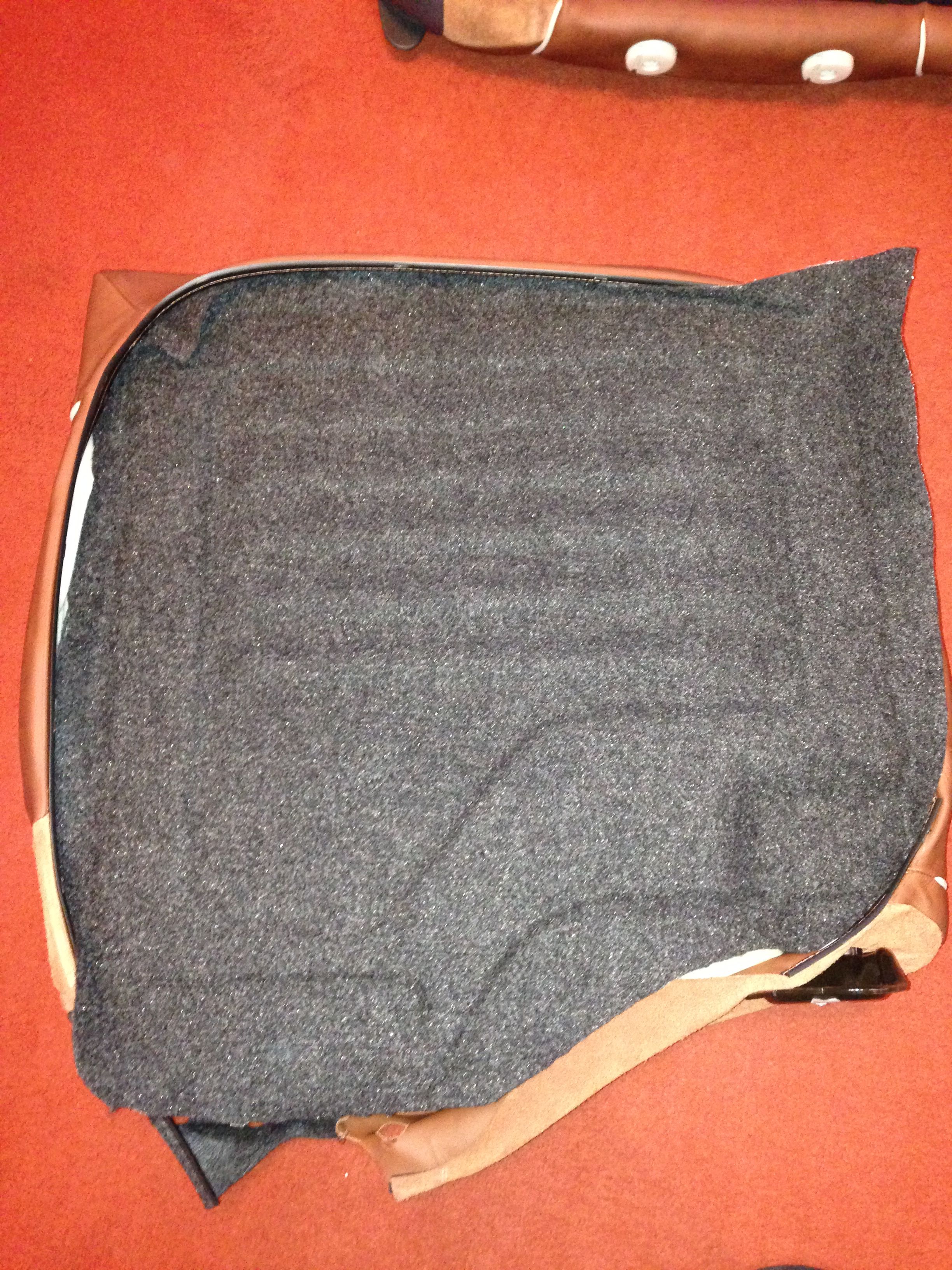

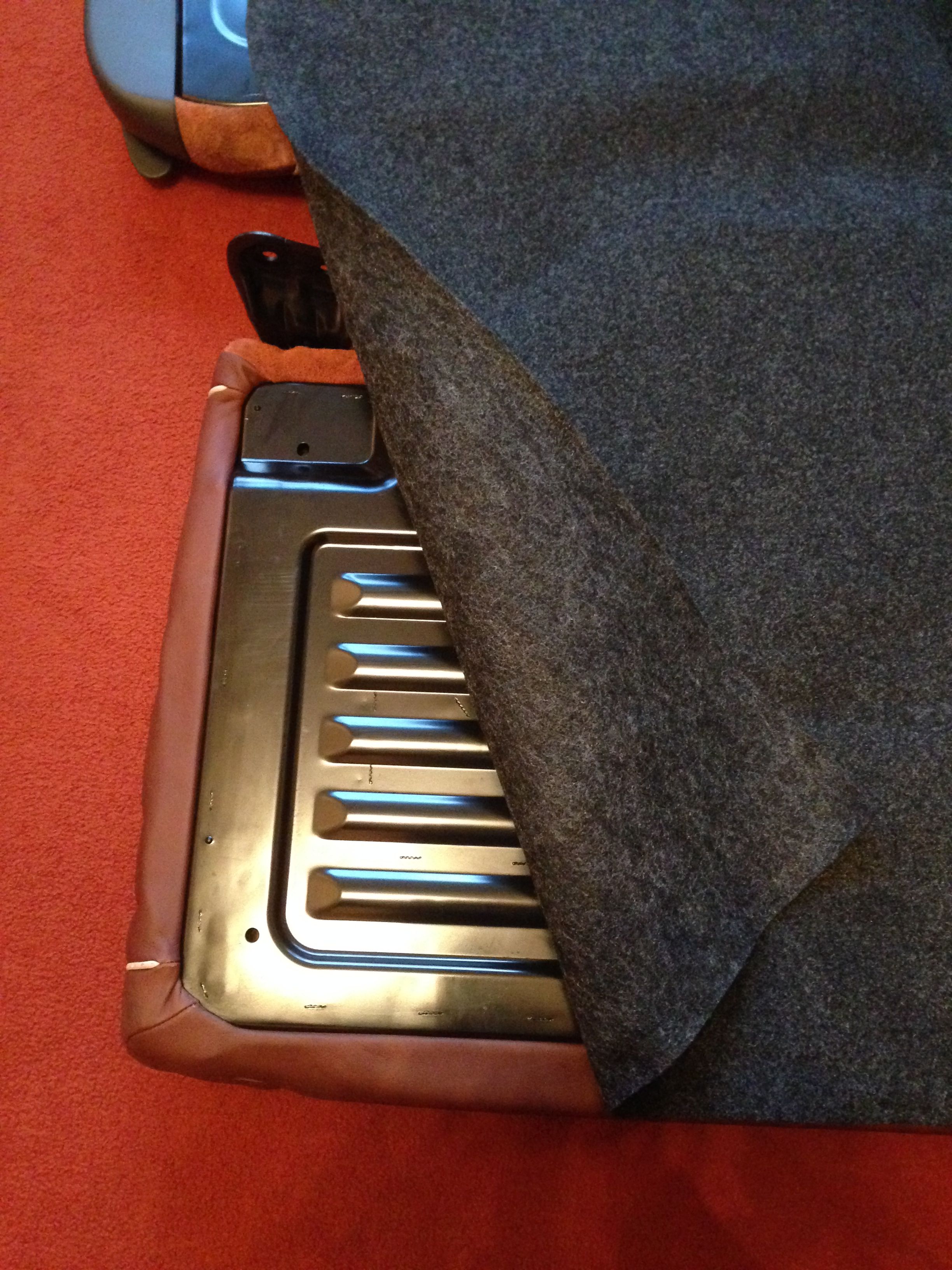

Next, I unpicked the leather from the groove around the edge of the seat frame, and removed the trim around the latch, and sprayed adhesive to the rear of the frame (after degreasing with IPA):
Then I applied the trim after spraying glue to the rear of it:
Once I'd cut the trim around the groove so that the leather once clipped back would push the trim tightly into the groove and hold it in nicely, I then clipped it all back in and fitted the latch trim:

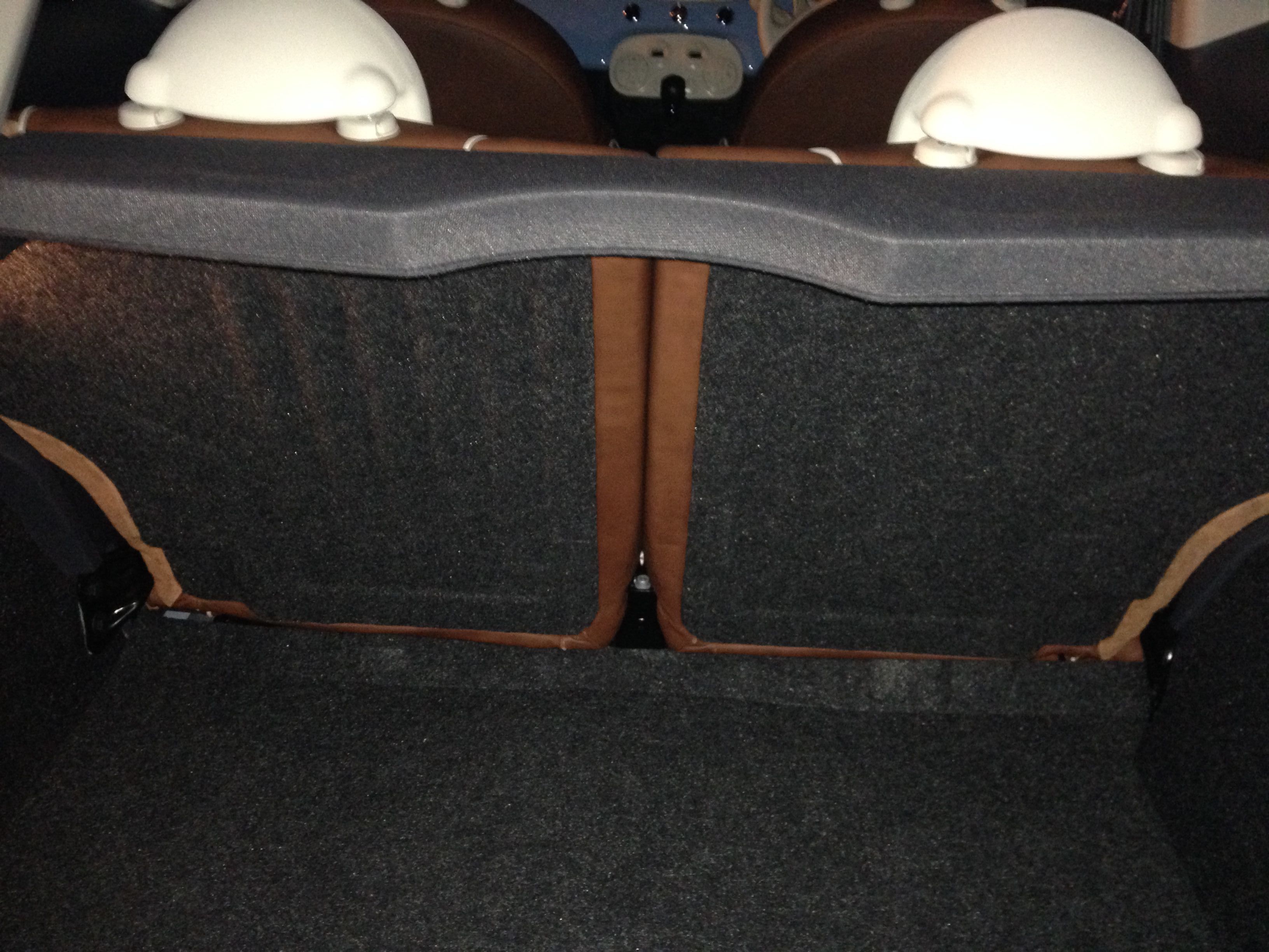

And the finished job (albeit in the dark):
I'm really satisfied with the job, it gives a little bit of luxury to the boot and 'finishes' off the job. And the colour match is nigh on perfect.
That looks very 'factory'.
A really professional job you did there. Made me want to do mine : )
