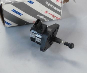

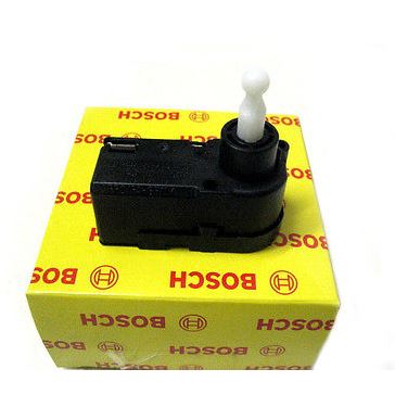

Just the buzzing from the lights I need to sort now don't have a clue what it is so if anyone would be nice enough to point me in the right direction I would be greatful.
The buzzing is the headlamp adjuster in the lamp to stop the buzzing you can either cut one wire going to the adjuster or replace the lamp as it cant be changed seperately .
The headlamp adjuster motor is available separately from Fiat. Part number 9948397 for standard headlamps, or 9949449 Zenon HID headlamps.
