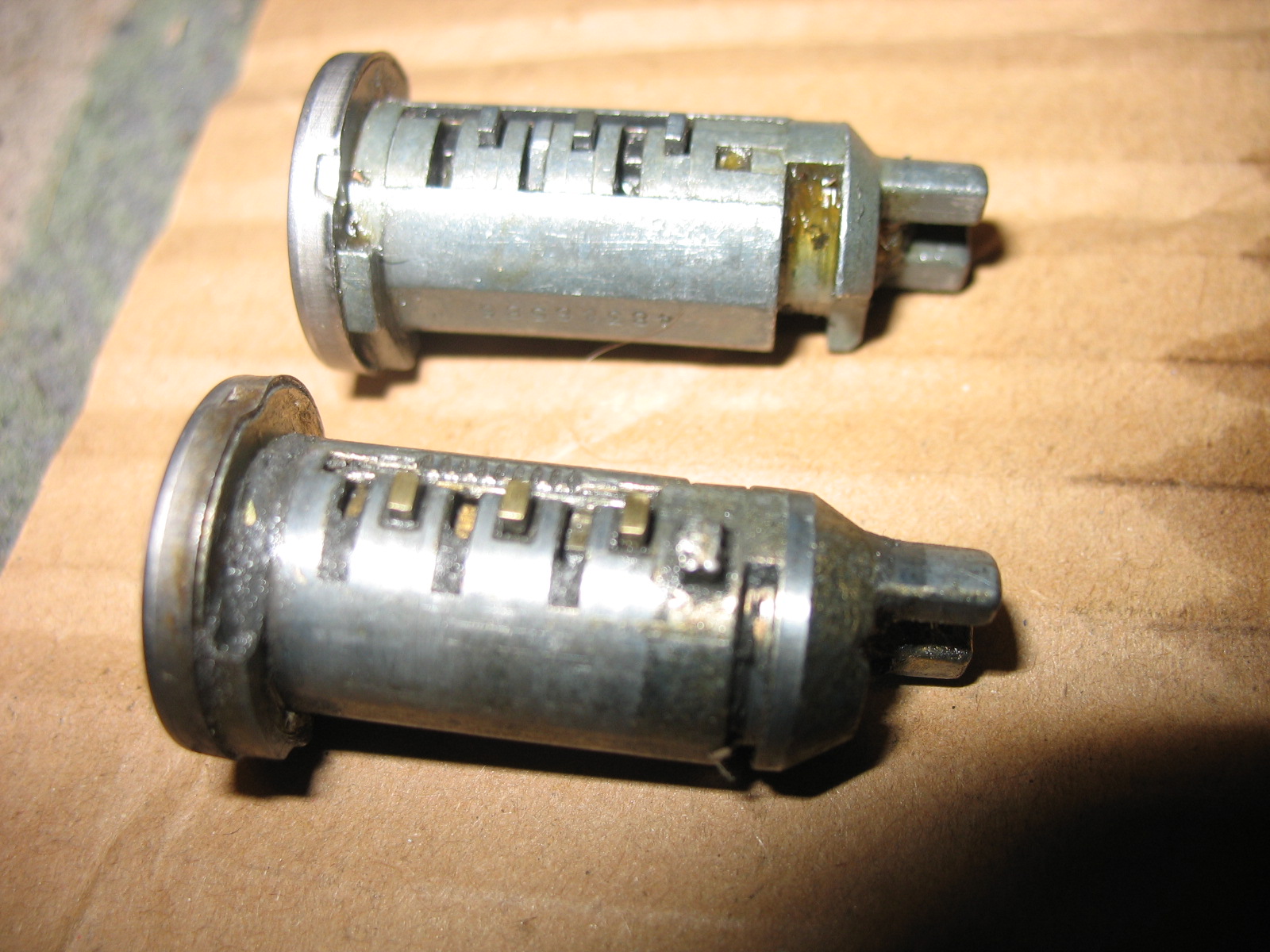

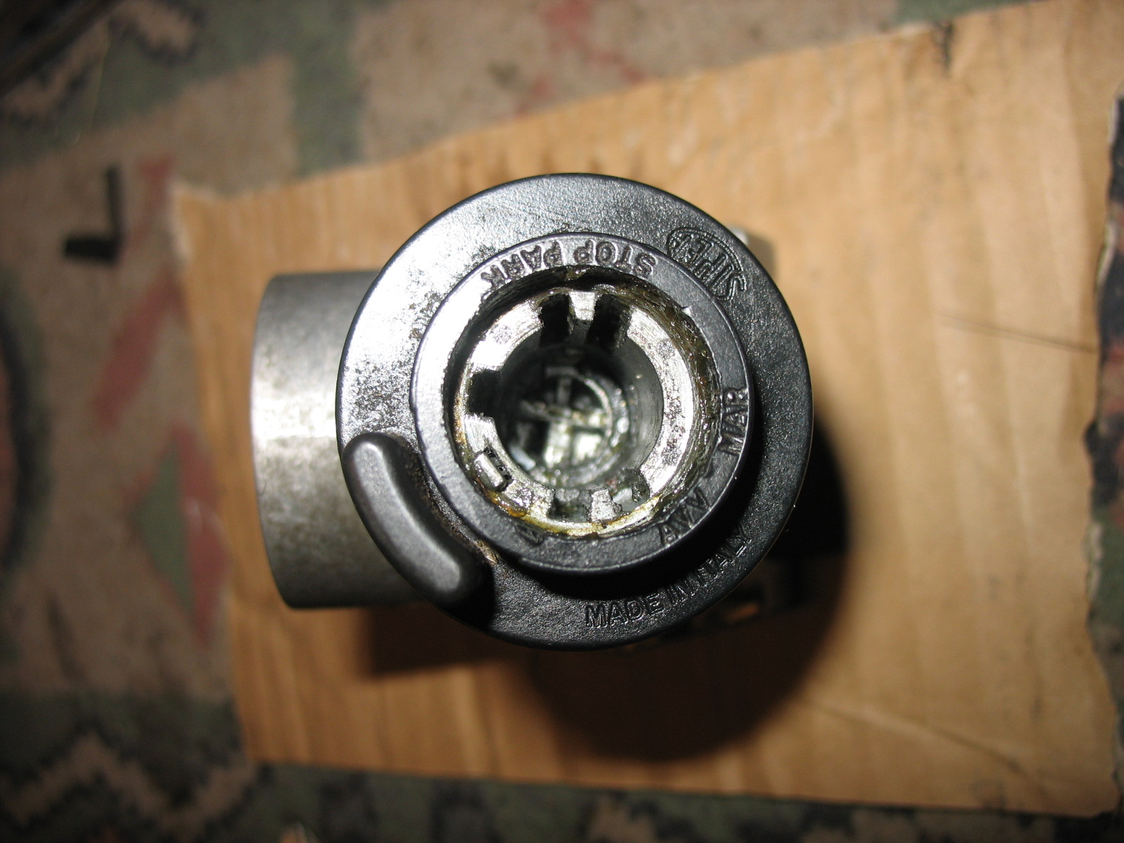

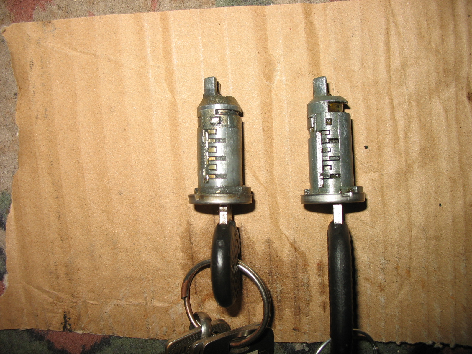

I was hoping that the ignition barrel will be change tonight, but instead of having the job done i've find out that there are two types of ignition barrel and shroud.
Does anybody have spare barrel shroud for the later type?
I have the one off Hilary, she was a '91 so I presume this will be the later type?
It would be appreciated if you could remove the barrel and check which type of barrel you got there. The small round and oval key type classification is no good as i've third set which is small key and "later" type of barrel.
Bottom - my current barrel `89
Top - "later" type, wider slot, smaller chamfer, missing locating lug.
And the shroud, if you got different looking one I will be interested.

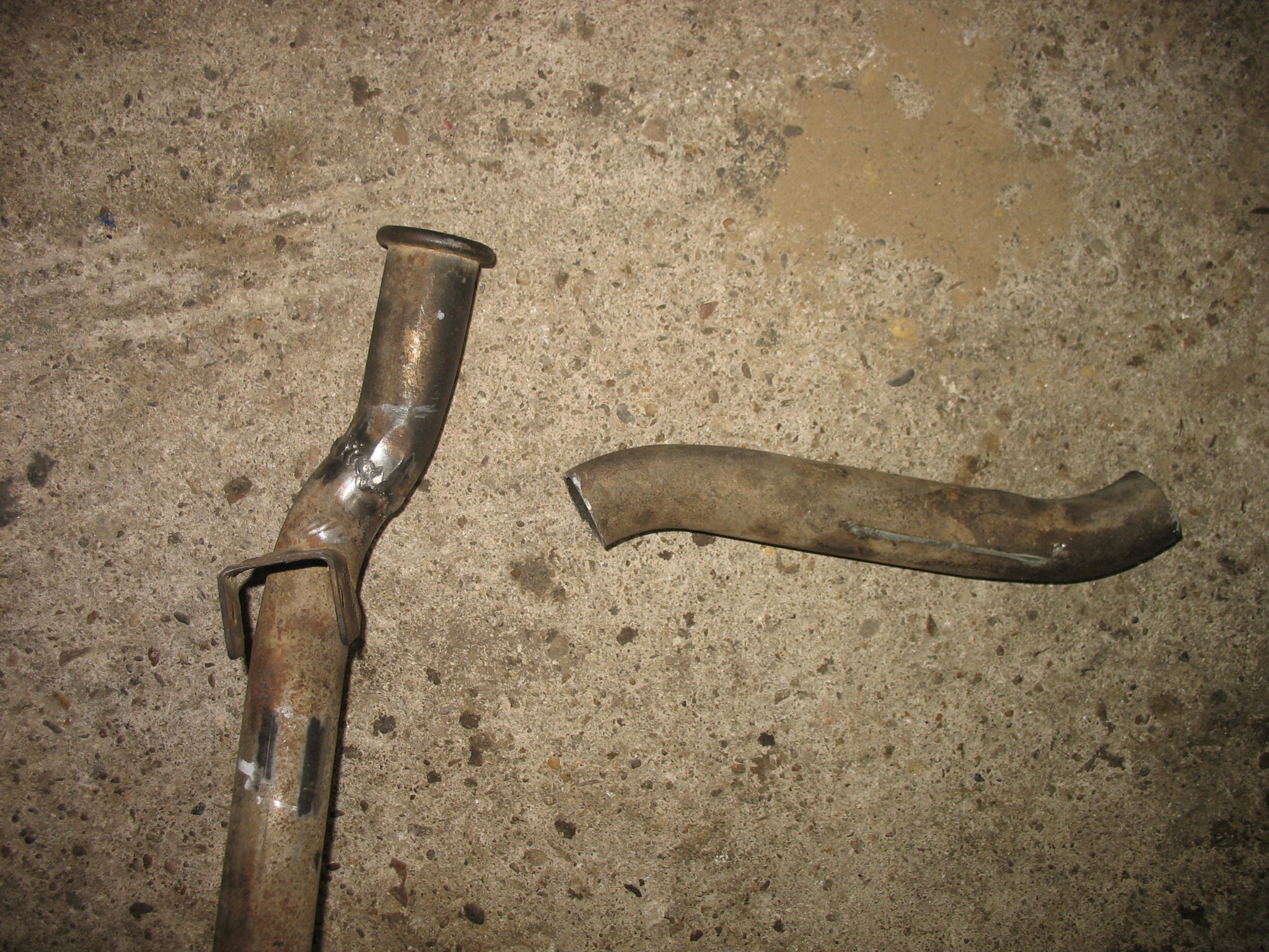

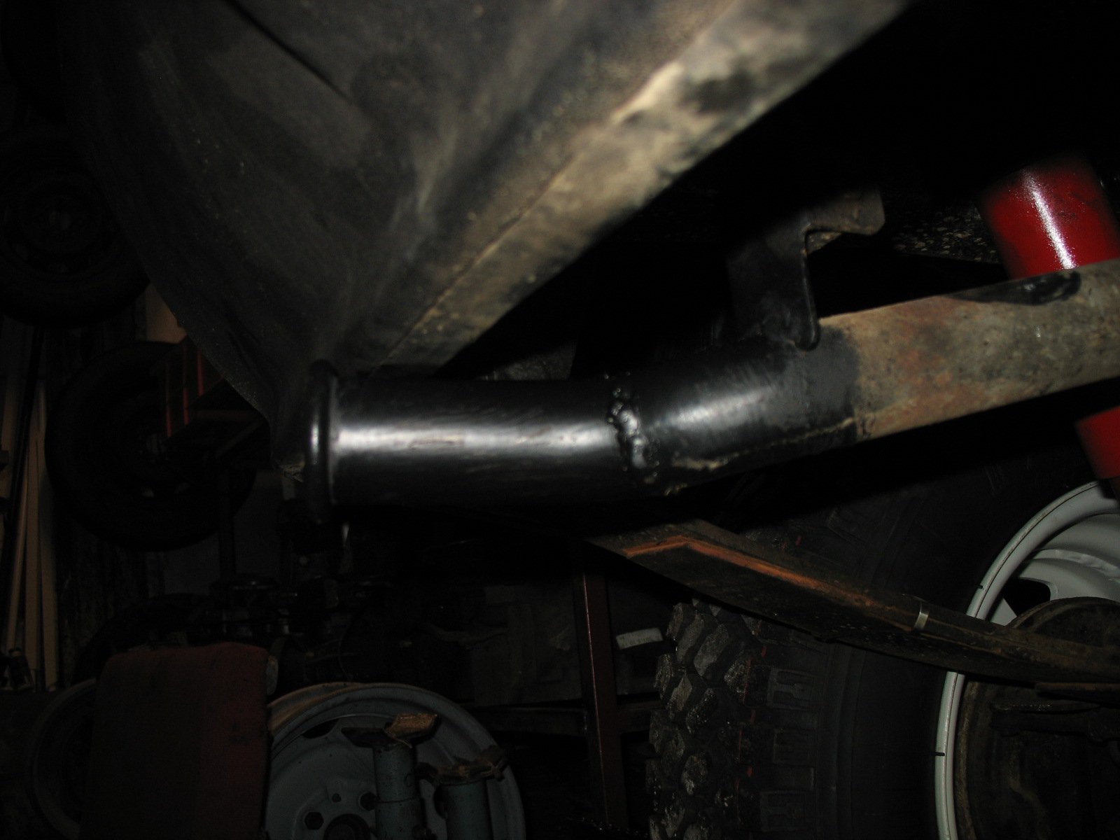

Meanwhile the exhaust pipe was modified not to interfer with the shacles any more

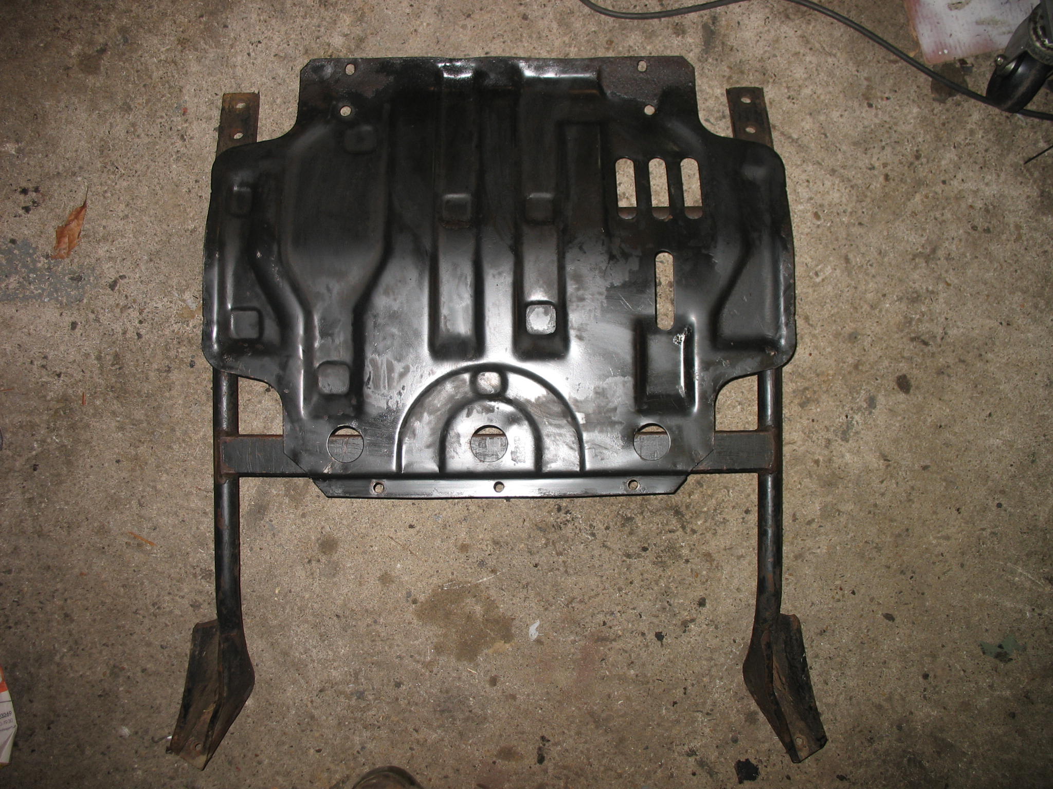

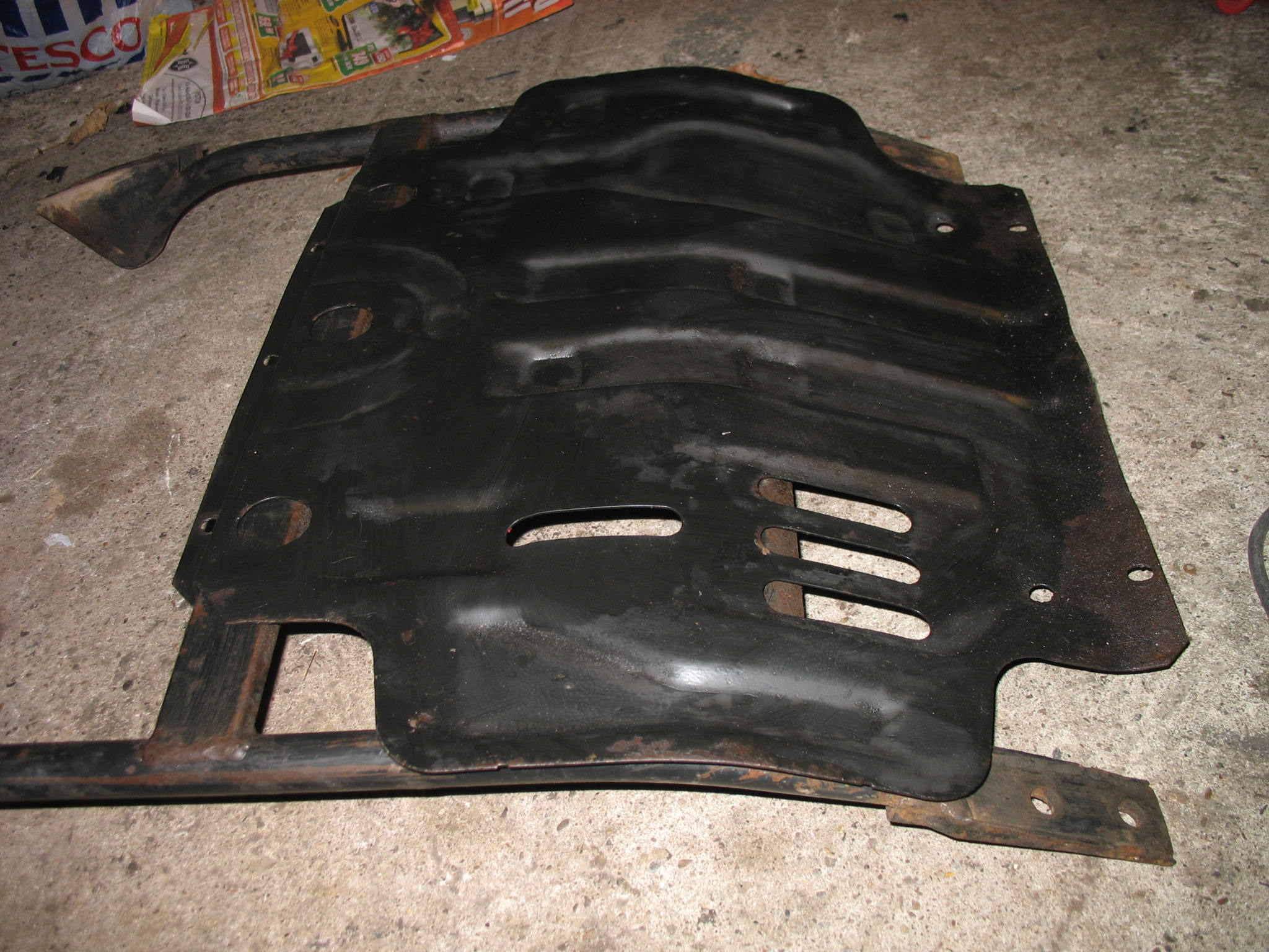

I would have pair of nice rock slider of Old Cheeroke but had no 24mm deep socket or any spaner etc.
For future reference this came of Mitsu Shogun

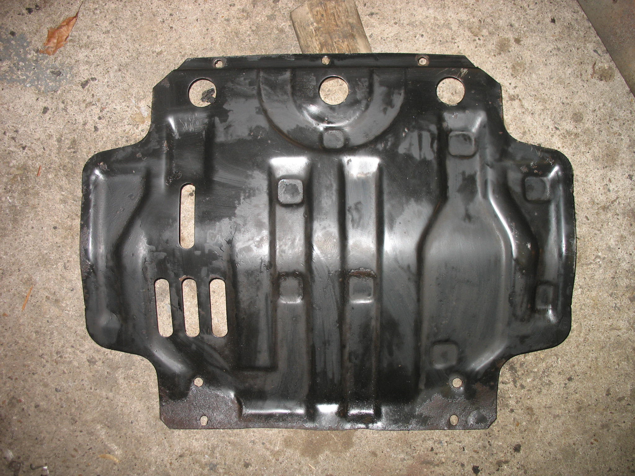

As mentioned earlier the Aluminium composite material might not be too robust therefore this 2.5mm steel nicely shaped with strengthening press-outs
Profile will have to be adjusted for better fit, cut-outs will be blanked and new one added for oil drain and plug access.
And new Dealer sticked on the back window
Mitsu guard just been subjected to small cosmetics operiation on the good old fashion 6" fly wheel press - they are so much better over the hydraulic ones.
The back edge lip has been flattened same as the pressings along the side which were interfering with frame. Now it follows the profile reach over to the front cross member/bumper.
Now back to extending the frame to gain protection for the gear change rods and propshaft cv joint.
