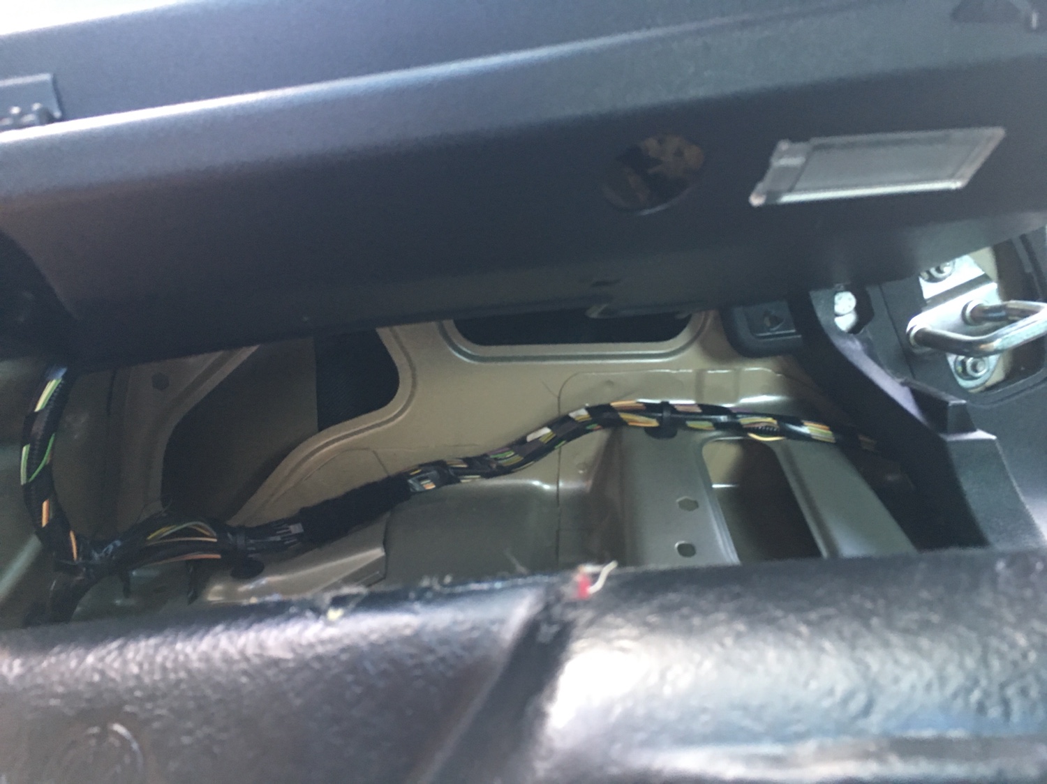

Was the wiring already there in the boot for the 12v socket or did you have to do it from scratch? I’m sure I’ve read that the wiring for the socket is there, but no socket is supplied from factory, but the whole for it is there.
I’ve had a look today and cannot find the wiring in my Punto Evo GP.

I’ve done a little digging and unravelled some wires yesterday to see if I can find it but the rain has stopped me searching for now.
Only gone as far as around the wheel arch area, but it may be further away so will be looking tomorrow weather prevailing.
If I find it I’ll make a thread so people can find it easier.
If it’s not there, I may try fitting one myself, if it’s easy enough.

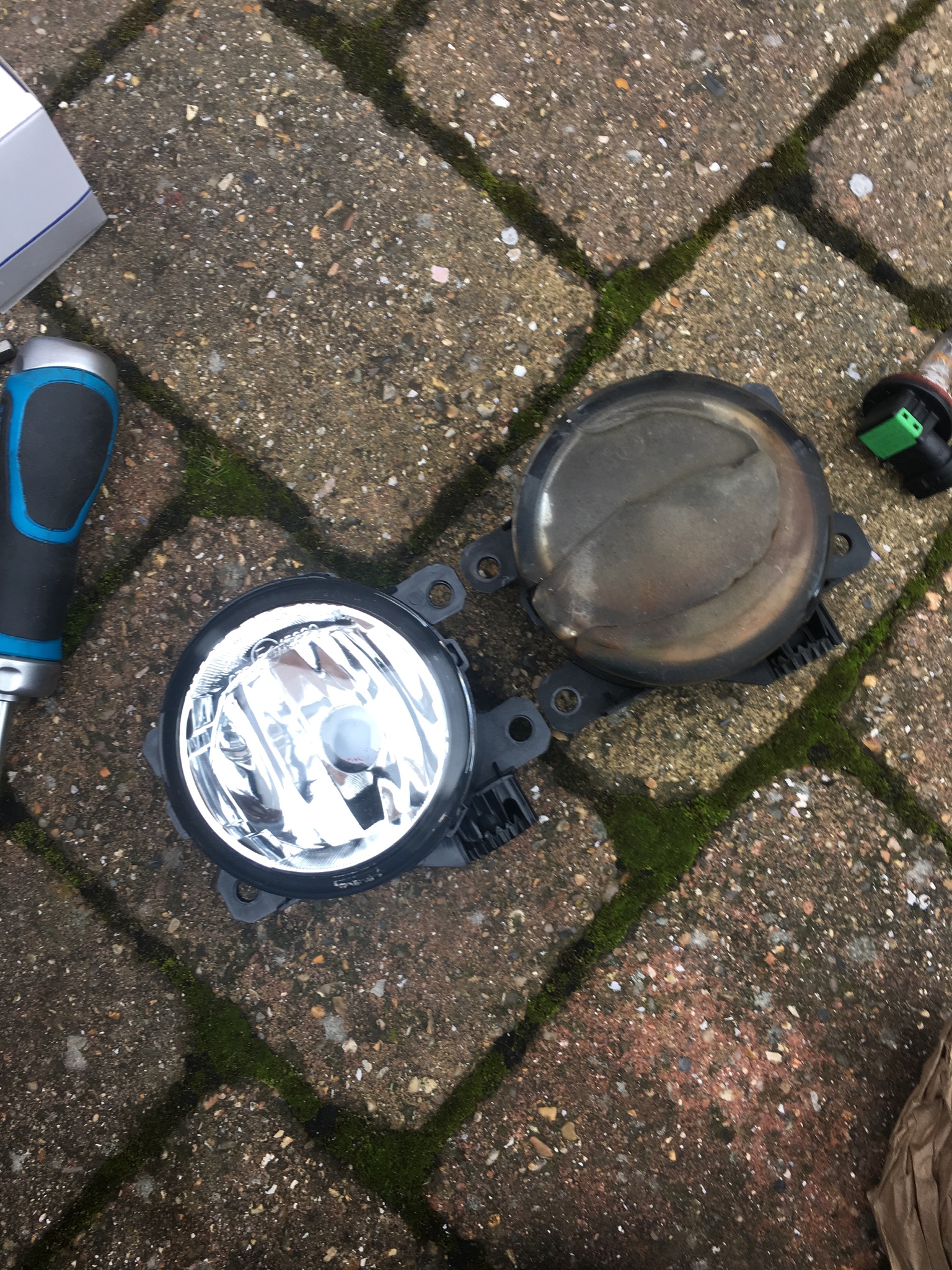

Finally got round to changing the very broken fog light yesterday.
New lamp, new bulb but still not working, confirmed the lamp bulb and part of the wiring tested by putting it on the other side. So am going to have to pull the car apart to track down the fault :confused:

Oh dear..
Is that a cornering lamp?
Yes it was.
Finally fixed it about 2 weeks ago, there is a separate relay for each cornering lamp not in the main fuse box. This relay has a long “skirt” on it to stop water getting in the connections on the bottom, except it had fallen off its bracket so was hanging and so the skirt turned into a bucket, and the internals of the relay turned into brown rusty water.
The problem is fiat want £40 for this fairly generic relay which is such as standard part usually used as a high speed fan relay on many other makes of car. I tracked one down on eBay for £13, but to make do I used an £8 lucas relay from my local automotive electronics specialist which did the same job perfectly.
