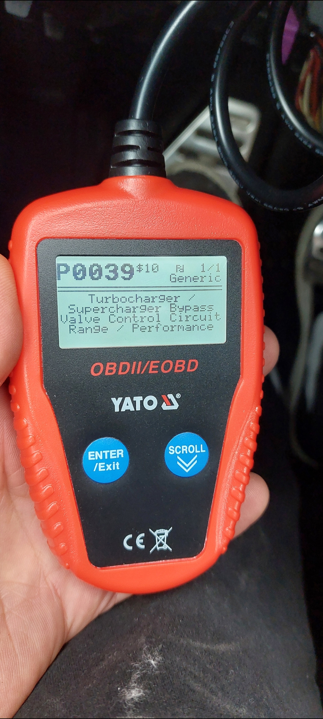

Today, I went back and engine fired up right away. Changed the fuel cap too. Then 5 min later, I had to reverse back due road closure, then in 2nd gear, with a sudden jerk, the engine cuts out again. I bought a not-cheap but simple OBD scanner, only one in my area, and the fault code mentioning Turbo Solenoid came up. I deleted as could've been an old code, but the car still didn't start, even after an hour wait. No more fault codes after that either.

-apart from the Turbo Solenoid code, no other codes shown, but it's a cheap scanner. I'm getting Multiecuscan, but order takes over a week.
