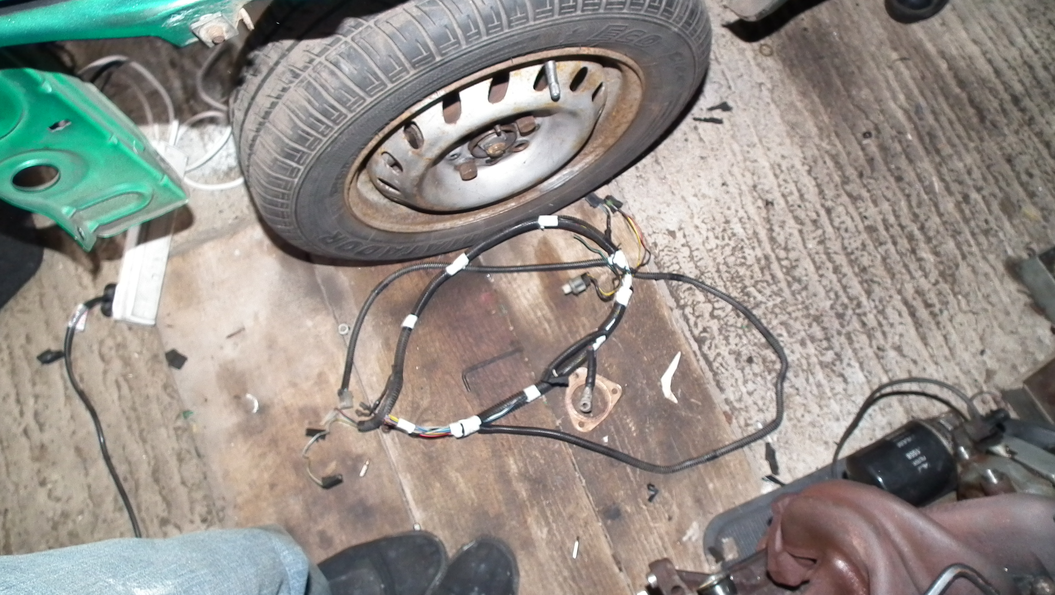

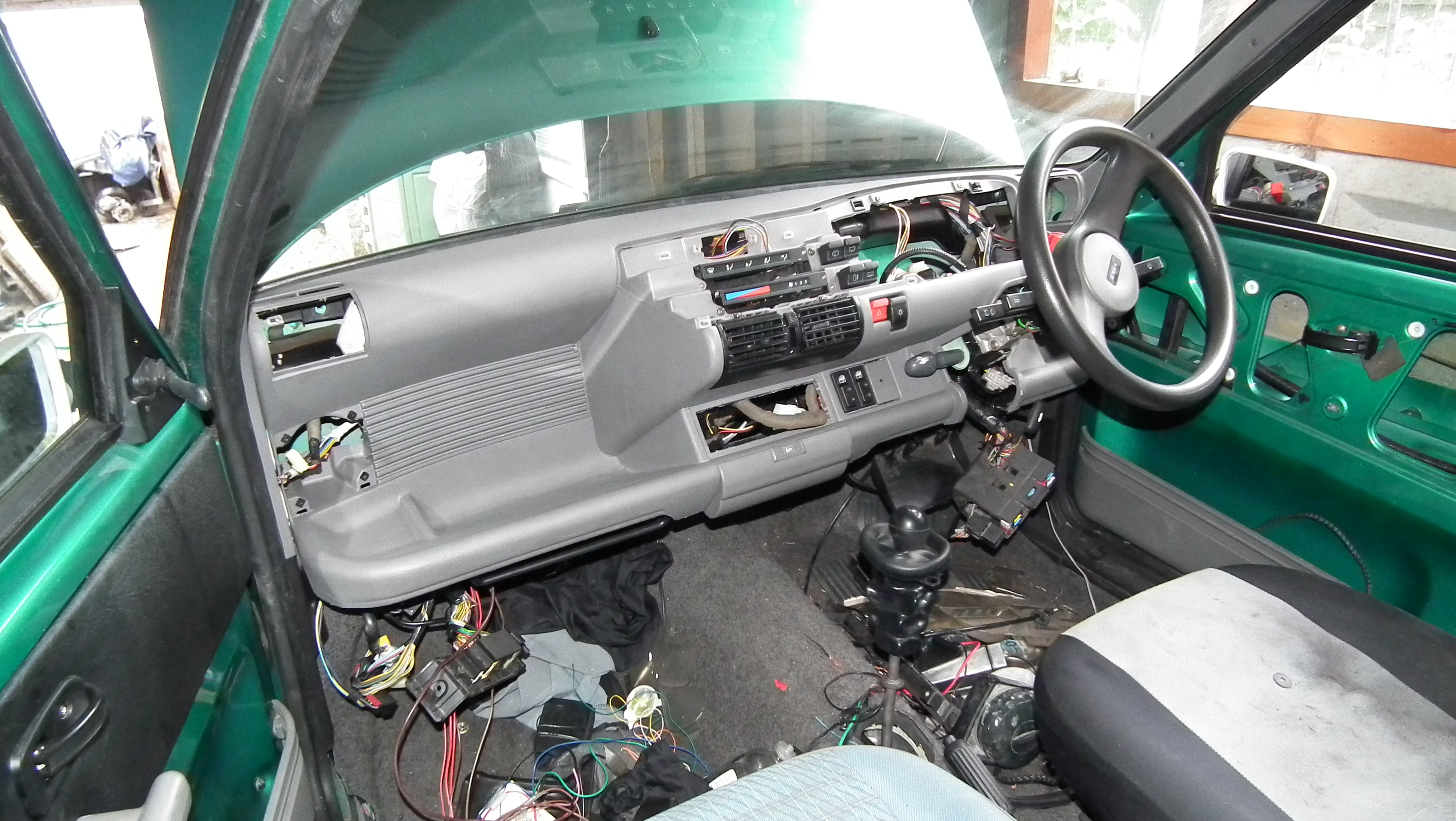

i previously owned a mk1 punto 60s but ive always wanted a cinq so after i purchased cinq i striped the punto down to bear chassis including engine and gearbox :D loom and so on ive been collecting parts for the 1.2 conversion for a while p75 cams full engine rebuild re skim using a big cnc machine from college :) cinq gearbox and mounts ect

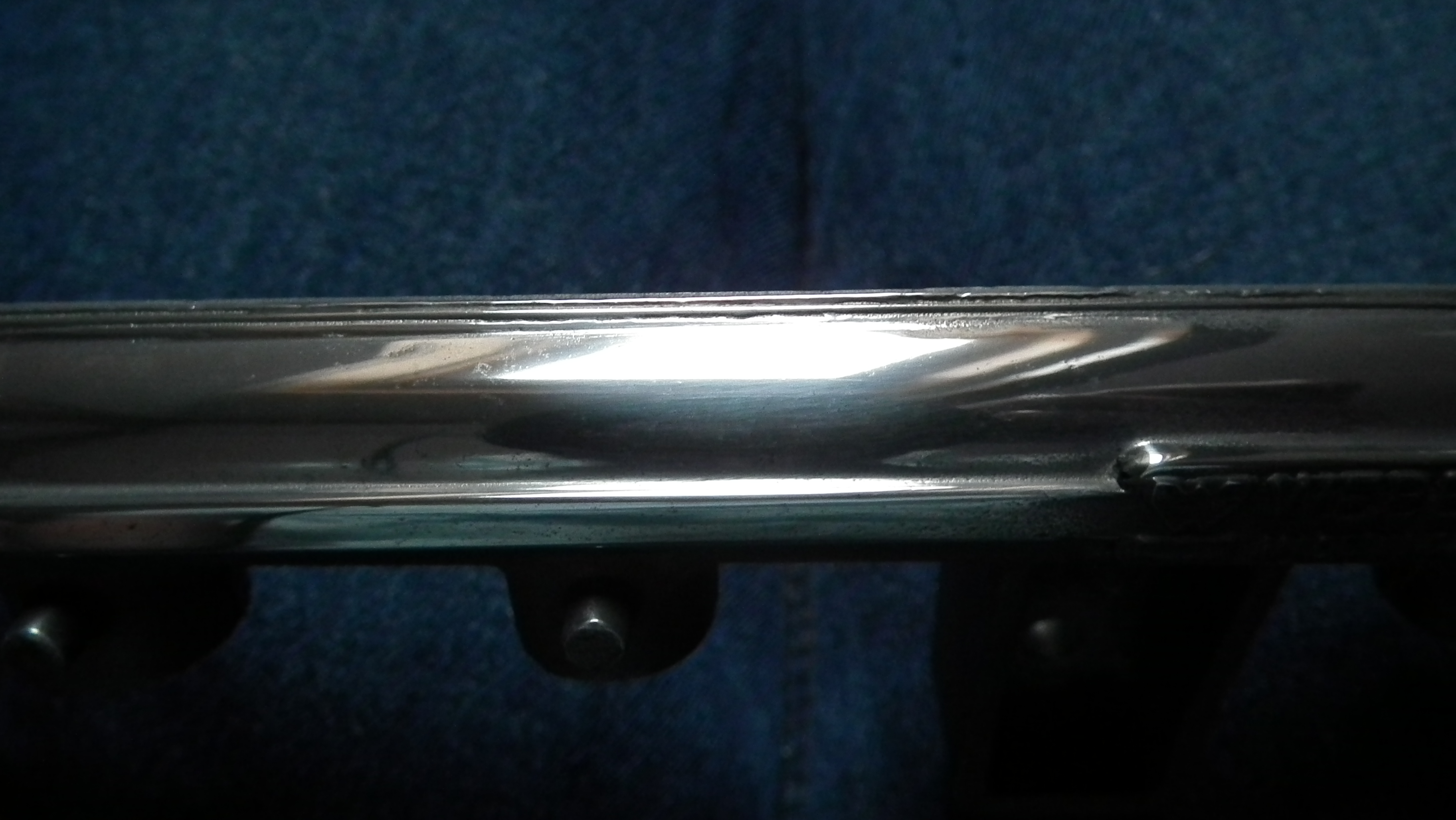

It's a tjet/abarth inlet manifold. Custom throttlebody spacer is needed to bolt on a cable throttlebody but that is no hard task.
Anyway, turbo + ITB's is going to cause no end of trouble. ITB's just aren't designed to cope, unless you go custom with a set of jenvy's.
Either way, read and look at what has already been done by others. Those ideas might look "too" simple, but that is for a good reason.

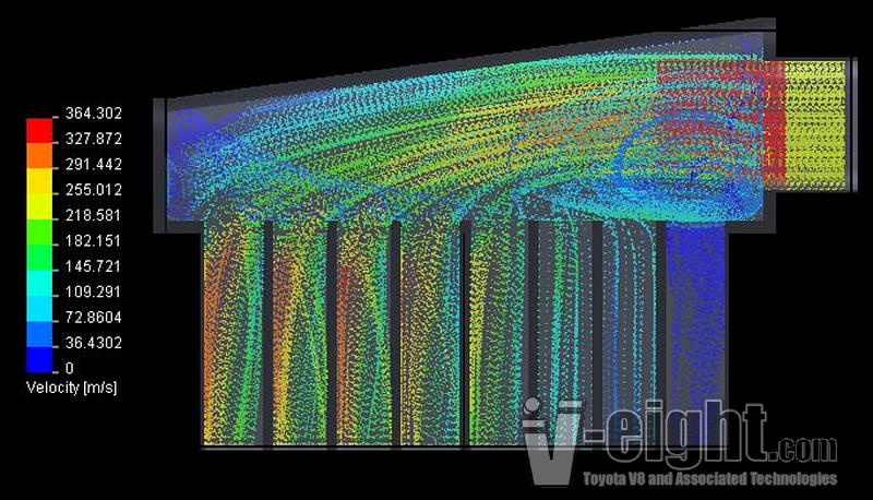

i will look into this nothing was final in decision and i'm after the best and most stable running engine and problems are a fun task to overcome also these intake plenums are inefficient in concerns with fluid dynamics one end of the intake will have a higher flow of air than the other unless that put in restrictive bafles
