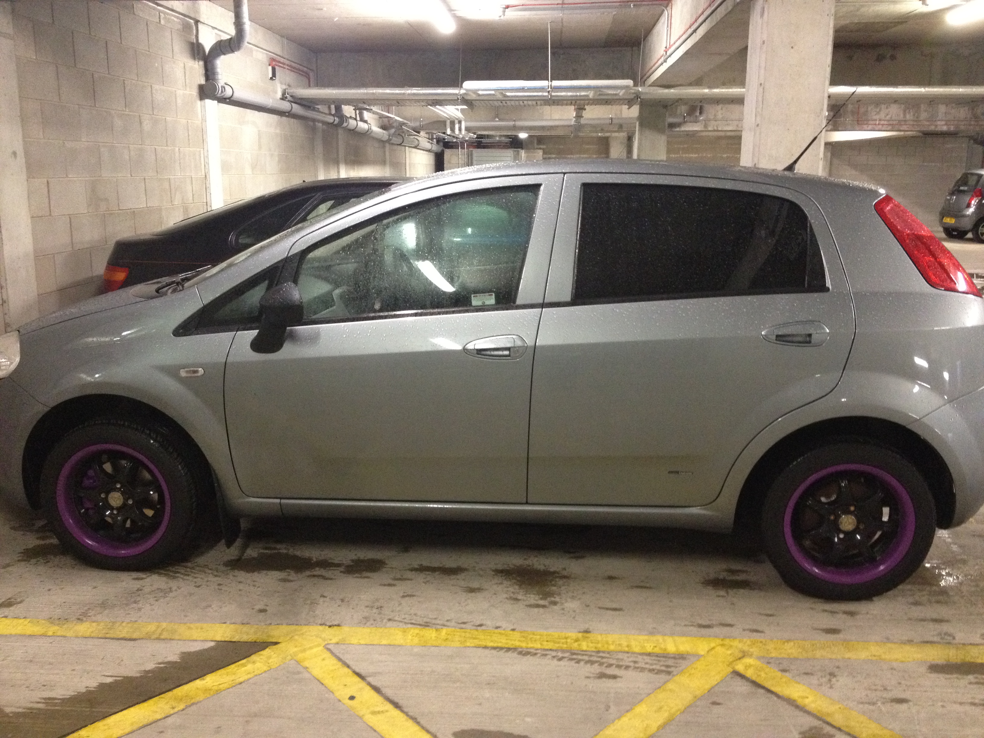

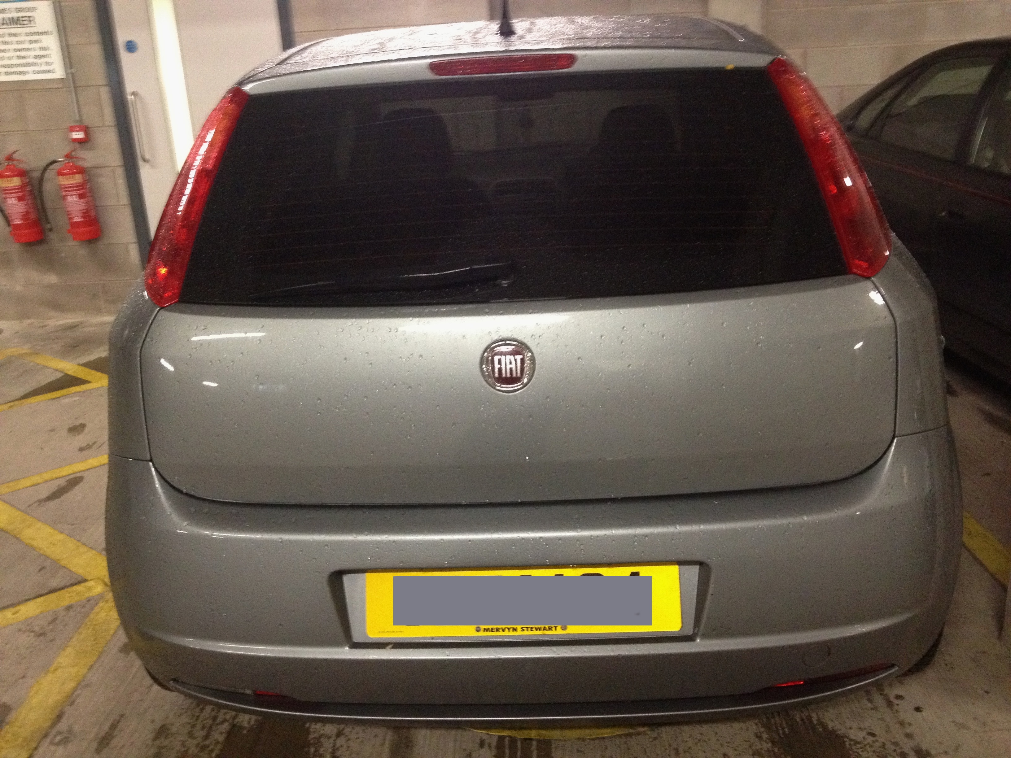

This is my 2 month old Grande Punto Design bought it in a dealer. Not really BRAND NEW, It's my first time driving a Grande Punto and to Fiat line. So here is few pics of it.
Current
Back window Tinted 25%
Brake Calliper Sprayed with pimp violet
De-punto'd
Change gear knob (Photos will be upload soon)
Sprayed door handle with car colour code
Xenon look headlights
:slayer:

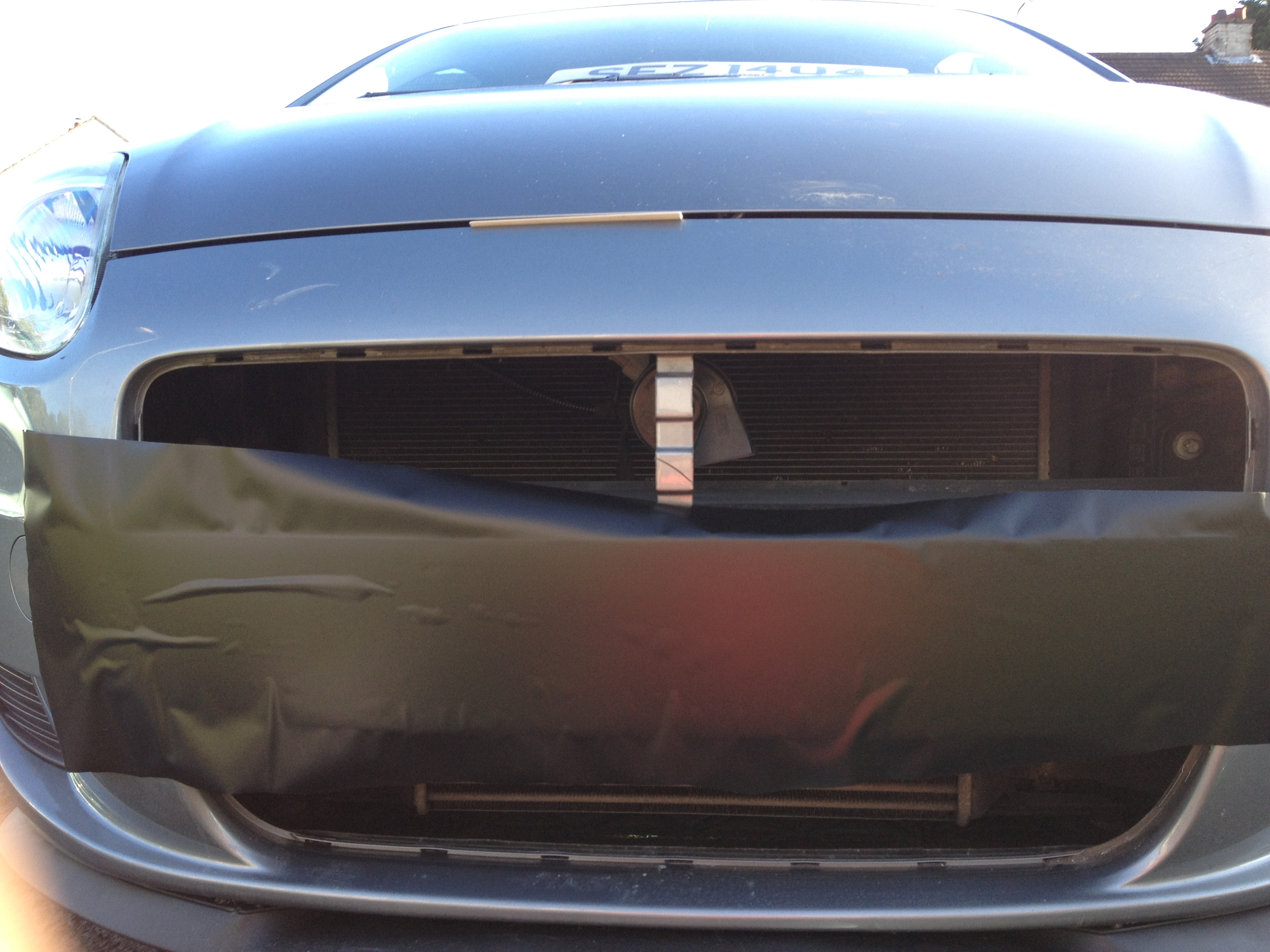

Front vinyl
Front grill debadge

Im trying to get 17 inch alloy with matte black spokes. I'm still trying to bid and will do for the next 48 hours. So far i got those 15 inch alloy wheel :cry: with pimp violet that surrounds it. BTW I'm trying to stick with my pimp violet theme for alloys just and callipers. :slayer:

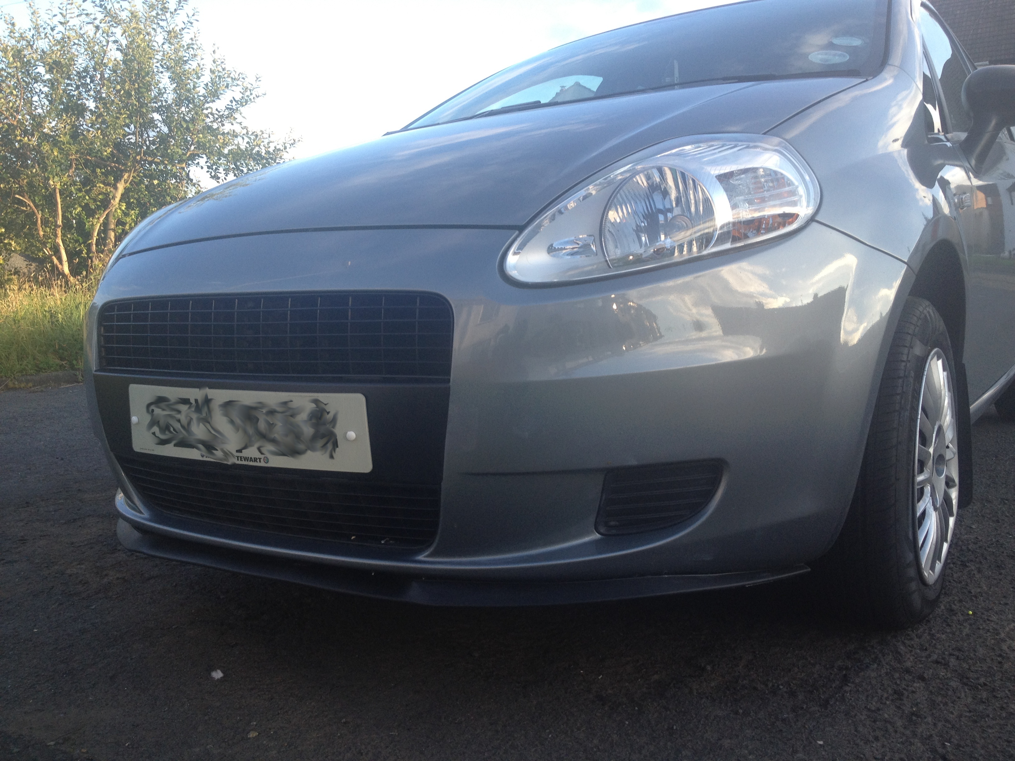

not much tbh got the debugged grill but haven't got any photos of it yet, the alloys is coming and would upload as soon as i got it, was hoping to get eibach sport line suspension but couldn't afford it just now due to me moving out the house, LOL
