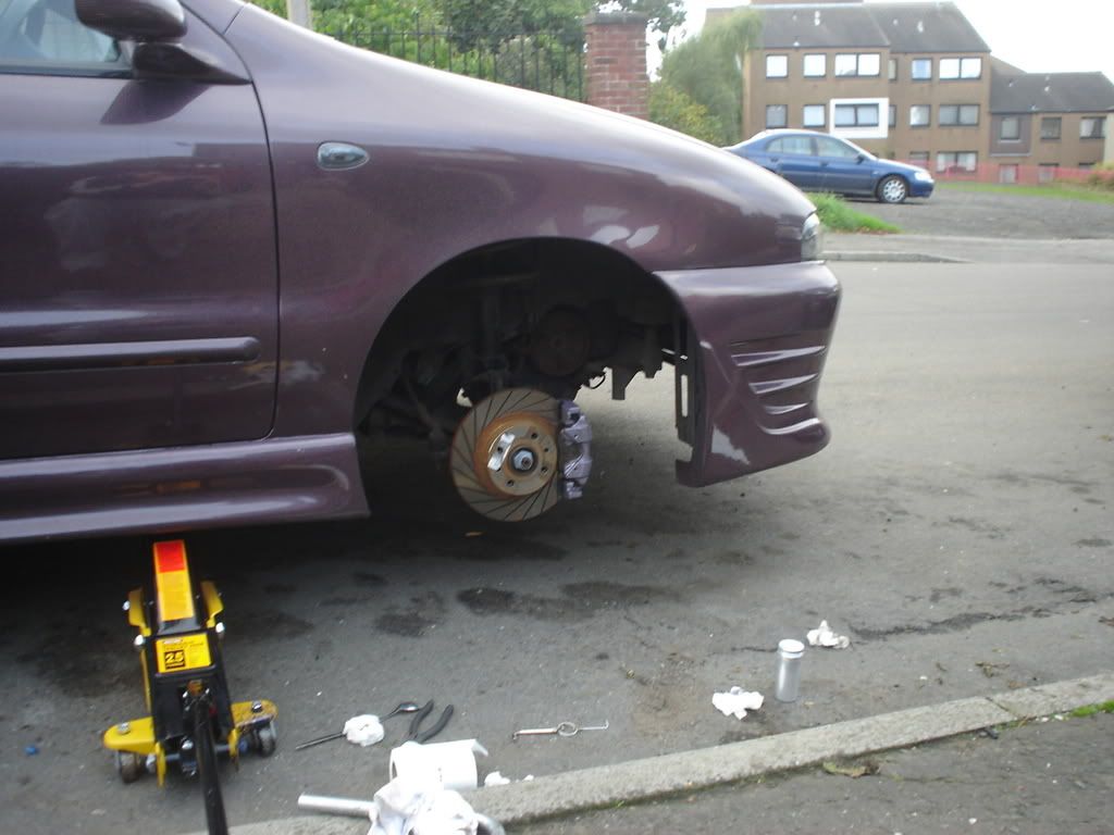

Step 1 - jacking the car and remove the wheel

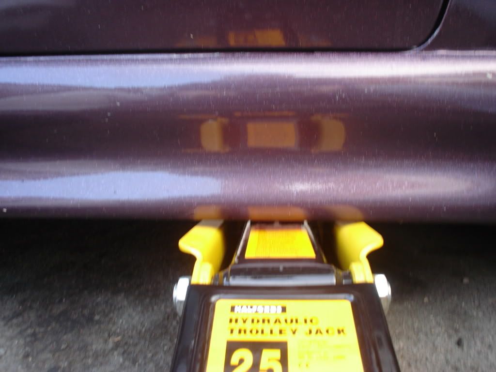

Notice how close the jack was to the skirts and almost poop myself
jacking the car

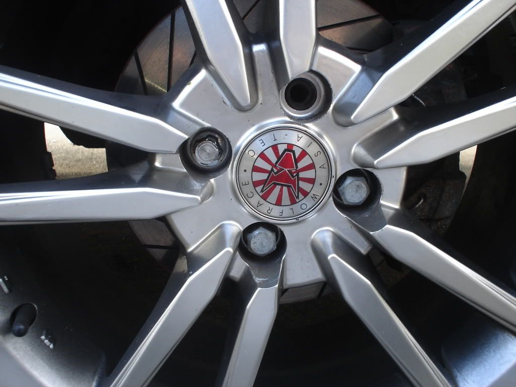

Removing the wheel

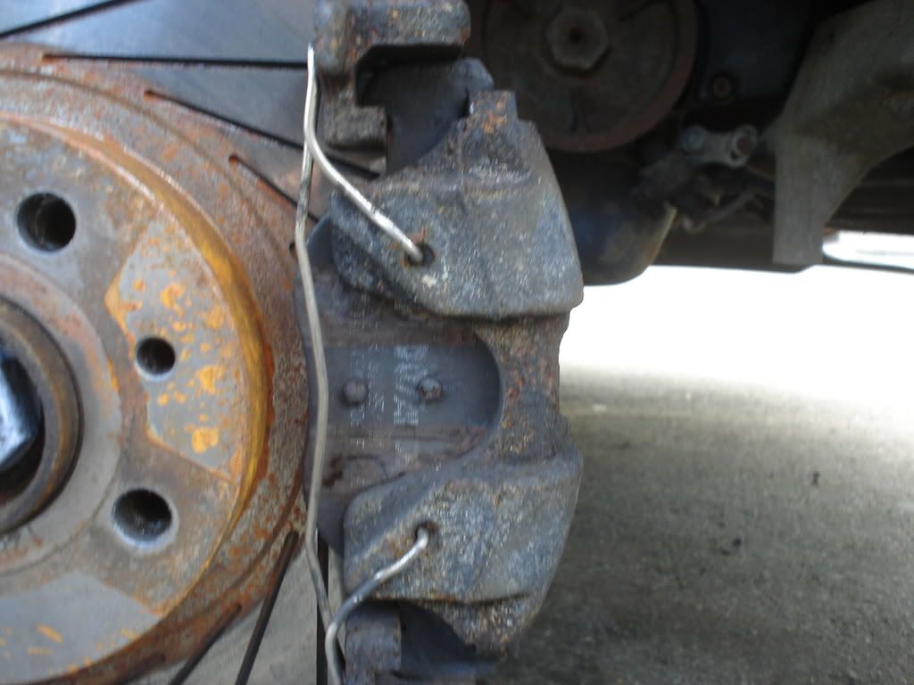

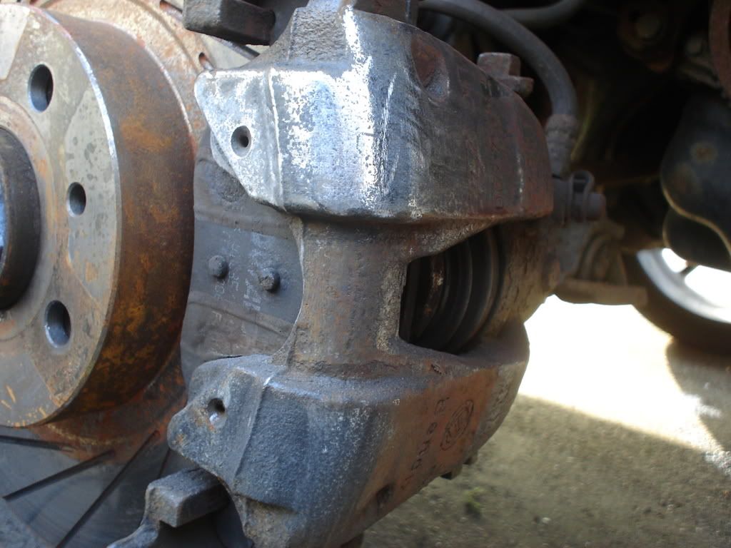

Notice how calipers look before hand

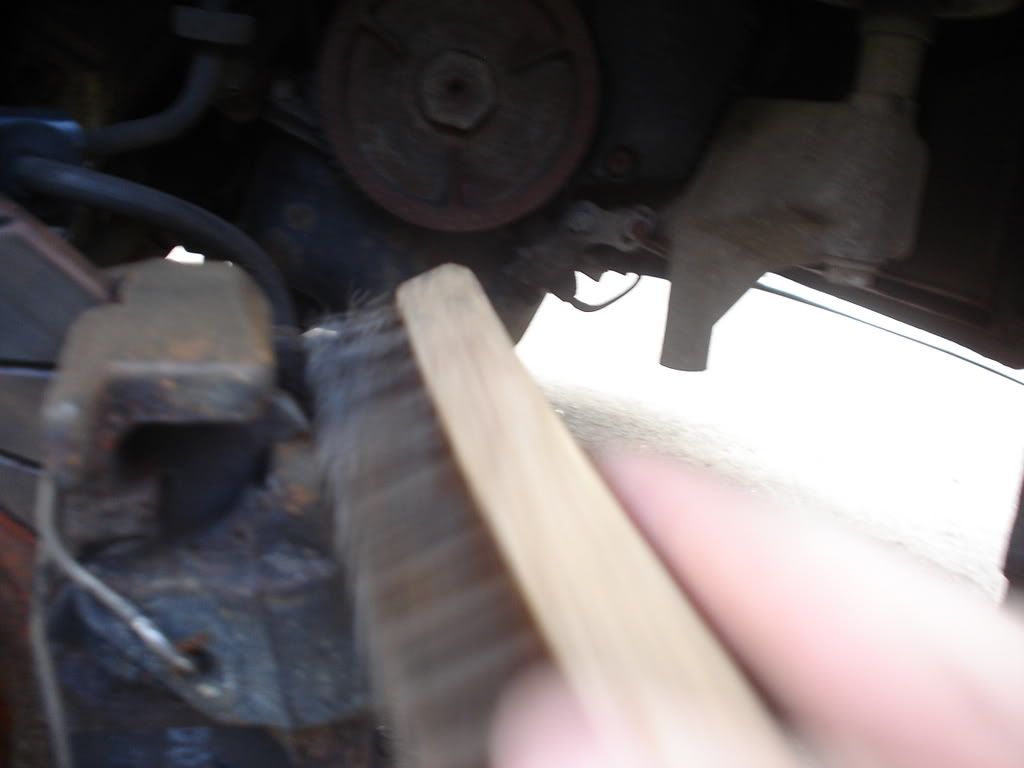

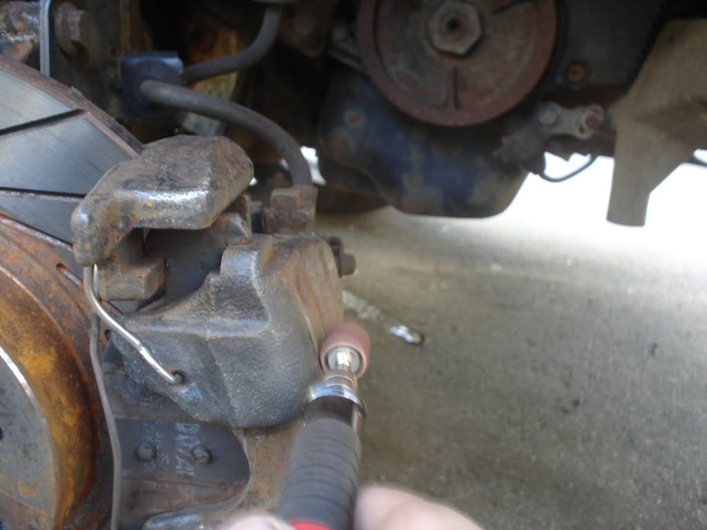

starting the prep using a hard steel bristle brush to remove big chunks of debree

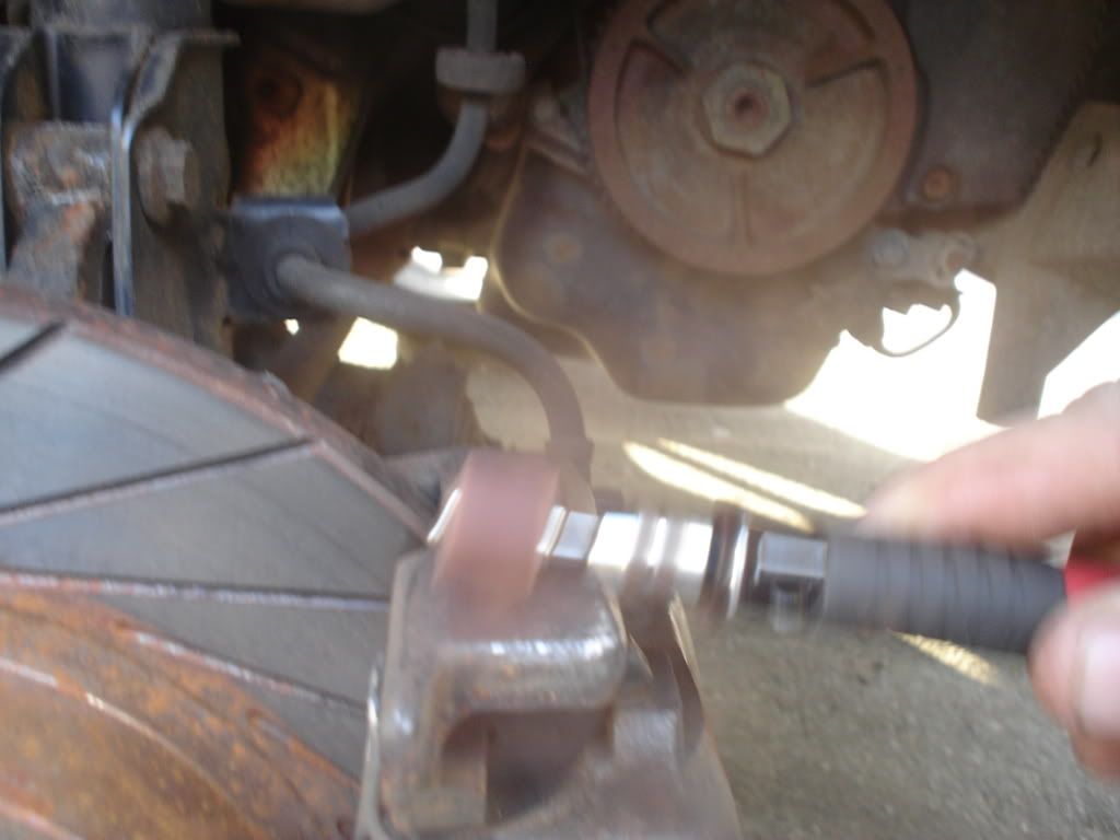

then moving onto a dremmel with a sanding attachment

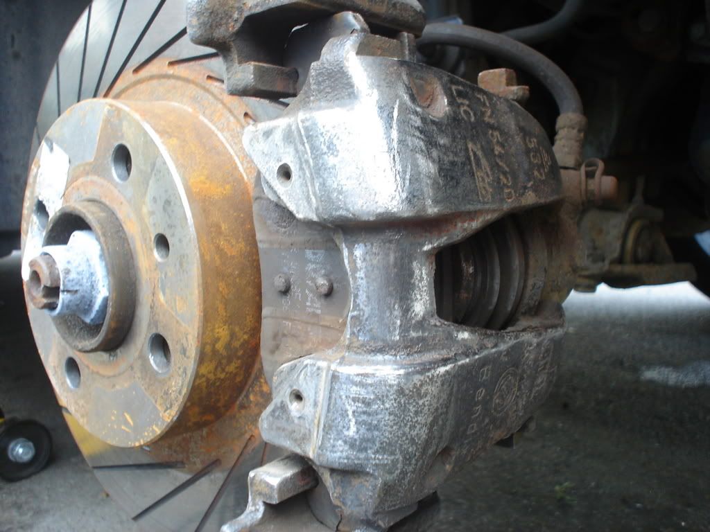

this next picture is with the dremmel after 5-10 minutes of work
notice how shiny the caliper is after about 25-30 mins of work the dremmel makes short work of it which would usualy take about 2 hours of hand work

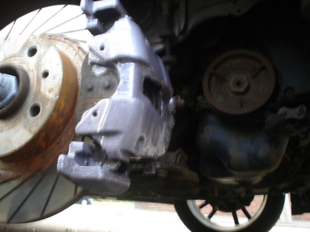

this is the easy part just take your time in nice even strokes with light strokes for the first coating of the caliper.
make sure your paint is mixed properly and is looking good
strap on some rubber gloves if you dont want to get paint all over yourself

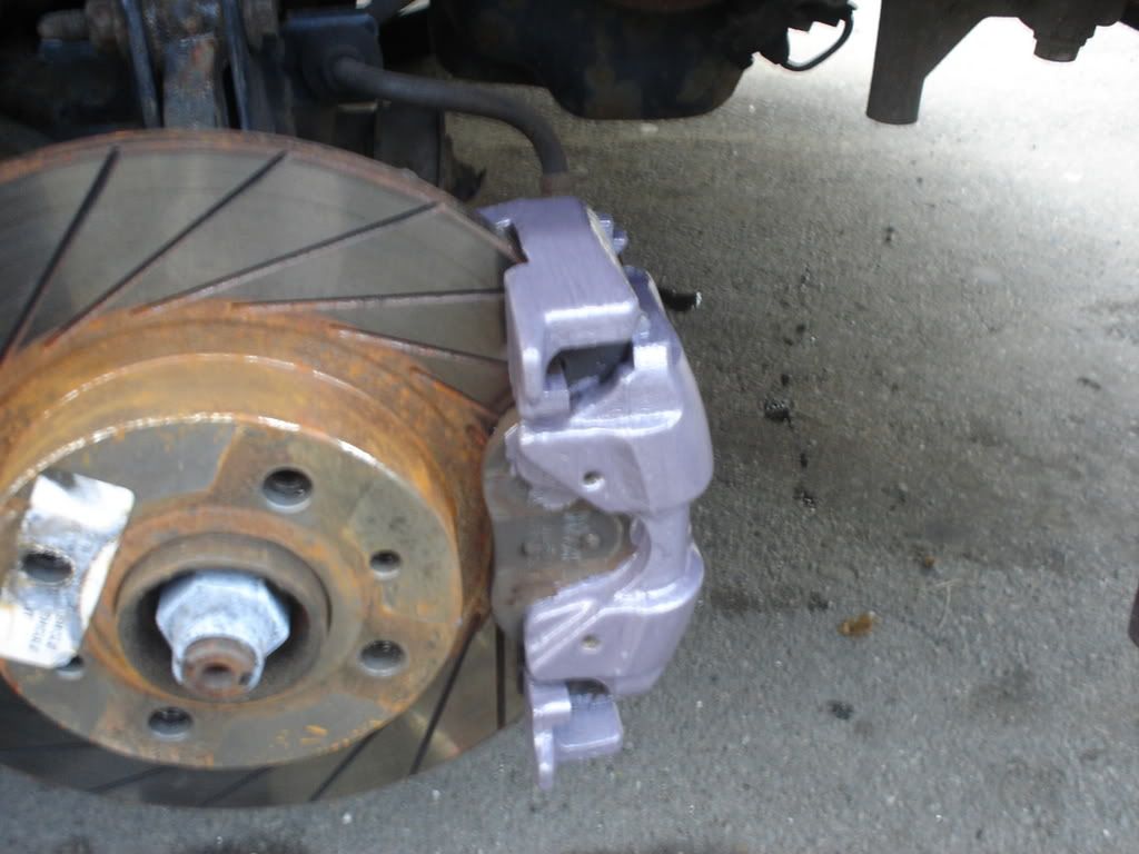

here is the finished fist coating of the caliper ill do another 1 maybe 2 coats to give a harder better appearance on the caliper and notice i didnt mask the brake pads as im changing them next month any way but make sure not to get paint on moving areas E.G. caliper piston the sliding rods at back of the caliper, brake disc and brake pads and just some genreal common sense on where not to go if you dont hink it should then dont do it
jacking the car
Removing the wheel
