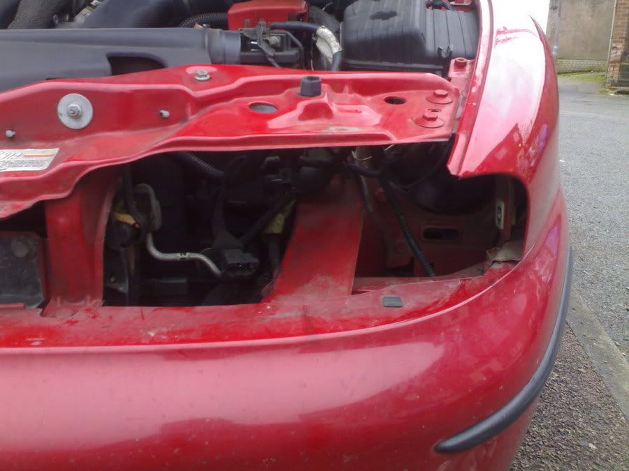

Ok.. i might with how i did it.. but not with the idea!!
I printed off the guide, followed it.. then realised it was wrong!
So I did it Tommy K style :) :)
1) Take 1 bravo
2) Remove the light
3) Spend 10mins removeing all the induction pipes, wires, battery waires and arse about with that stoopid plastic cover!
4) Find the Gray & Black wire identifyed in the fitting guide

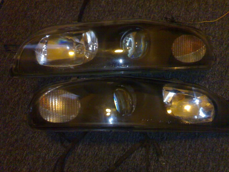

5) Take the side light outta 1 of ur newly purchased lights :) and give it a try
6) Find out its the wrong wire, tape it all back up.. and decide to do it Tommy K Style :)
7) Turn the side lights on.. keep sticking the wire in the plug untill it lights up, connect up to that wire by the plug :) (number 3 wire live "brown/yellow", number 1 earth)
8) Plug it all together and give it a try
9) Repeat process on the other side. 1st side took 30mins, 2nd side about 10mins :)

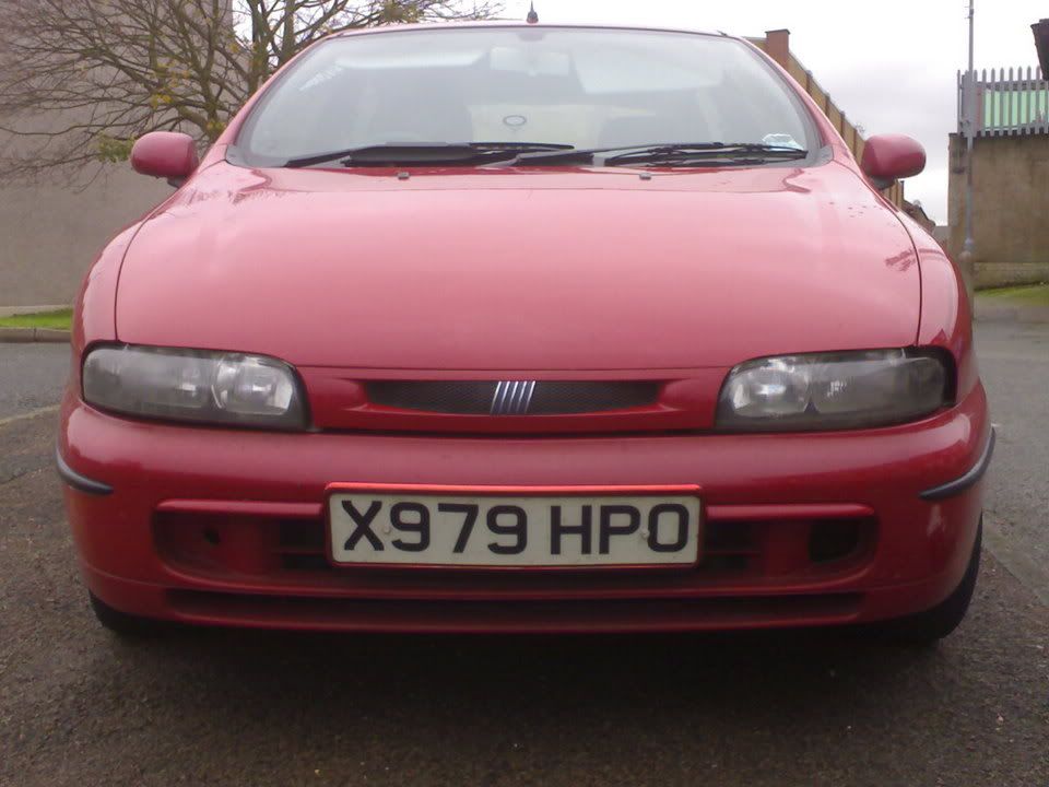

It took about 5 goes to get the hazard light to be on in that pic.. so admire it for awhile please!

Nice one mate, where did u get the lights from? are they easy to wire up?

The lights are great tho! just been out with them.. and they are much brighter than the normal ones.
Lights came from a loacal scrappy... when for a wheel hub... came back with lights £100 which didn't seem too bad?? :)

the lights are about the best mod there!

think you may have paid slightly too much for the lights imo, but you are happy which is the main thing, i paid 20 for mine btw... told the guy they were out of a bravo mind
