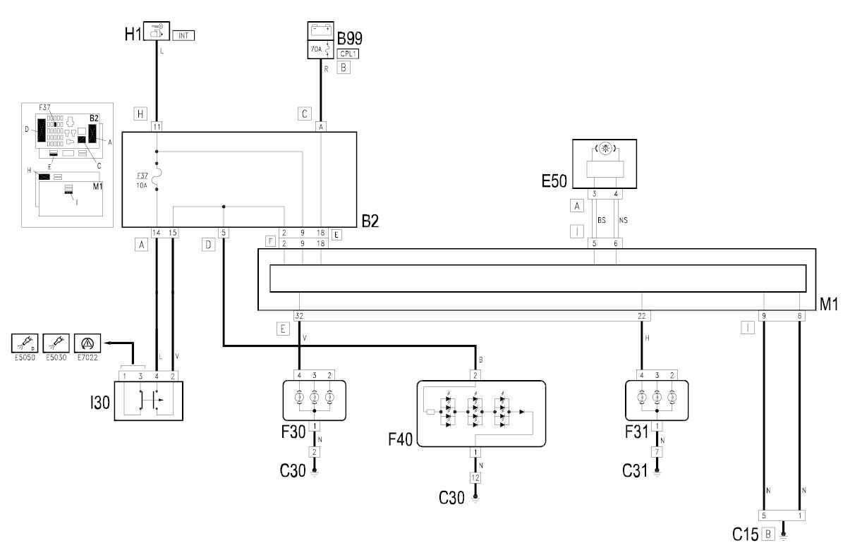

Wrong way round ;) The high level LED brake light is supplied from the switch through a link between pins A15 and D5 of the BC, the normal brake lights are supplied by the BC.
Have you checked the fuse? F37 in the dashboard fuse box?
