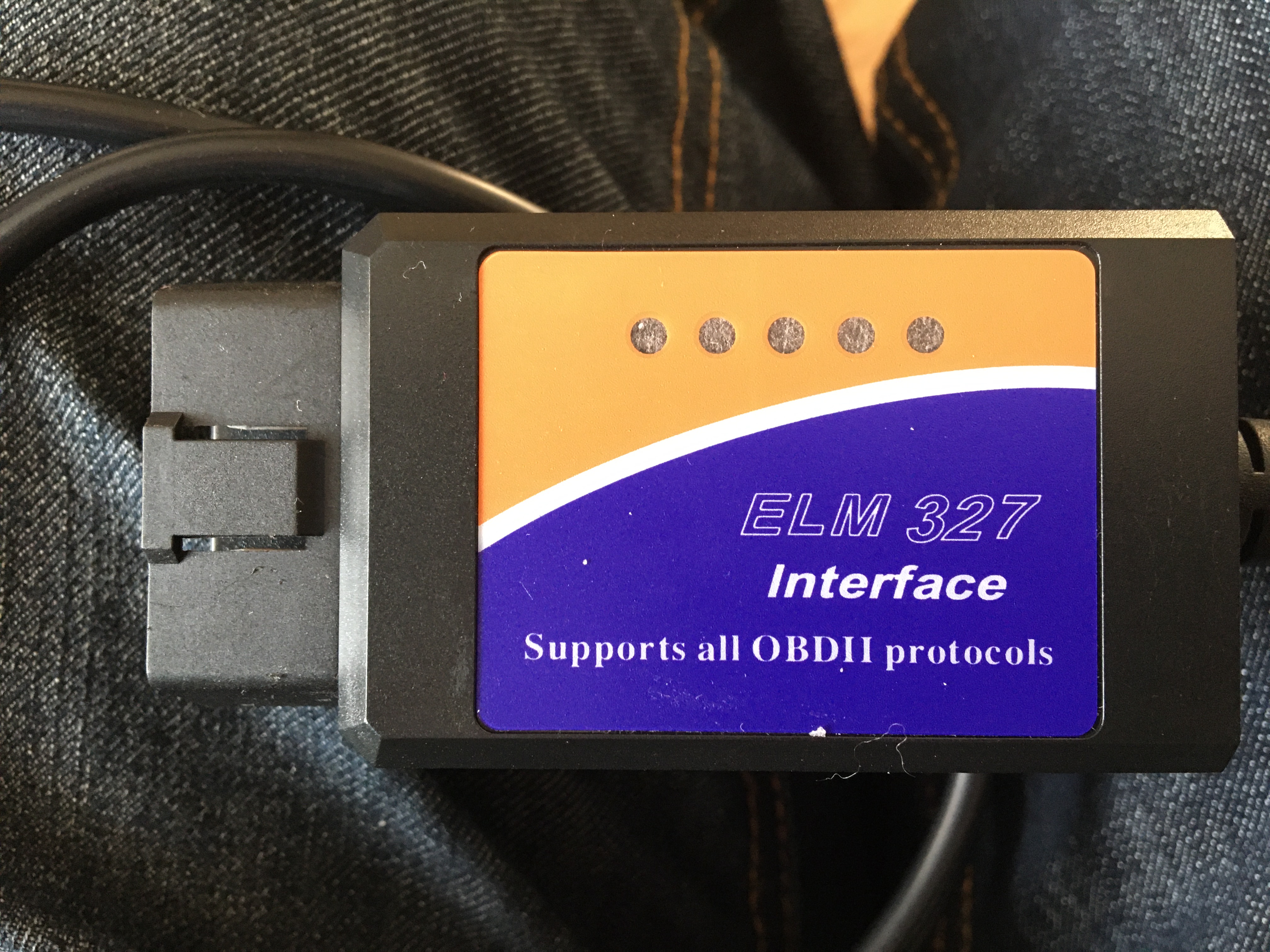

This is the lead he supplied me, it’s already modified and works great, it was about £15

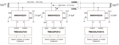

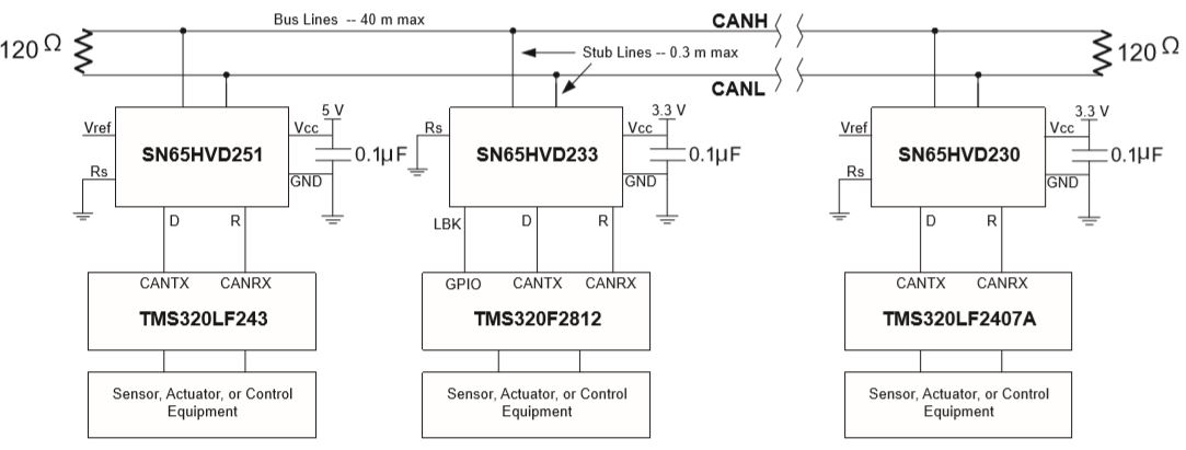

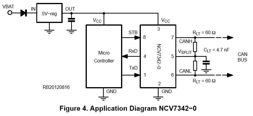

This is exactly the same interface that I have (got the 3 versions: USB, Wi-fi & BT) which I have modified myself (by removing 120 Ω resistor between pins 6 & 7 of CAN transceiver chip). Attached is a drawing of how it may also be terminated, and one that shows how a CAN bus should be terminated ...
BRs, Bernie

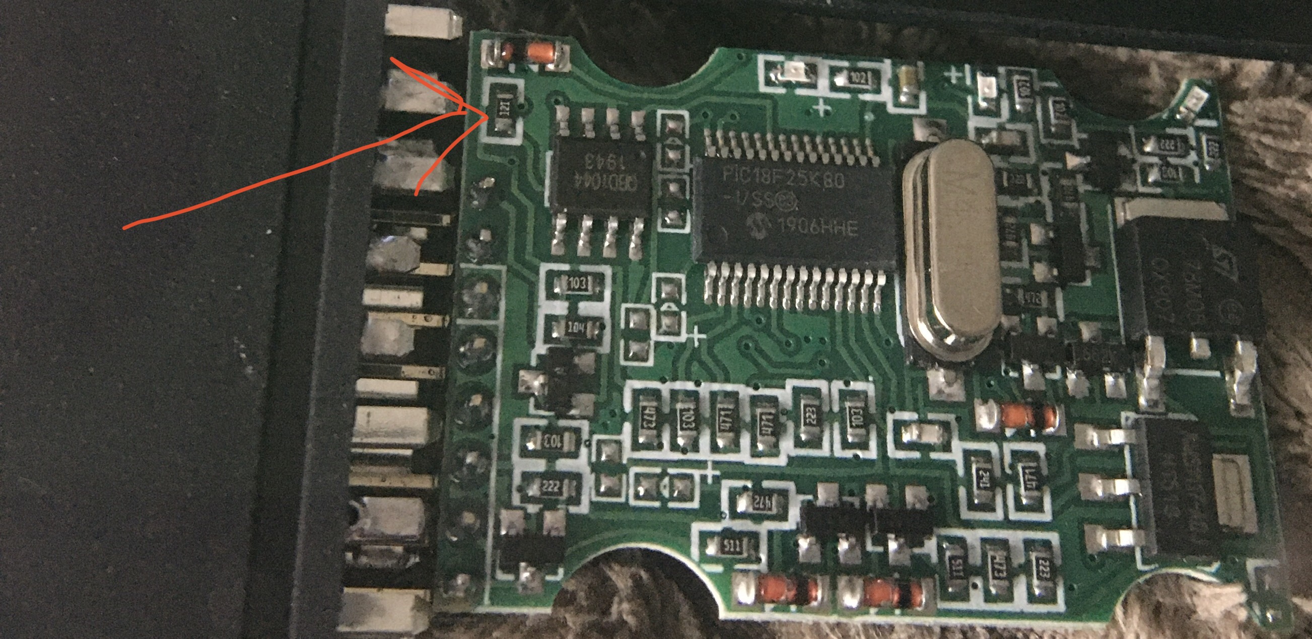

Hi Bernie, would you kindly point out what resister needs removing on the WiFi ELM327, there’s a red arrow going to the resister I think it is, is that correct?

Looks like it's the right one. Do check though if the track goes to pin 6 or 7 on the CAN transceiver chip AND to the PBD connector ... At least it has the correct value: 121 = 12 + 1 zero = 120 Ω
Any picture of the other side ?
Cheers, Bernie.

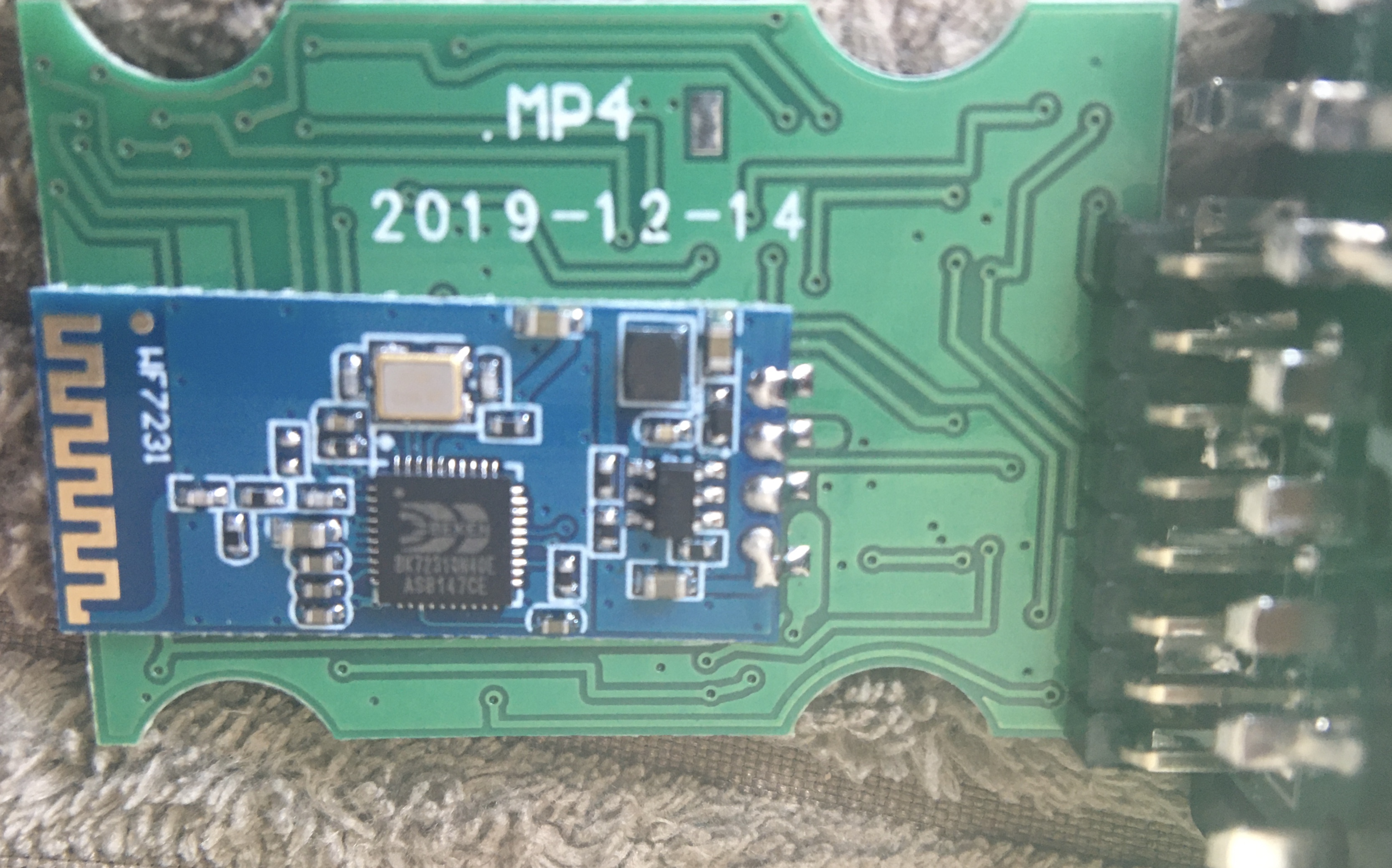

Not the best pic, phone struggles to focus with close up,

Hi Laurent, can't see much indeed !
The resistor to be removed (if present !!) is connected between pin 6&7 of the OBD transceiver chip AND on pins 6&14 (CAN L/H bus) of the OBD connector, so one leg, (or the trace it was solderd to before removal) must be O Ω with OBD pin 6 or 14. If so and the other leg has 0 Ω with the opposite pin, that is (was) the right resistor ...
BRs, Bernie
