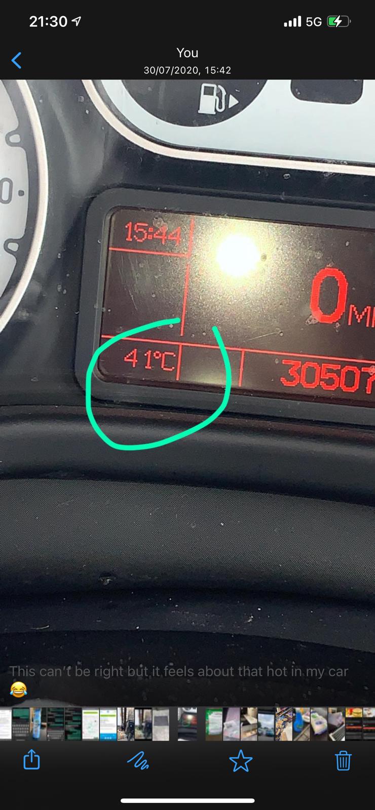

3. Error: City Brake Unavailable & Temperature Not Displaying
Occurred at approx Mileage: 30,500 (issues started to manifest)
Summary: At 30,500 miles, randomly it told me the temperature was 41 Celsius. It was half of this. Temperature inaccuracies have continued.
At 38,000 miles, temperature stopped displaying and is just _ _ _ on screen. The City Brake Unavailable error came up at the same time.

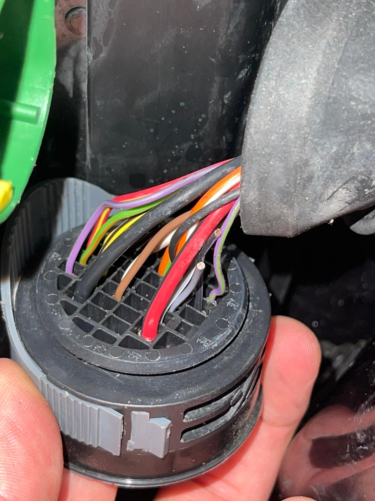

I also noted I cannot adjust the passenger wing mirror with the dial on the driver door since this occurred.
Note: Pics attached, two wires connecting to the door have split (passenger side). I suspect it may be related? Any ideas what these two wires control specifically that are split?
Please help
I can see the broken cables, how best to fix? I am worried if I strip them and try to join, they may be fragile and break more. Also suspect the issues may be related in some fashion. I spoke to fiat and just for the door they quoted me a whole new unit for 1.5 to 2.5k!

Hi :)
Your temp sensor wiring is going to a mirror.. look for a dimple at the bottom of the mirror?
A quick patch.up of the broken wires will at least let you know if the temp. And mirror control are restored.
I am unsure of the Citybrake
But it is possible that an 'incomplete electrical circuit' could disable it
Repairing my broken wiring ( on a punto..) restored a LOT of functions.. a productive 30 minutes

Hey just a quick one, the wire that does the window on the passenger side I noticed was also loose and I managed to “slot it back in” to the connection box and it works again. If I wanted to the replace the passenger door loom wiring entirely, how hard of a job is it?
I posted on a couple of website for quotes like one of the sites you sort of get a few garages who reply and nobody came back which makes me think is this something only Fiat can do?
Any tips on how best to get this done? OR is it an easy job such as remove the glove box and just connect it to some places?
Hi there. Well firstly you must sort out the broken wiring as this may well be the entire cause of the problems. Stop start does have some temperature input via the ECU. It will not work until the engine is warmed up so loss of signal is possibly linked.
Soldering is easy with an electric soldering iron and you can buy shrink wrap ay halfords for a few pounds. STart by repairing and see what happens then.
