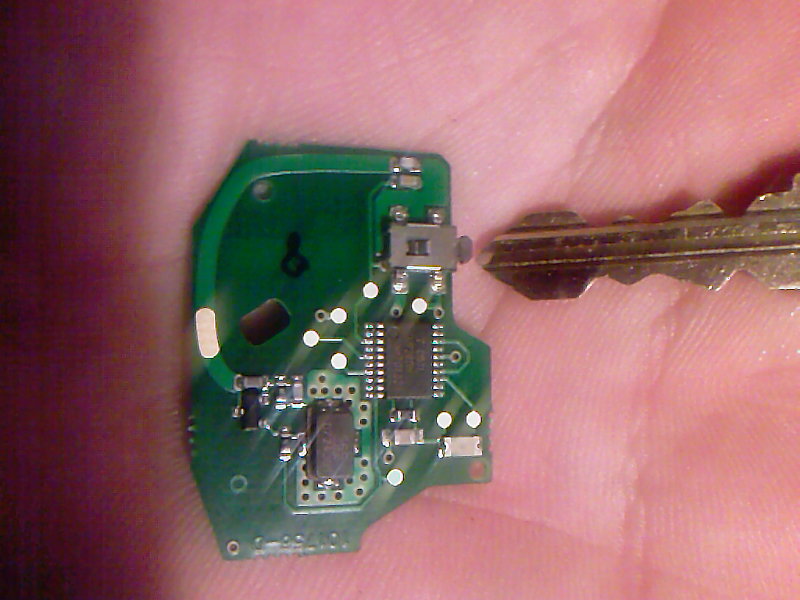

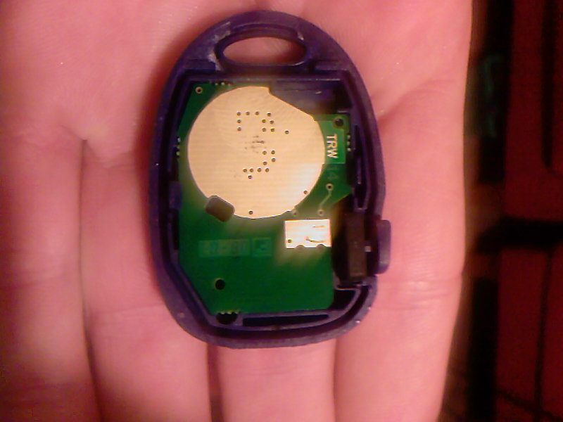

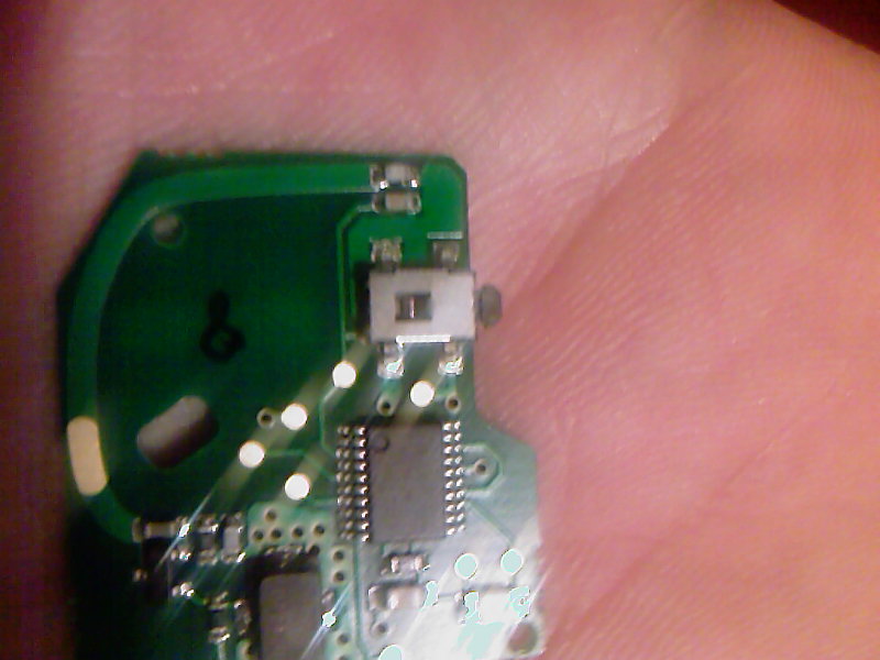

Ok. Camera phones are a wonderful thing. Here are some pictures of the key internals.
1. Simply the pcb in the key.
2. The tip of the key is pointing at the silver microswitch attached to the pcb. This is operated by the plunger that you press on the key.
3. In the next picture I have tried to take a closer up picture of the microswitch. It is this microswitch that detaches and needs four blobs of solder to reattach.
I hope this all works as this is the only key I have for my new car at the moment! The key simply prises apart, there is even a slot to put your knife in to ease it apart.

Great post PandaBloke. I repaired both of mine this way a year or more ago and they've worked fine ever since. Curiously, by being a bit dithery with the soldering iron the fist time, I managed to dislodge and lose one of the two small components (which I suspect are resistors) that you can see at the top in your close-up. But the key still worked perfectly well without it, so not quite sure what it was there for!
Here's a handy hint for those where the switch breaks and the car is locked -- and what I did in a supermarket car park when my key stopped working. Pull apart as in Pandabloke's post and pop the circuit board out and turn it over to look like the photos above. Now, carefully 'short out' (ie connect together) the two tiny contacts on the side of the switch nearest the top in those photos (you can use the end of the key, or a paper clip, or even the pin from a name badge!). This will unlock the car and turn off the alarm.

That's true the micro switch is mounted by four soldered pads and the pressure from pushing on the button causes one or two to shear. A careful dab with a fine point soldering iron will rectify this if the switch is still in one piece, otherwise a replacement can be purchased from one of the electronic component factors, NOT FIAT.

Yes, it's a CR2032 battery. The battery should be fitted with its 'outer' (normally the side with the writing on it) away from the PCB. Check that the sprung contact behind the battery and the large contact area on the PCB (that the battery touches) are clean. A gentle rub of both with a pan scourer will do this nicely.
