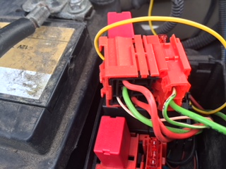

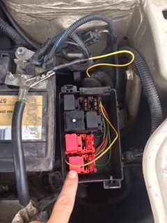

ADDITION TO: Multipla JTD - code sys failure / problem with relay
I've added 2 photo's of the relay that is malfunctioning:
Photo01 shows the location of the relay. The yellow wire is the temporary extra minus/zoro to feed the relay directly from the minus/zero of the battery so the relay is permanent on.
Photo02 shows the wires to the relay. Below mid the in red the permanent plus. Below left the thinner yellowish-white wire that I suppose is used to switch zero/minus to the relay.

Looks like you could do with a wiring diagram. I'm not sure if there's one on ePER, but might be worth a look. Other than that, it might perhaps be worth posting the question on the Polish Multipla forum. There are guys there with far greater knowledge of it than you'll find on FF
