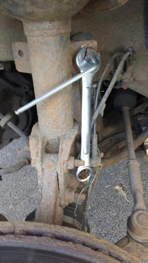

The plan today was to replace the suspension components on the NS: wishbone, ARB bush and drop link. Only got 1 out of 3 done. Here's why...
After jacking up the wheel hub to take the load off the drop link, I removed the drop link top nut in only 10 mins with my nut splitter. The drop link bottom nut took 2 hours 20 mins! I was too knackered afterwards to face the wishbone and ARB.
Why the big difference between the drop link top and bottom nut?
- The top nut is in plain sight, facing you, with no obstructions to removal, and solidly attached to the strut.
- The bottom nut is hidden behind the end of the ARB, removal is obstructed by the driveshaft, wishbone and ARB, and it's attached to the end of the ARB which bounces around as soon as you apply any force to the drop link nut.
In addition, for anyone considering using a nut splitter to remove the drop link nuts (mine's a standard model as far as I can tell), the chisel component of the nut splitter is *circular* in cross-section, with a slot running down one side and a (tiny) grub screw projecting into the slot to prevent the chisel rotating when cutting into the nut. Due to the high force applied to the tool to split the nut, the grub screw on mine first *unscrewed* allowing the chisel to rotate - at 45 or 90 degrees away from the desired angle of cut (ie. at a right angle to the plane of the nut being split), and then the grub screw failed completely - trying to screw in the grub screw (with a tiny Allen key) just made the grub screw spin round and round without moving into the chisel slot.
Also the chisel end appears to have blunted after about 6 nut splits. I reckon you can buy a similar nut splitter for about £8, so if you can use it to do 3 drop links its still a helluva lot cheaper than 3 x 30 mins labour at a garage. In my experience these nut splitters *do* work, but be aware they appear to have a quite limited life.
The nut splitter could be easily improved with: A *rectangular cross-section* chisel end which can't spin round in use, which would simultaneously remove the need for a (pathetically tiny) grub screw to stop the chisel turning.
With my drop link bottom nut the chisel end rotated to 45 degrees, then the blunt chisel stopped cutting into the nut. Nearly 2.5 hours later and with every trick tried I got the f'ing nut off. Small consolation, but knackered and successful is better than knackered and failure!
Drop link nut removal pics below...
The top nut came off easy after splitting the nut on 2 opposite sides.
The bottom nut - after butchering with the nut splitter, hack-sawing to no avail, I levered the drop link down to stop the ball joint bolt turning, then slowly unscrewed the knackered nut with some pliers.
This was a cheaper drop link so no 17mm flats on the ball joint to aid undoing. Worth paying a few extra quid to buy better quality drop links with the flats (which I have on my new drop links).
