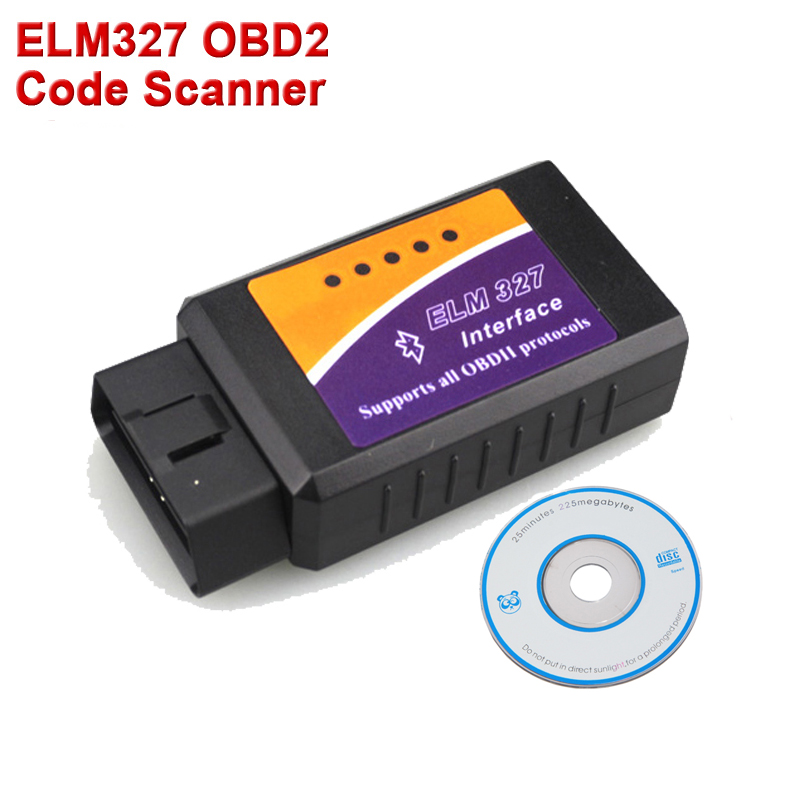

I'd really like to hear if anyone has a good recommendation for a reliable OBD2 interface to use MES.
I've just had a failed crankshaft sensor (fault code P0335) on my Panda, now fixed. I wanted to see if I could diagnose it myself but failed miserably as the only interface I could get at short notice in rural Ireland was a useless cheapo eBay special Bluetooth ELM 327 like this one:

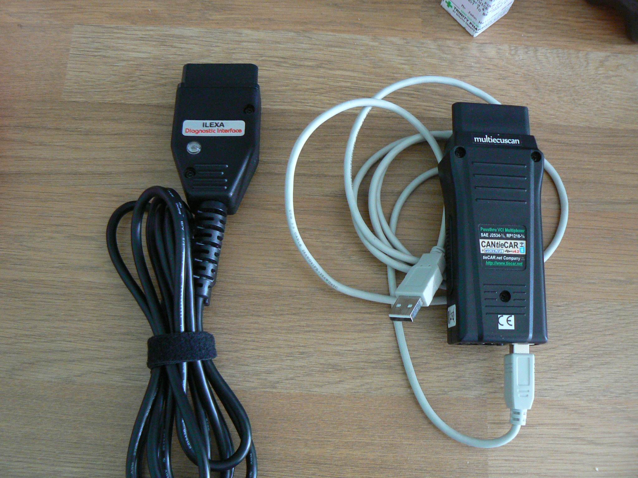

Bought VCDS (VAG-COM when I bought it) for "talking" to my VAG vehicles and it connects with just one interface. So I got used to simply plugging in and doing a whole vehicle scan before starting work on servicing etc and it scans all available modules in one go. I like doing this because it gives me a "known" staring point but also because if a fault code gets posted when I rescan on completion I can be fairly sure it's been something I've been "fiddling" with which has set it.
So when I started considering MES for my Fiats I was a little put off by the multiplicity of leads required to do a whole vehicle scan. However then I discovered the multiplexed interface and, although quite expensive, decided to go with it. My pocket is a little lighter but I love the versatility of it and the fact i can quickly access anything that MES is capable of looking at.
I bought the VCDS from Ilexa down in Truro but he doesn't do the MES so I had to look for another source and saw a lot of good reports about Gendan. I must have rung them at least half a dozen times with "silly" questions and was always met with informative and enthusiastic responses. In the end I bought from them and then had problems getting the interface to "speak" to the MES program in my laptop. Lots of help from both forum members and Grant at Gendan soon had me firing on all cylinders though.
I like hard wired connections for security of the link and speed - Here are my two interfaces
The VCDS is quite old now and I suspect I might benefit from a newer version but I'm concerned about all this manufacturer security gateway nonsense that's on the go just now so I'm putting off any expensive updating until i see how it's all going to pan out for "driveway grease monkeys" like us.

I’ve got a good one and a cheap one and they both seem to work ok.
I did get those leads as suggested & a cheap set on eBay and both sets work fine!
Huh. Interesting. Maybe it's a bit of a lottery with the cheap ones then. And I lost:p
Of course, I can't rule out user error. But I spent aaages installing different drivers at ftdichip.com, adjusting the COM5 bit rate and buffer settings.
My ELM 327 is discoverable as a bluetooth device on my Win10 laptop and android phone, but won't connect to ECU:( As well as MES I've tried the Car Scanner and Torque (Lite) apps. I also prefer hard wired connections. Maybe cables are the way to go.

I only tried the apps on my phone because I couldn't get MES to read the ECU with my OBD2 interface, and I wanted to check if it was a software or hardware issue. I'll stick to MES if I can get it working.

I think it would be wrong to say the Gendan supplied CANtieCAR interface was "reluctant" to connect with MES. The problem was with me and my pathetic computer skills - or lack thereof!
It quite caught me out because the VCDS (or VAG-COM as it was called when I bought it) all came in a box with a disc to load the program. Installation was childishly simple and the interface communication (USB) was selected on a simple sub screen of the program which you selected and then "tested" and it then worked "plug and play" as they say (anyone know who "they" are by the way?) All I can say is to read the installation instructions very carefully (I found that, on rereading, I'd not actually done some of the "stuff" right) My Gendan purchase had a couple of pretty good sheets of installation instructions which I skimmed through in my excitement and that gave me problems but, as I've said before, between Grant at Gendan and the good folks on here, I had the whole sorry, largely self made, mess sorted out within about 24 hours and it's worked perfectly ever since.
