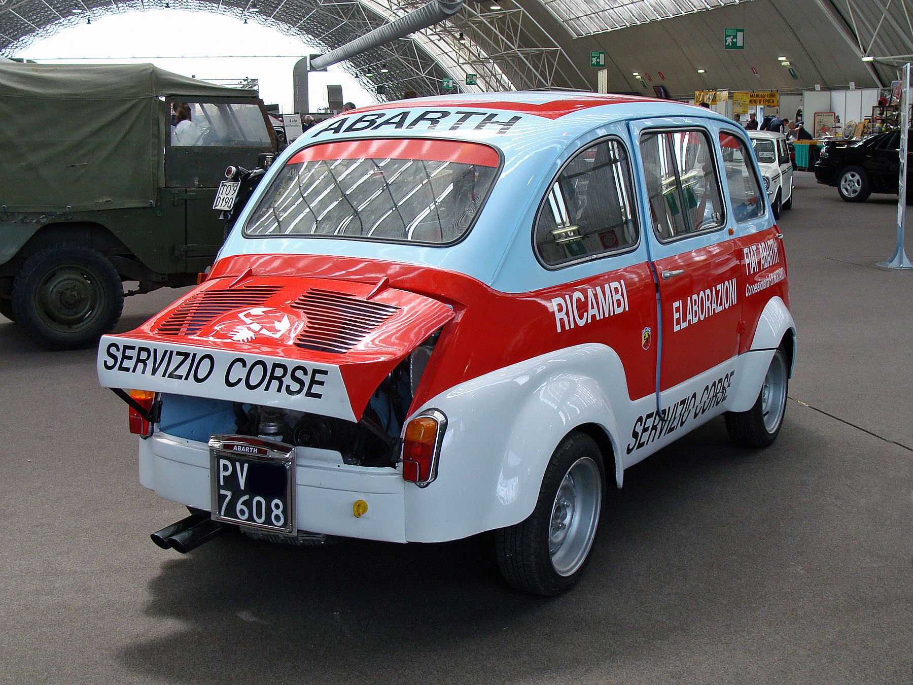

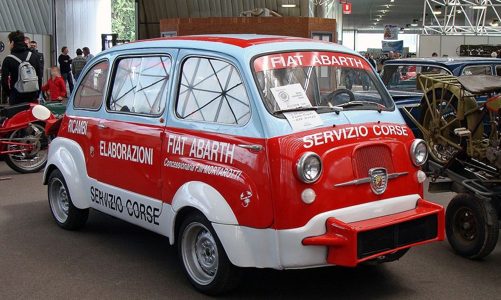

I think the honda D series will fit yhe fiat transaxle with a custom made flywheel and adaptor plate.
The starter motor is still an unknown though.
No idea what that might cost though, and there's no way around the bulkhead and rear panel mods needed though you could go full 600 abarth racing style if you were brave enough.
I've looked at the toyota 3 cylinder kr engine mated to a vw transaxle.
Despite being a cylinder less its actually wider then the honda due to the cast mounts on the front.
