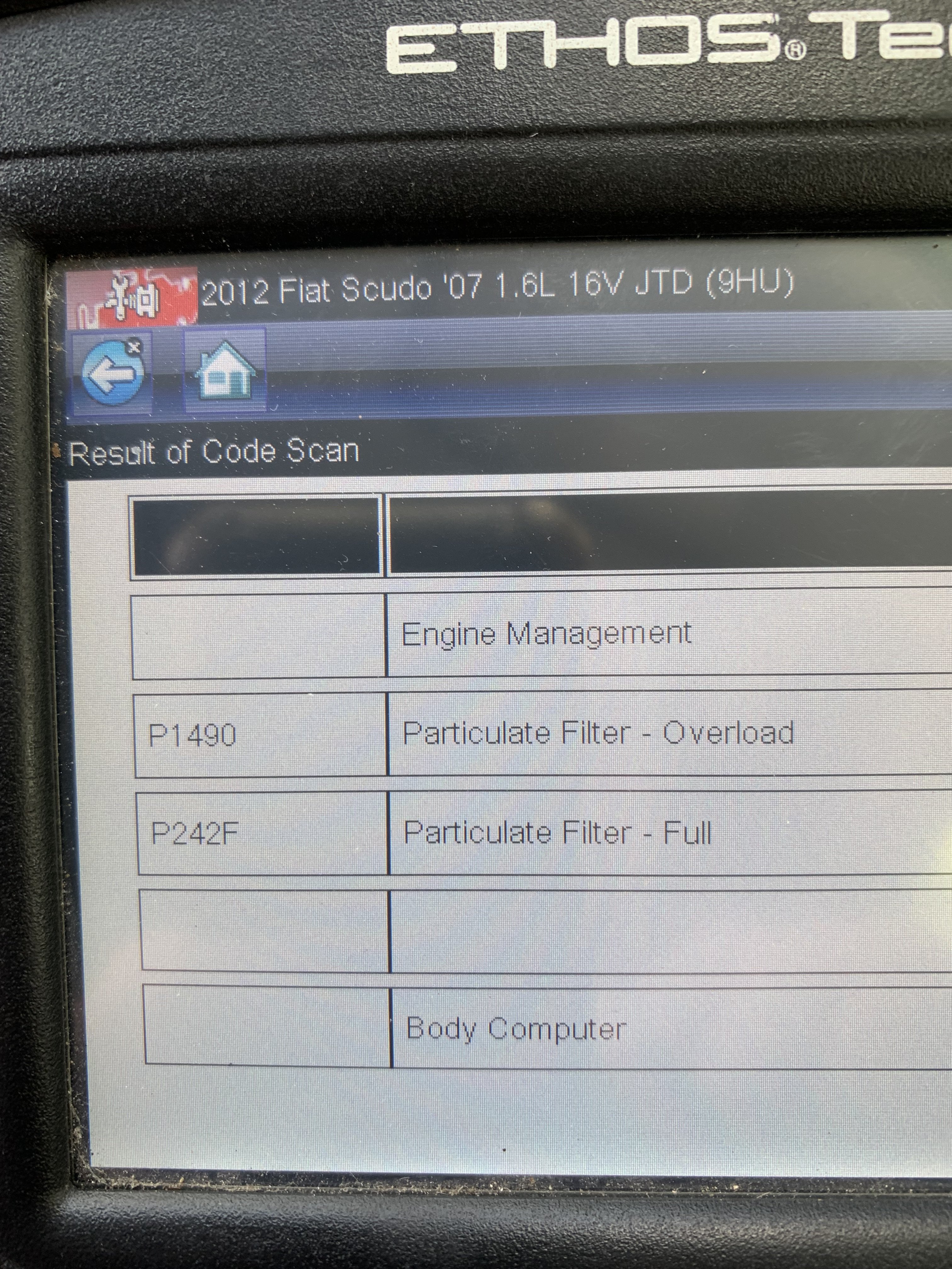

Just spent ages repairing additive fault on the pat fluid tank, that is now fixed and the pump is pulsing using actuator tests in the snap on scanner
Today these popped up, i have already cleaned this dpf twice and when additive tank was repaired, i got plumes of smoke out exhaust getting another clean.
Question. What is best stuff to clean dpf on the vehicle or does it have to come off, also, the old data is still in the van so do i need reset dpf telling van its new?
If its too blocked, what next, must be some amazing chemical to use. Thxs
2012 fiat scudo 1.6 diesel.
2012 fiat scudo 1.6 diesel.View attachment 469732
As I said on your other post, it wants coming off and cleaning properly or replacing.:)
Im getting very powerful blowing from exhaust it doesn’t make sense, does it need a dpf reset?
