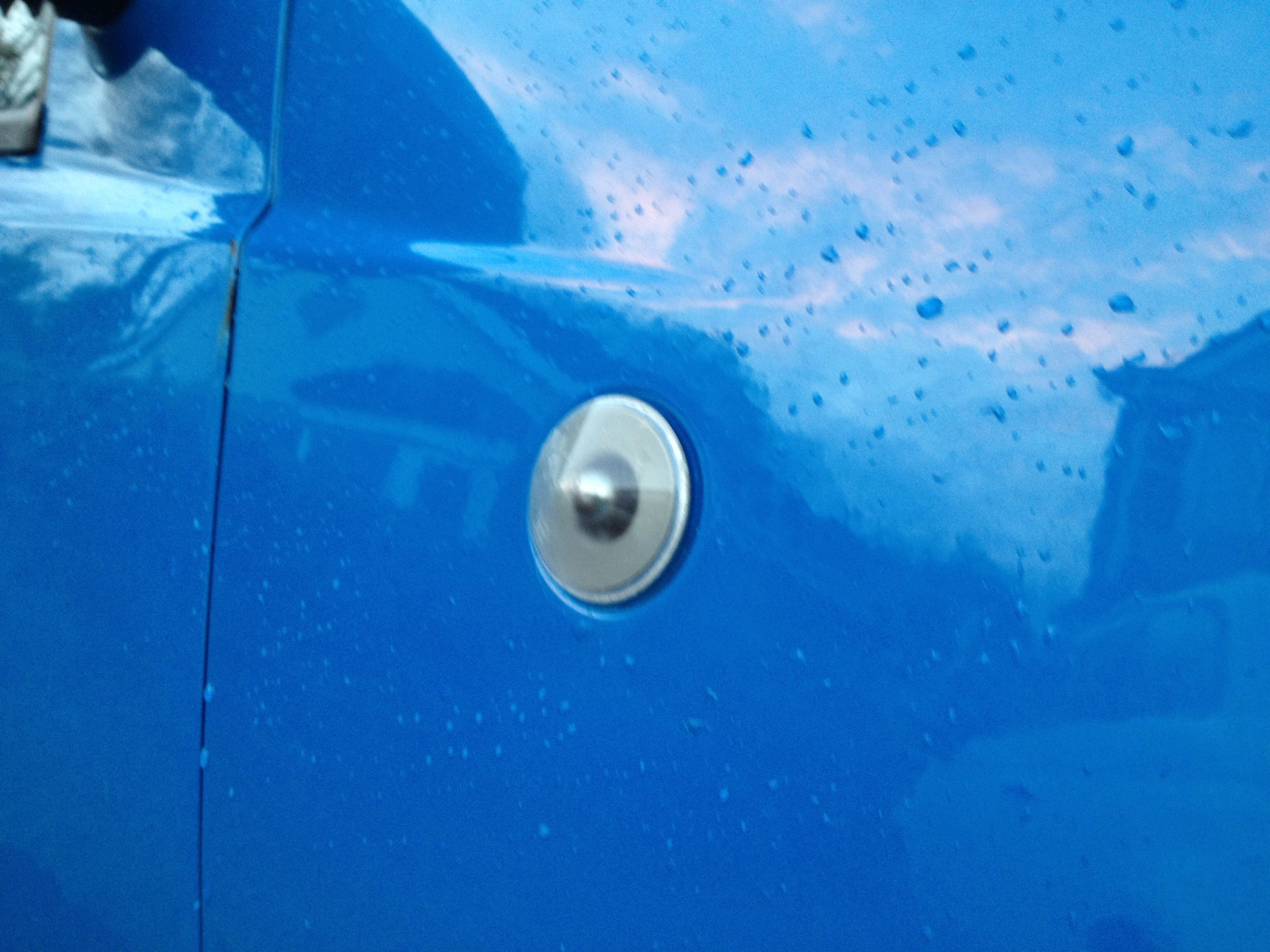

i got some chrome indicator bulbs from ebay
remove the side repeater from the wing, carefully open it there should be a little amber cap for the blub which you can just remove and replace the clear bulb with a chrome one
