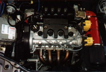

Does anyone know where the ECU is located on the Mk2 Punto 1.2 8v? Also how long does it take for a new ECU swap?
Having a Coil code in the ECU does not mean the ECU has failed, however there is a posibility the coil driver in the ECU is at fault but it is more likely to fail completely if it is the ecu. Check the wiring.
ECU is under the bonnet, silver box on the left?
Fiat Punto 1200 16v 1998
ECU is in the same place (silver box on left of engine)
Mine is the 8V, just checked and its under the Air filter on back of engine bay I think.
