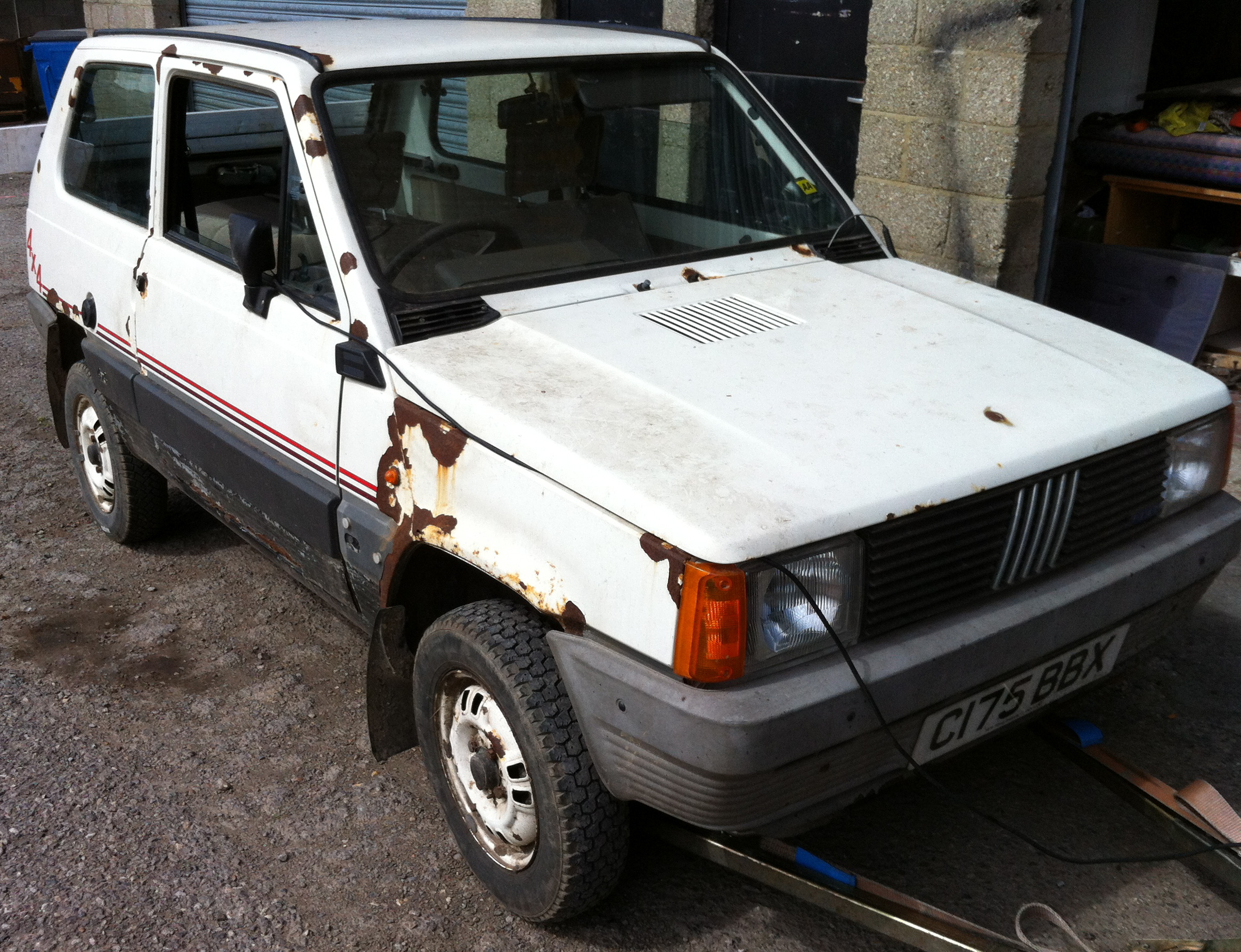

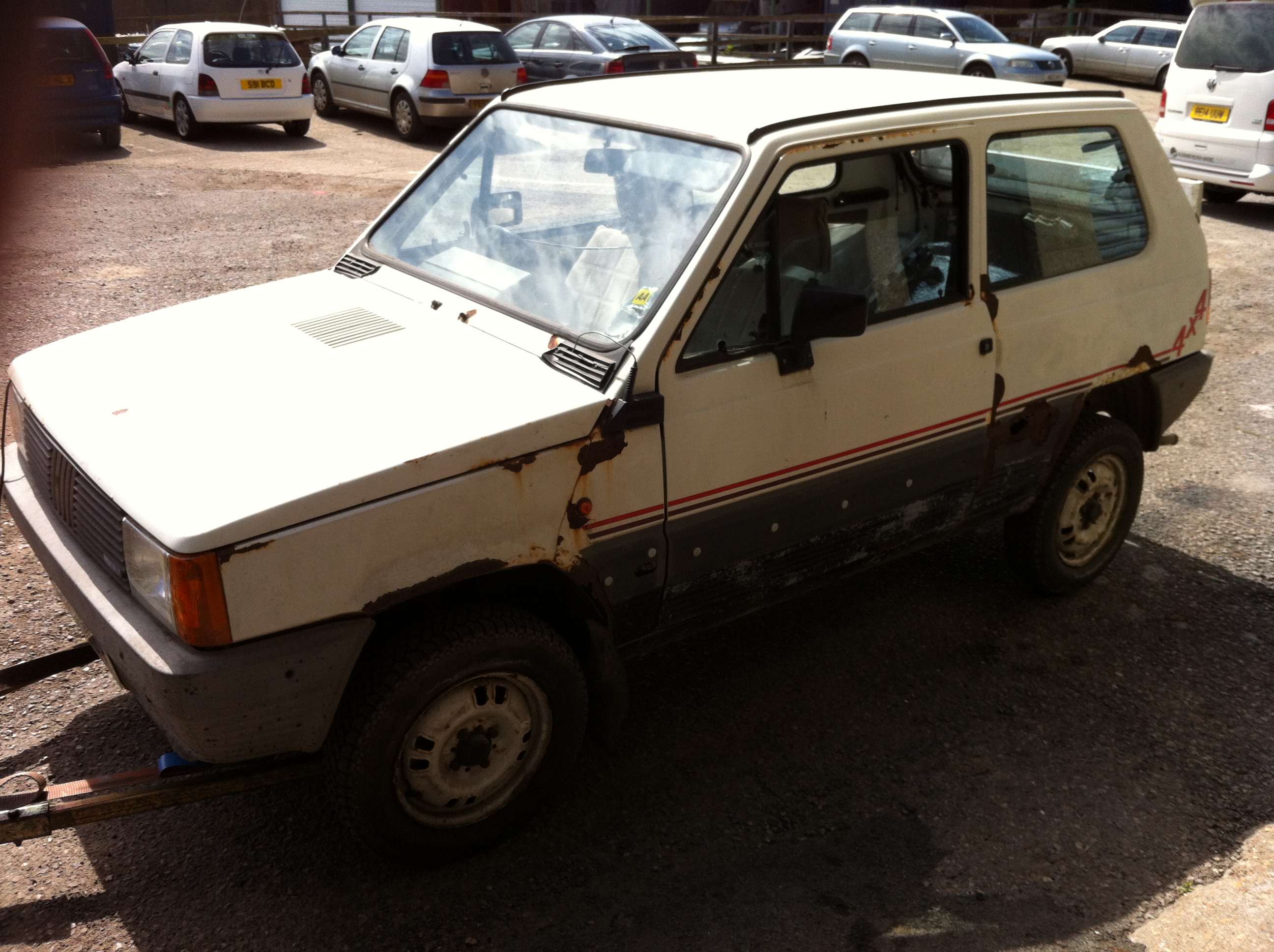

The car is very rusty as the pictures show, but as the listing describes, what you can see is all there is. Floorpan, sills, rear seams etc are all good, so apart from the tailgate I have all the panels I need to repair the shell.
I haven't had it running but Ladislav did connect up an external fuel supply and assures me it started up and ran fine, but the main fuel tank will need draining and cleaning. Engine, gearbox and drive train should all be fine at such a low mileage so I'm only expecting to need to work on the brakes and suspension in order to make it mechanically A1. Even in it's current state though you know it's going to be a good un, it just sits so fresh and perky that you can tell the rust does nothing to hide it's potential.

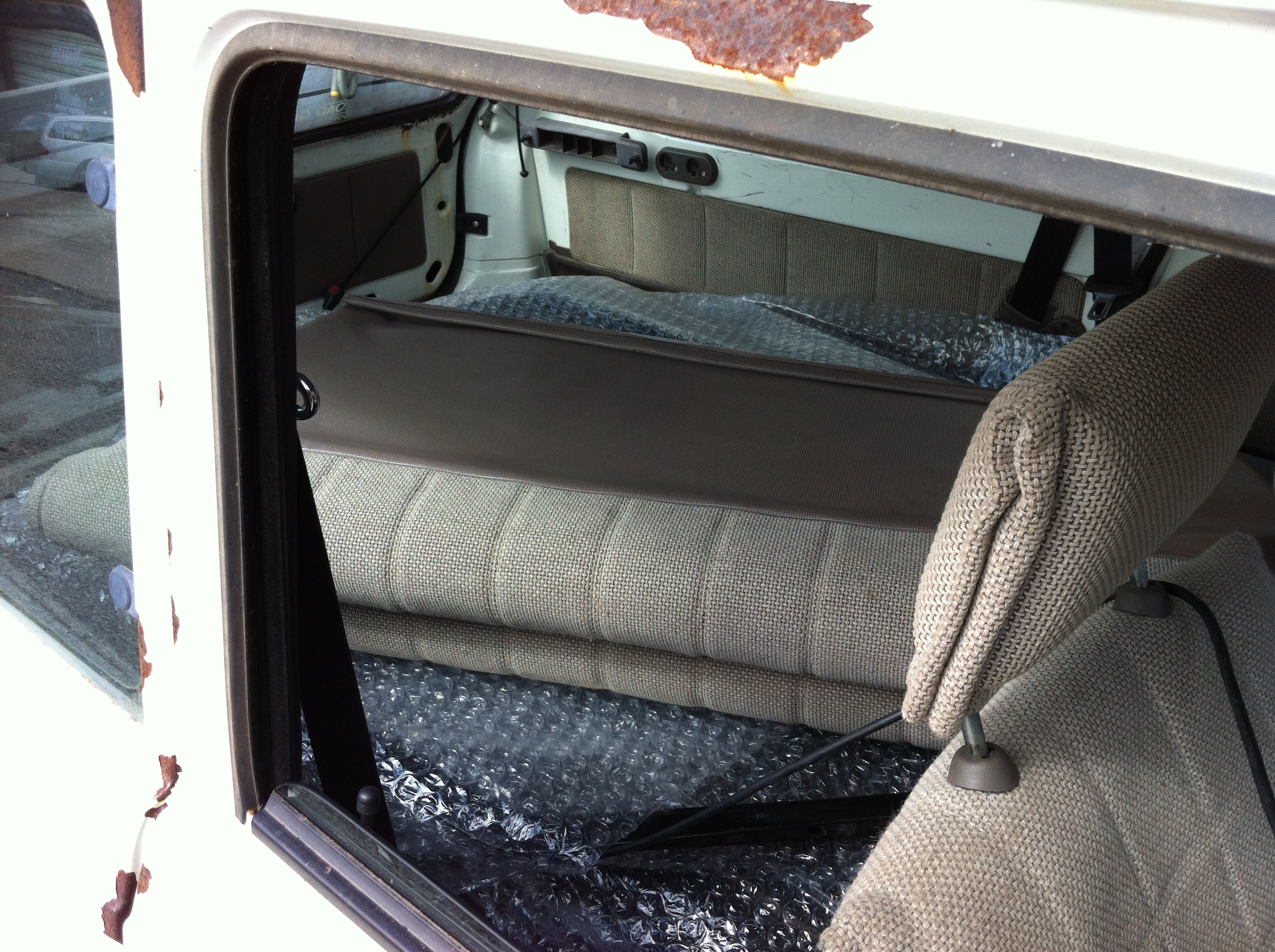

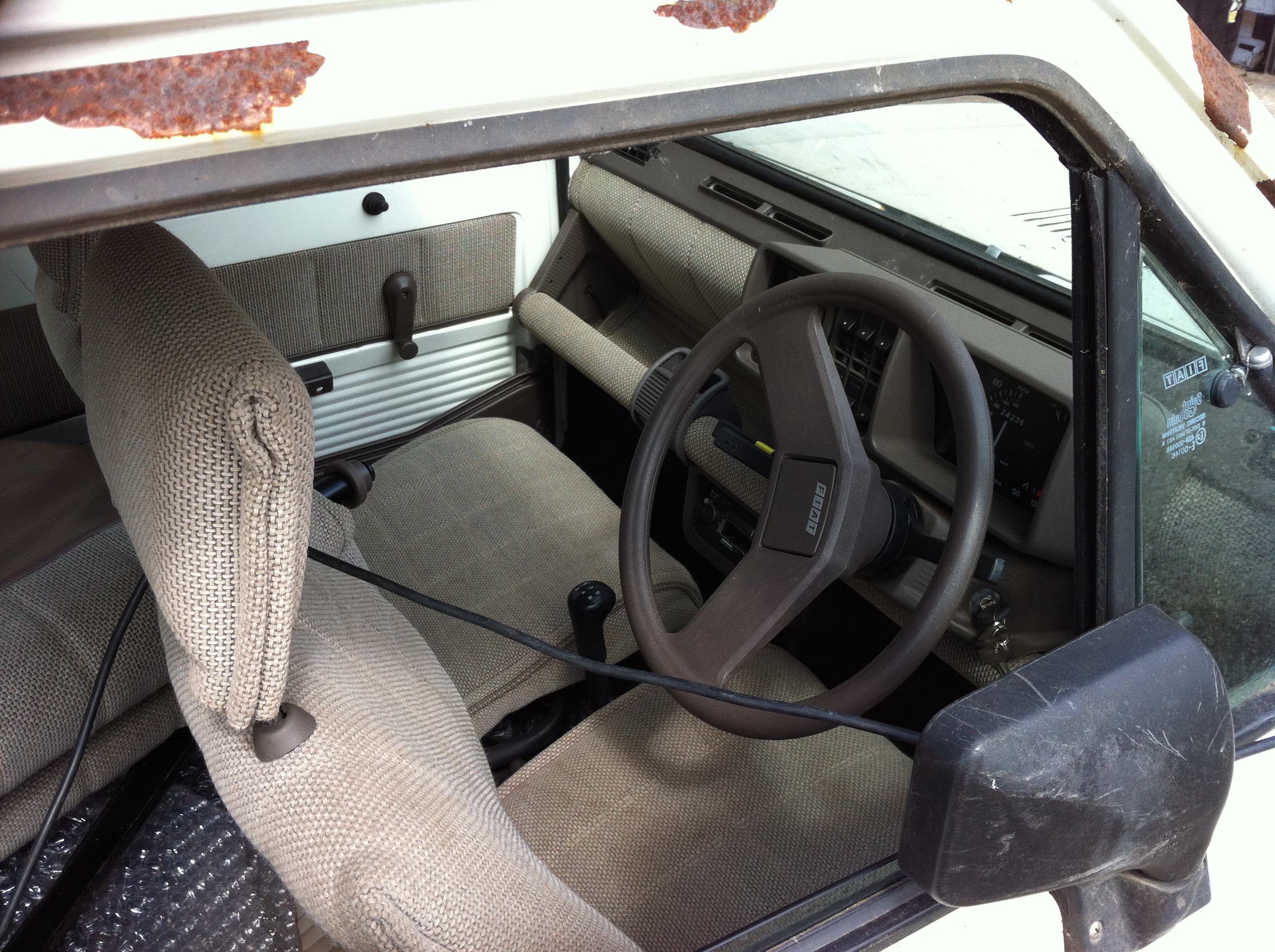

One of the best parts about this little Panda is the interior. Although the car has been off the road for six years now it must have been stored quite well because there is no evidence of damp or wear inside, it should be quite a straightforward job to bring it up to like new.

At the moment I've treated the rusty patches with Awatrol oil to help stop the rot going any further, plus I'm able to keep it in the dry until such a craz*, sorry, discerning person comes along. If I get to a point in the future where I'm looking for something to do and I still have it, then I will just restore it myself and either keep it or sell for what I can get.
I never thought rust would grow in such random places!
Yes it is very odd. All of the important areas are great. Looking at the paint that's flaking around the rust patches there doesn't seem to be a primer coat, Ladislav couldn't see any either, so as soon as the top coat is damaged in any way rust is free to take a hold and run riot. This shell will have to be taken back to bare metal to ensure future rust prevention is done properly otherwise it will continue to blister every time it gets a stone chip.
