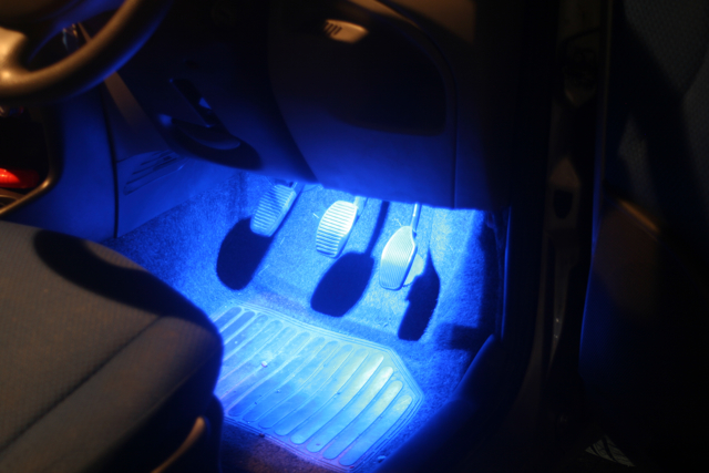

Firstly the footwell LEDs:
After much thinking and pulling my car apart i decided that the best way to do this would be to wire them to the interior light so that they come on when doors are opened ect. Im pretty happy with the way they worked! Ran the wires above the roof lining, down the edge of the window and into the dash all behind the panels.
(Photo attached)

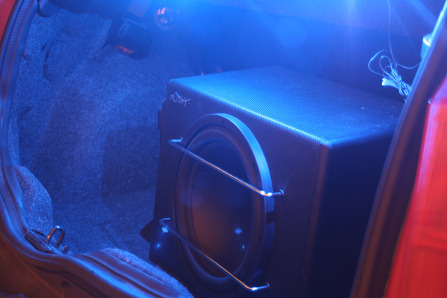

Then i did the same for the boot light, two LEDs in the parcel shelf.
(Picture attached)

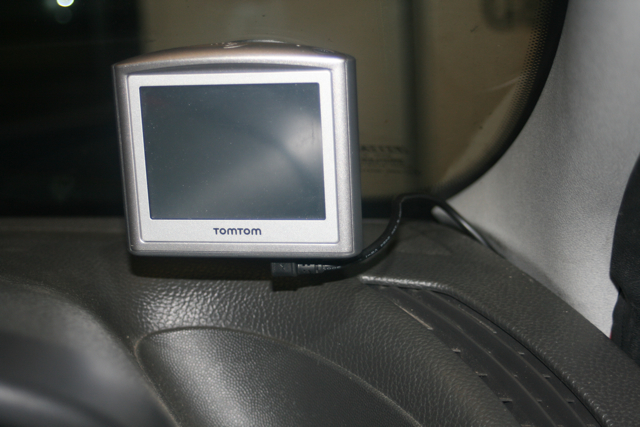

Then i also did a hardwire of my tom tom, i simply pulled the centre console off, wired a new cigarette lighter onto the back of the other one. and then simply ran the tom tom charger cable through the dash too it. And plugged it in as normal.
Im pretty sure it all looks pretty good,
hope you all like
