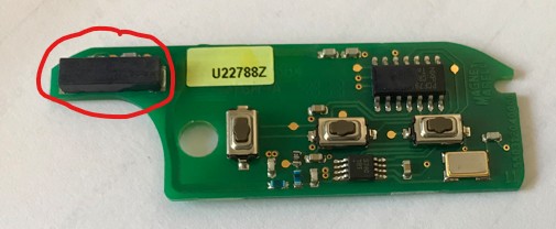

As already mentioned in entry #3, the original pcb the with immobilizer chip attached needs to be transferred to the new housing. This is how the pcb looks for my 2018 Ducato, with 3 push-buttons. My guess is that the 2008 version has similarities to this. The immobilizer chip is circled in red. As far as I know, it is just attached to the pcb and works independent of the battery and other components on the pcb.
