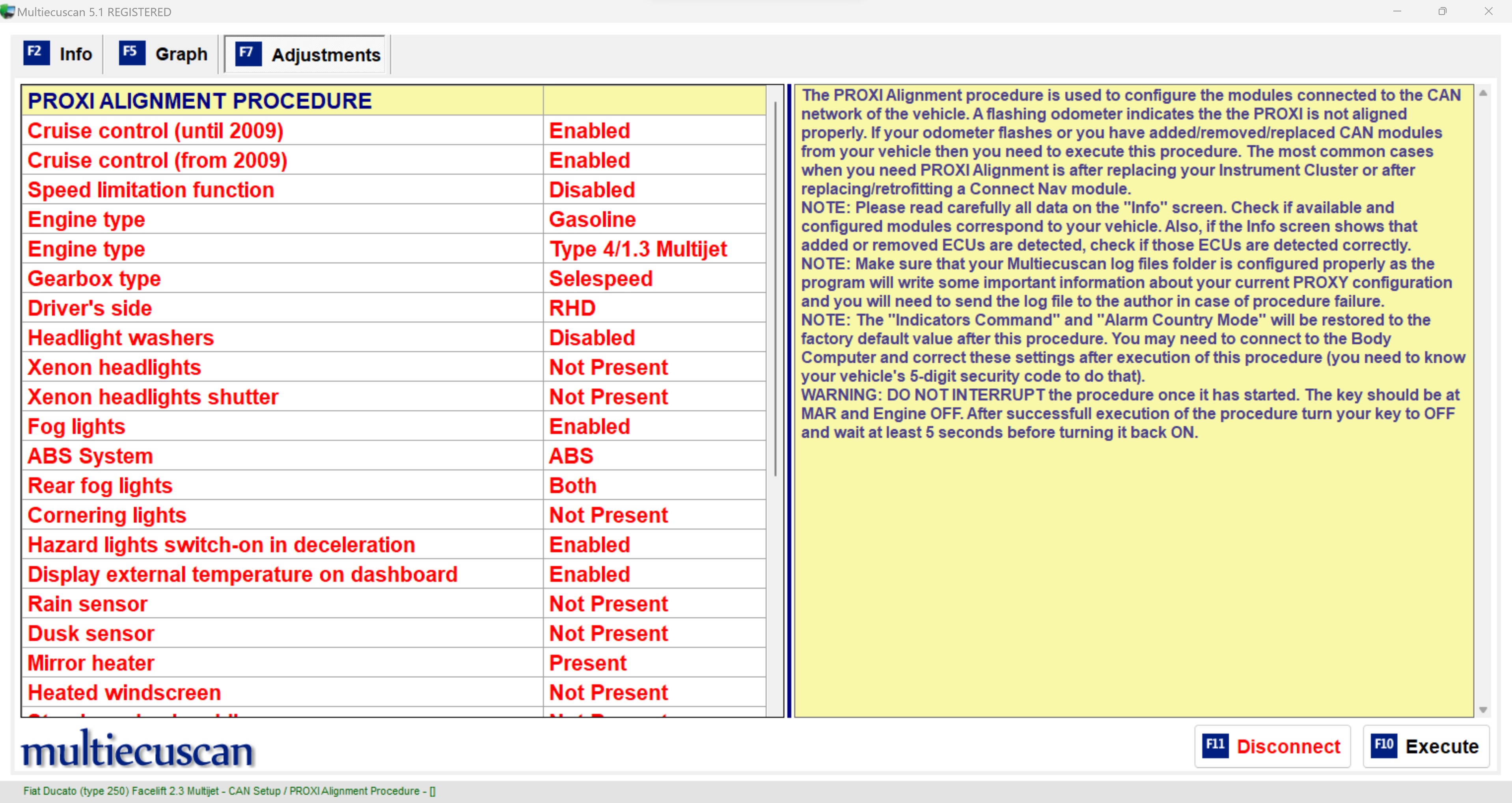

I have chosen the correct vehicle from the list on MES.
However, when I go into proxy alignment (and MES says all is aligned) the engine is listed as gasoline and gearbox as selespeed. I would have assumed these settings should reflect the vehicle??

Its a 2.3 130 Multijet, x250. That can only be a diesel. I cant see how FIAT would be so confused that my vehicle is set up as a gasoline engine when it has a diesel.
Also, it is not a facelift model, but interestingly the modules fitted to it are from a facelift model (eg Bosch 9 ABS rather than Bosch 8). Its a bit weird.

Well MES only lists two Ducato Type 250 Multijets. 2.3 Litre and 3.0 Litre. Both show as diesel. Where are you getting/seeing Gasoline and Selespeed in MES. Can you post a screen shot? Also MES creates a log file and you can create a PDF report.
Its in the "Body" System under Can Setup/Proxy Alignment Procedure. See attached screen shot. I also have to say that the engine type isnt a 1.3 Multijet.

OK, just to wrap this up. MES support said that this info was more historical and not used in more modern vehicles. Why it isnt correct is not obvious.
Anyway, it is working, and MES do not recommend changing it.
