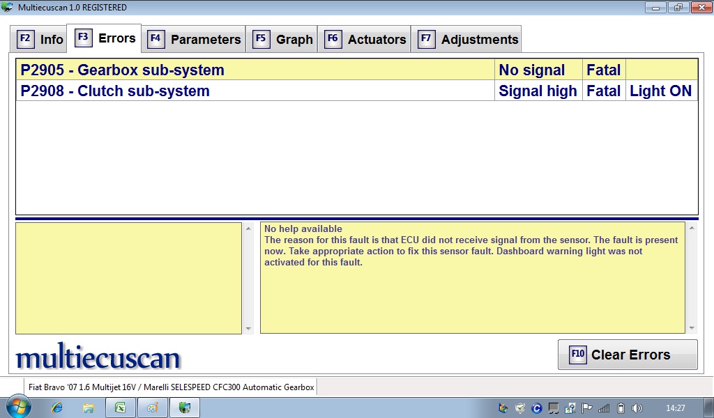

Decided to have a pop about, checked the obvious, electrical connections, clutch fluid level (all 35/45ml of it), even a full charge of the battery and checking of the earthing straps etc. Plugged MES in and the fault codes were nice and none specific (they look fairly specific, but read on..)
- P2905 - Gearbox sub-system
- P2908 - Clutch sub-system

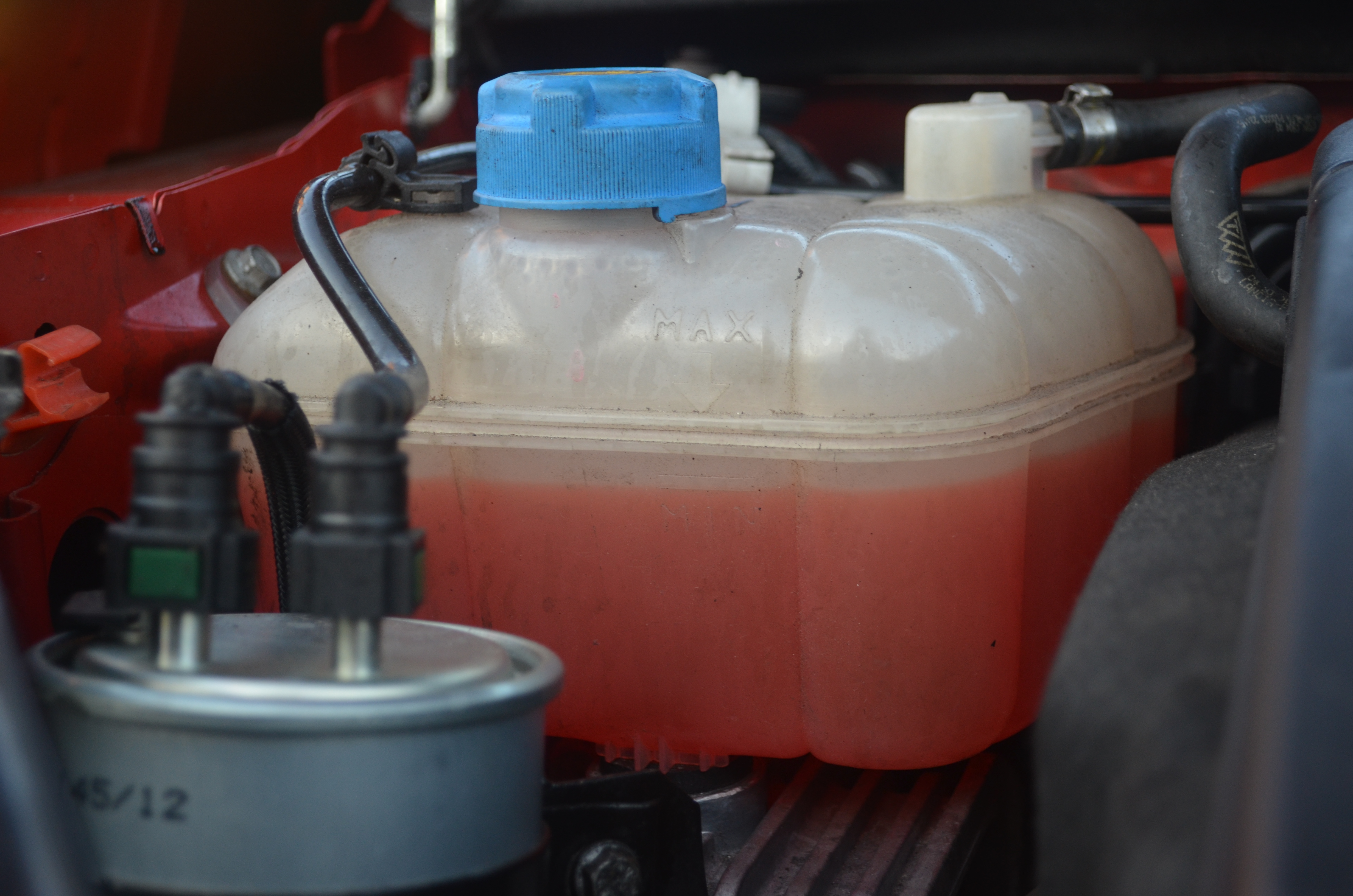

1. Coolant Level was sitting on Minimum – It went into Desira on the Maximum marker.

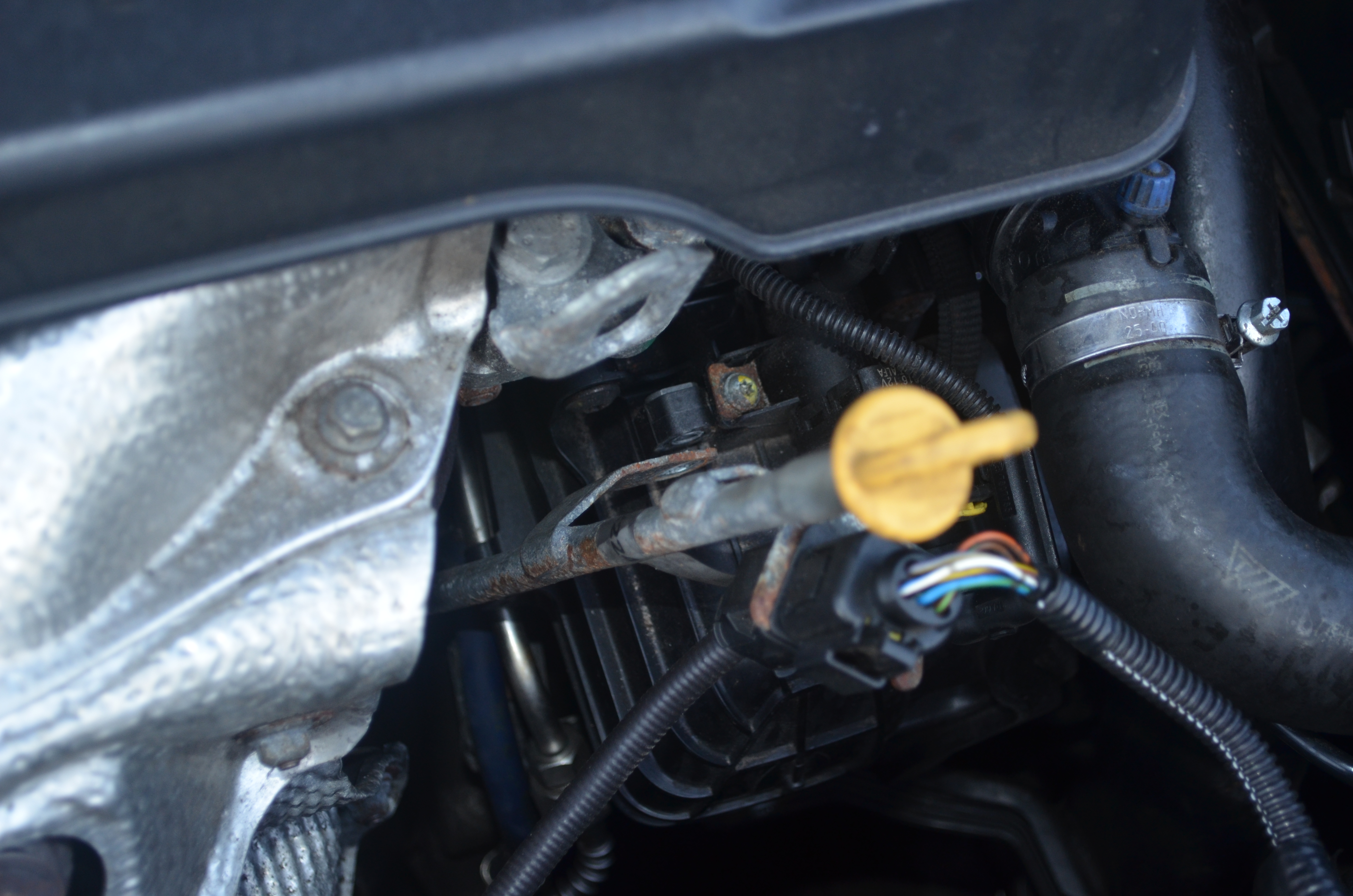

2. Various missing bolts from the area of the engine bay that had been worked in - including dipstick retaining bolt, so the tube was thrashing about everywhere when the engine was running, good it didn't completely come away at the sump and loose all of my engine oil on the 120 mile drive.

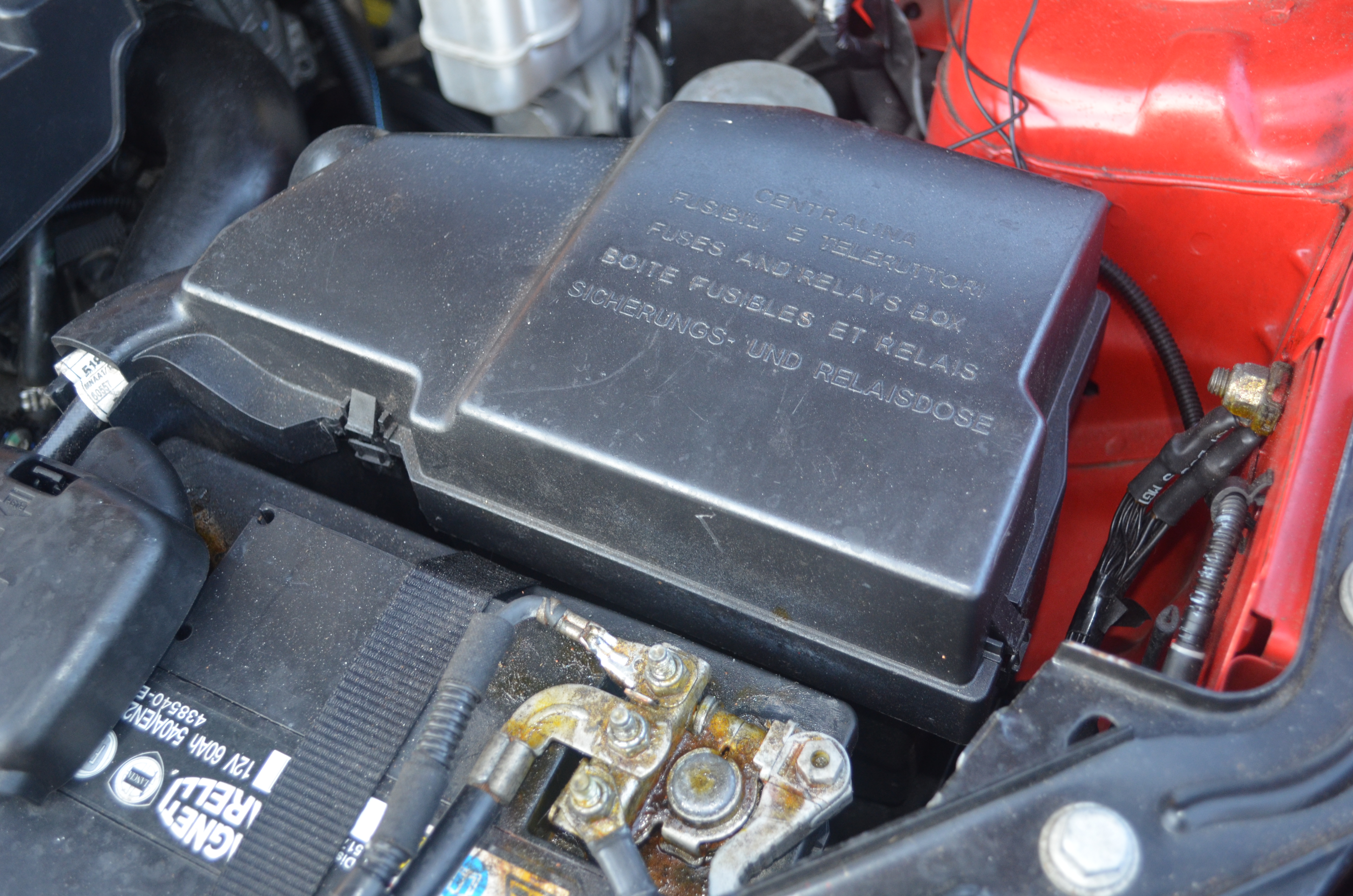

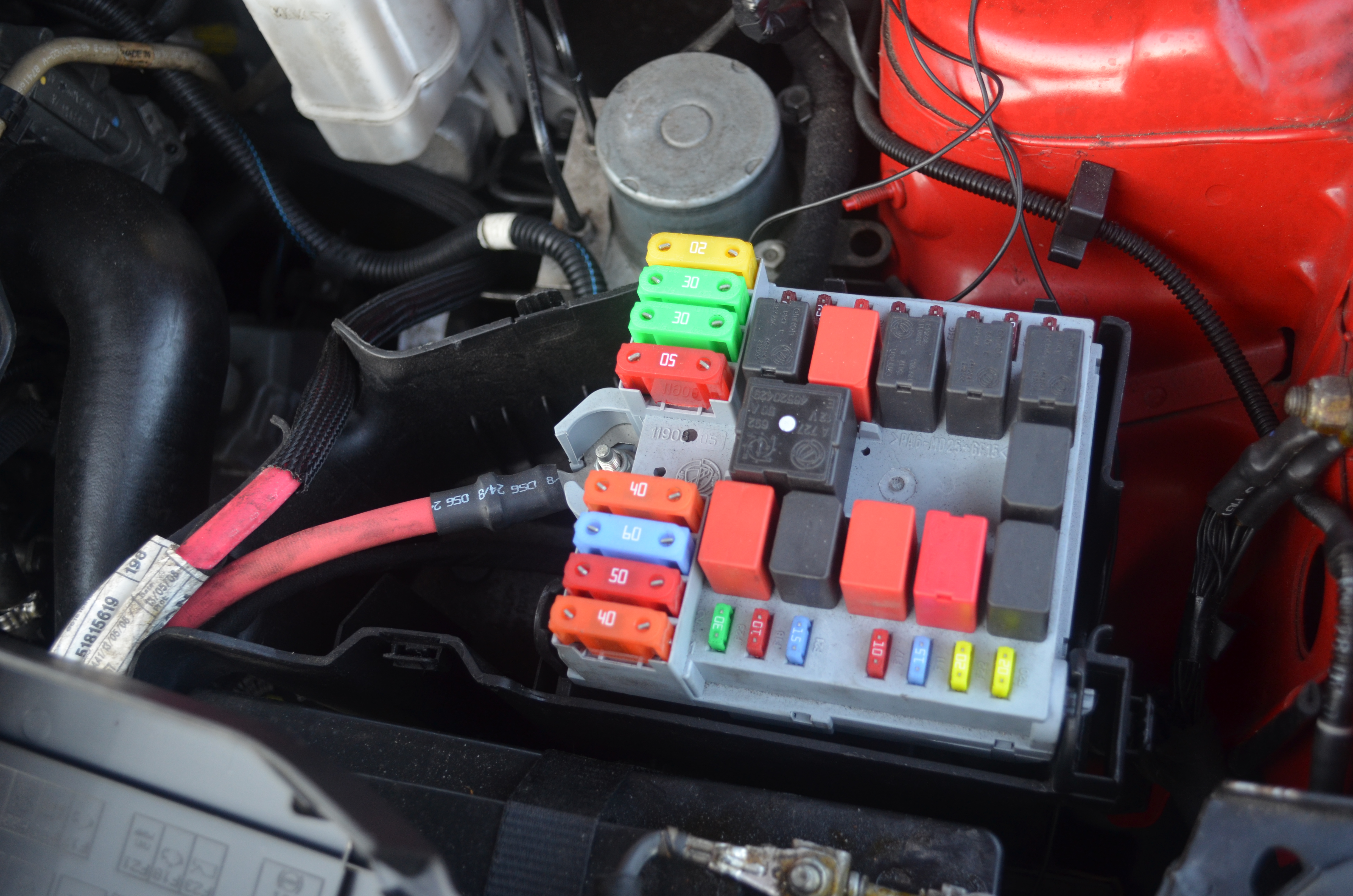

3. In replacing the battery within the battery tray wiring had been trapped and crushed under it.

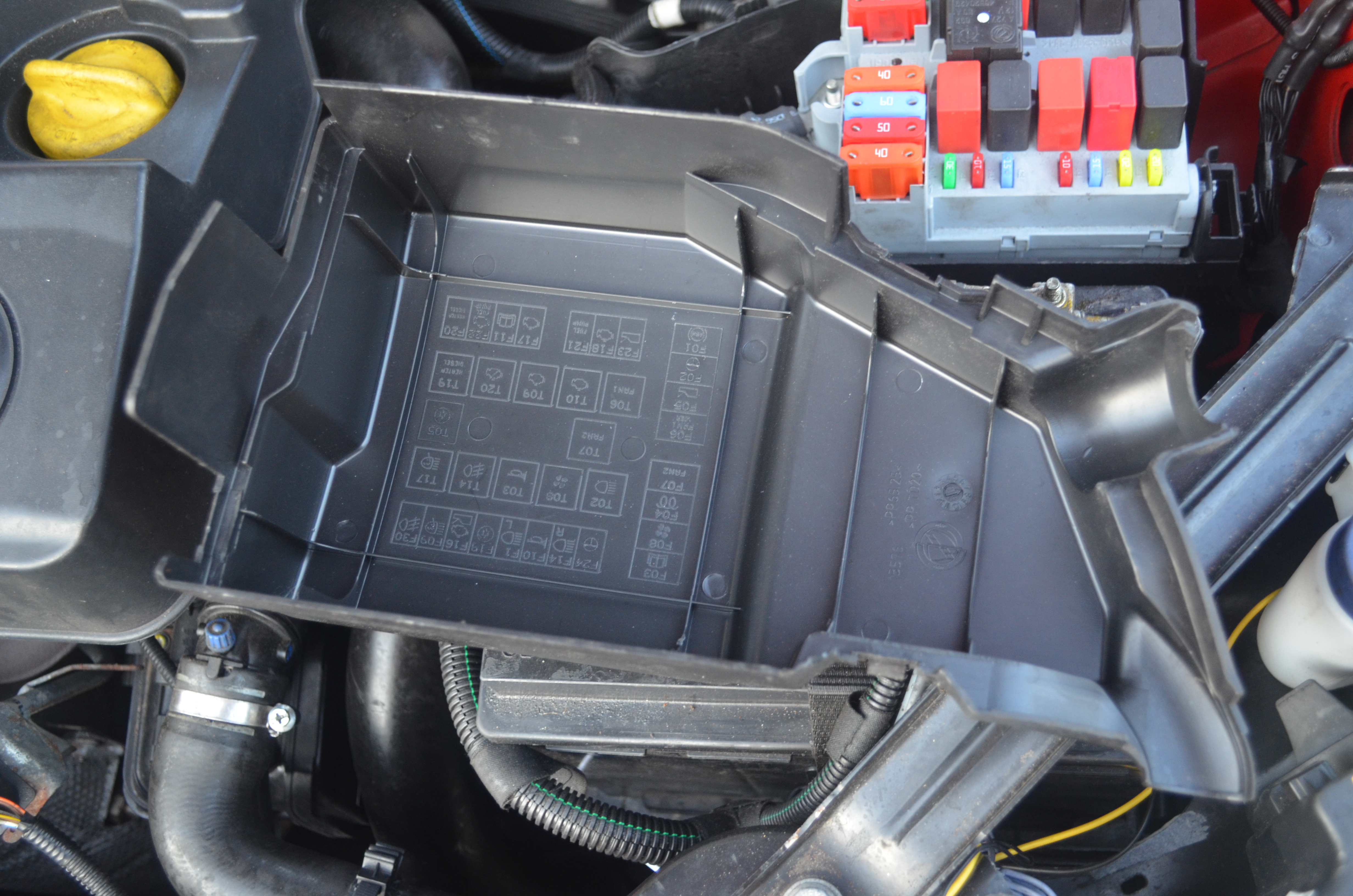

4. All of the retaining clips for the engine bay fuse box cover had been snapped off / lost. No attempt to rectify this, the cover was placed back on the fuse box, possibly in the hope this wouldn’t be noticed?
