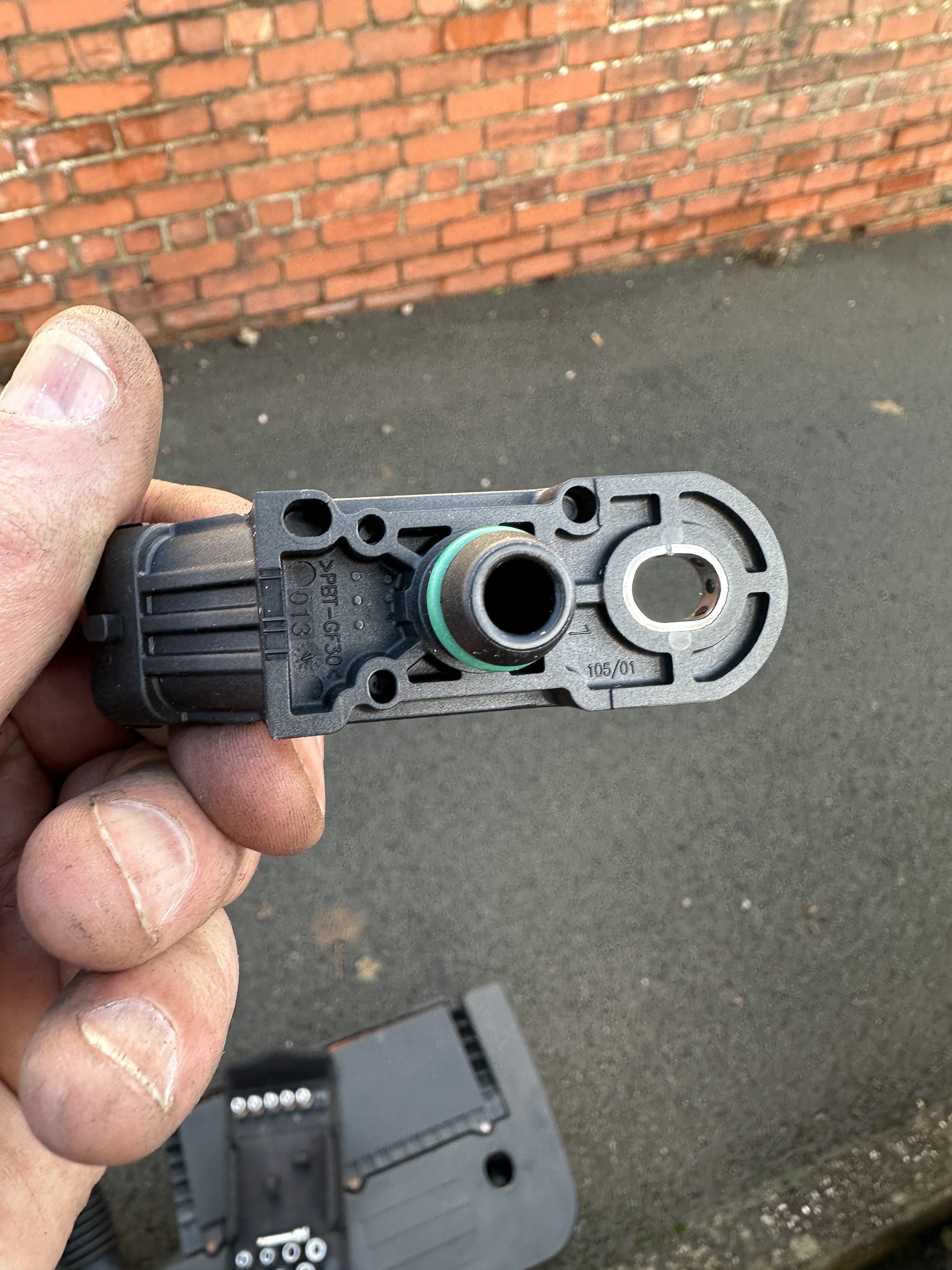

I don’t know why cleaning/replacing the MAP sensor isn’t considered a service requirement. Only 56k but I suspect a lot of short journeys and I’ve posted original sensor and new. This blocked it can hardly have been working, hopefully that’s stopped at error codes 🤞🏻I could have cleaned it and tried to reuse but as I’d already bought a new one it seemed sensible to fit it.
Ninky feels like it’s had a heart valve replacement! It now pulls much better and definitely feels like there’s a more power… well a little bit perhaps 🤣

I’d seen a post on FB where i think a Dobolo had had the same issue/codes and they had a similar looking sensor, so thought I’d check. Definitely worth doing. I’m just trying to stop myself thinking about the potential state of the EGR! I also noted that the MAF O ring didn't look particularly great so I’ll replace that in the near future too, I’ll have to learn to stop looking for things!
