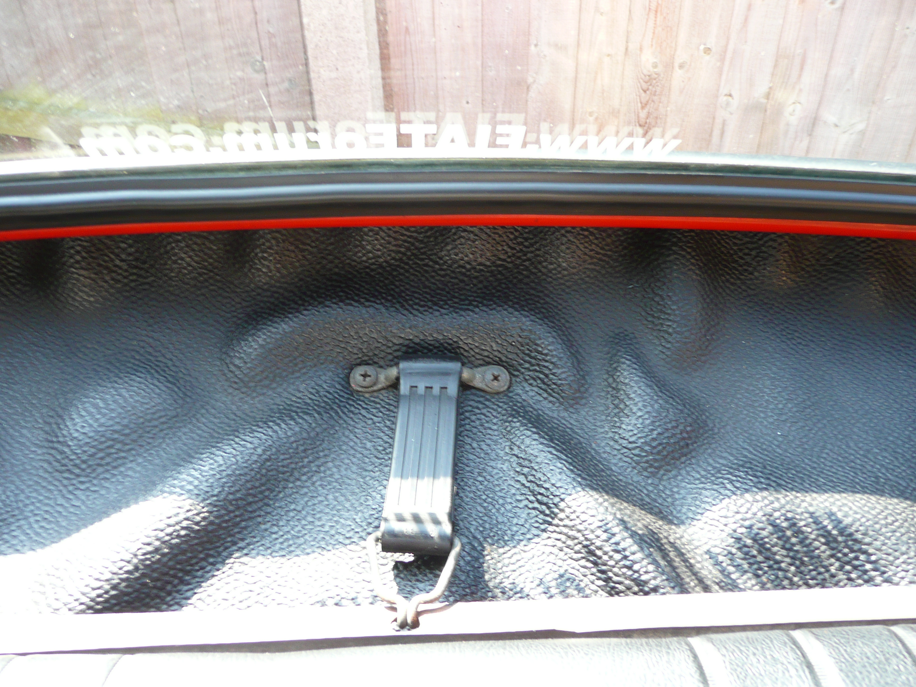

Only question I can answer without taking a look at our own car is number 3.
The rubber strap secures the rear seat back cushion to a bracket just under the rear window.
I'll take a photo of it next time I get the car out! (y)

Ok Shanil - here you go:
Rear seat rubber strap:

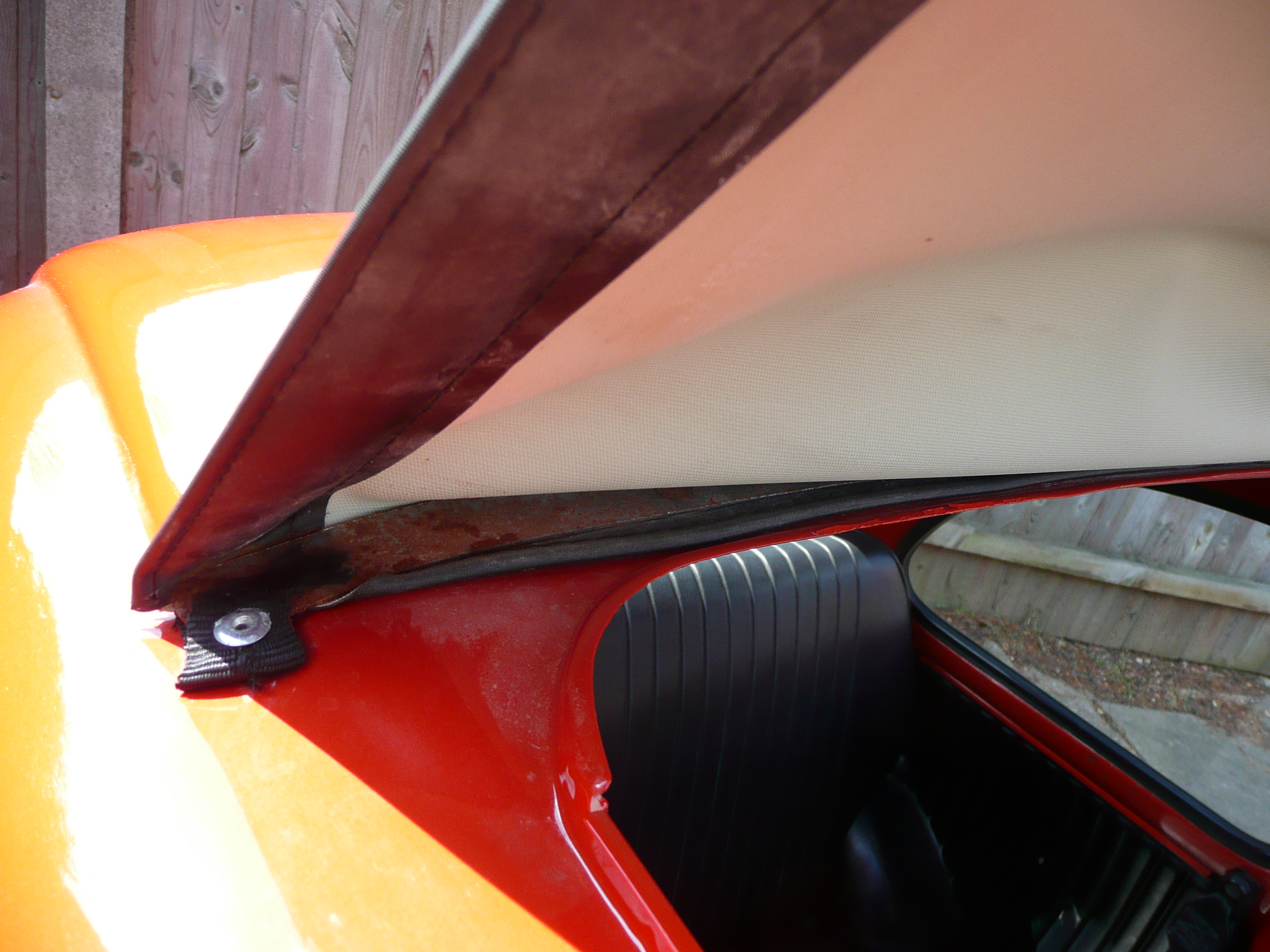

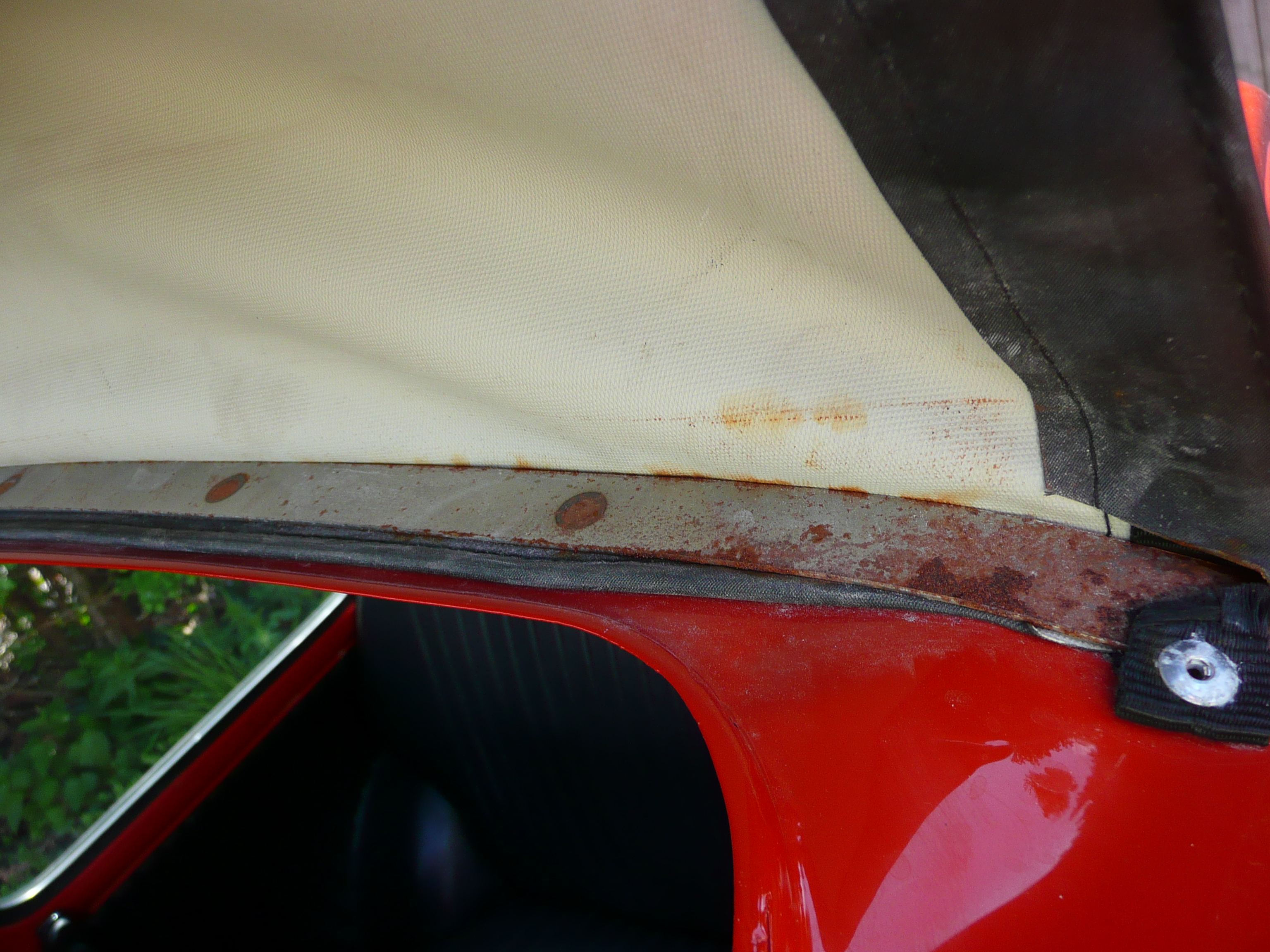

Sunroof - ours appears to be fixed in place with two large pop rivets through a securing bar - not sure if this is standard:
Thanks for the pics, your sunroof seems to be a modification as I notice there are marks of bolts right along the rear end which seem to have held down the canopy, I too have these 2 straps whihc have been held down by 2 bolts as per your pic but I am not sure if the canopy should be drilled and bolts passed throught them even at the centre
The sunroof rear clamp should have several threaded studs which penetrate the sunroof and roof, and be secured by nuts inside car. The original fixing at either end was via selftapper screw but these tend to rust and create a larger hole, causing many renovations to have blind rivets installed as per oopsadaisy car..The black painted rear sunroof bar is prone to rusting and there appears to be a galvanised one available nowadays which is slightly more expensive...
