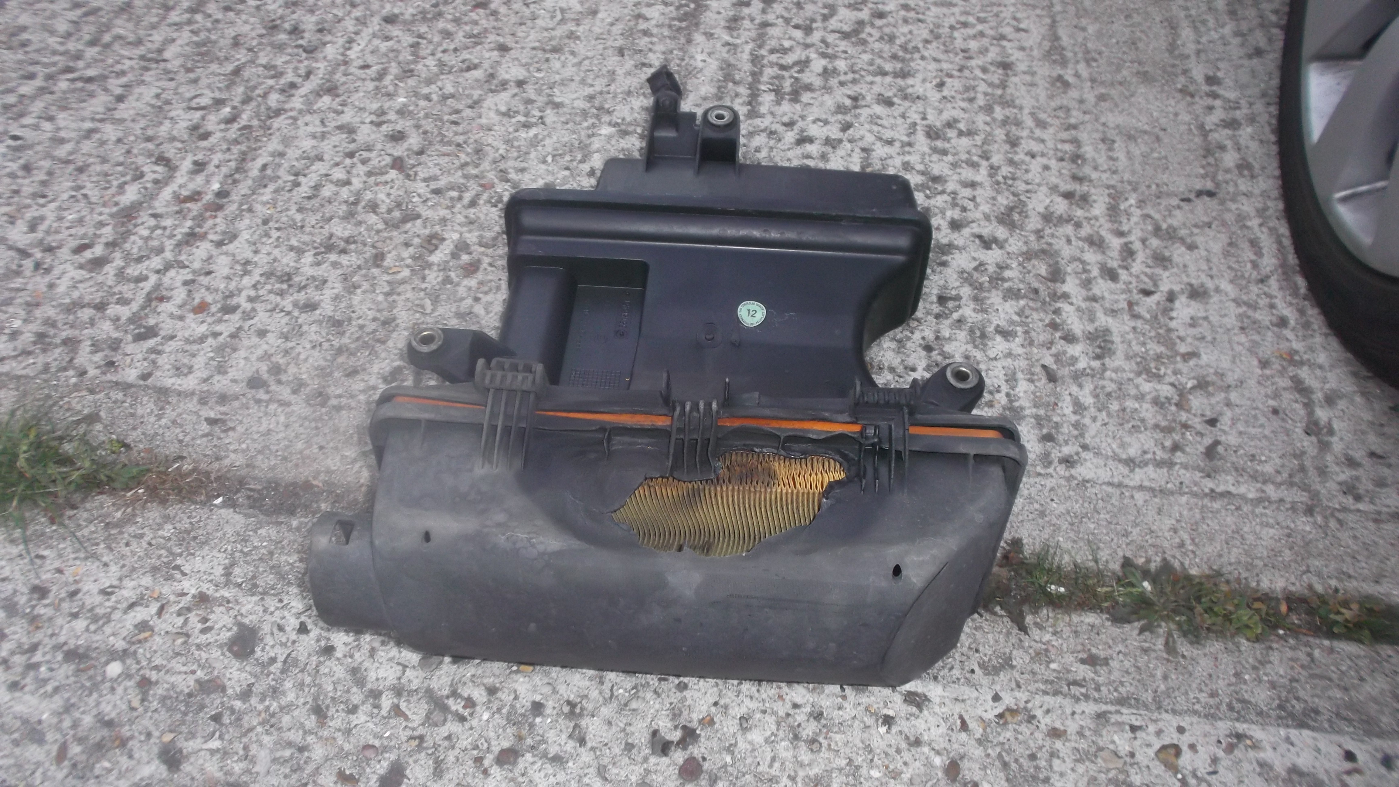

many here including my self have always said running with out the manifold heat shield is fine, maybe this is bad advice when its as hot as it was today,
this is on a 1.4 16v Idea but same set up as punto 16v

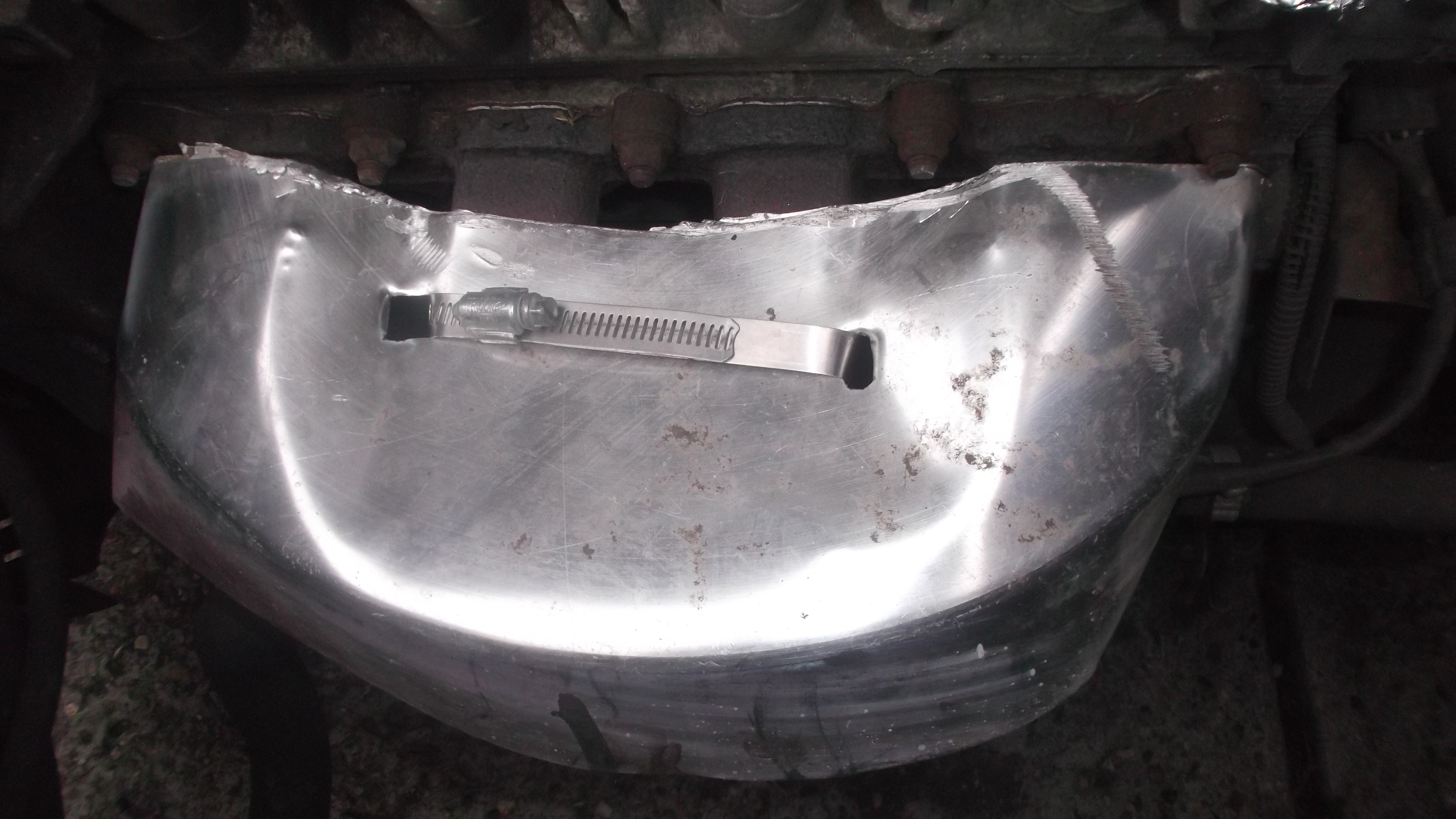

Temporary solution as original heat shield has gone some where safe. not sure if it will help or make it worse. its a bit of an alloy lamp shade held on with a giant screw clip.

aroldite putty they even sell it in halfrauds!
https://www.google.co.uk/#q=araldite+putty+adhesive
my heatsheild is currently held on with one bolt at the bottom and just bent and squashed to minimise rattling. Is it okay to just use that stuff to stick it in place? The bolts have sheered off so cannot use them to hold it into place. All else fails I will use daves solution using the metal band
you wouid be wasting your money,
you will find it will just end up stinking the car out once it starts burning off,
not even JB weld wouid withstand that heat,

Indeed but when it is rattling like mad and previous owners have used a cicular drill bit to remove the heat shield then all you can do is remove it.
I need to try and remove the studs from the manifold then i can refit it.
