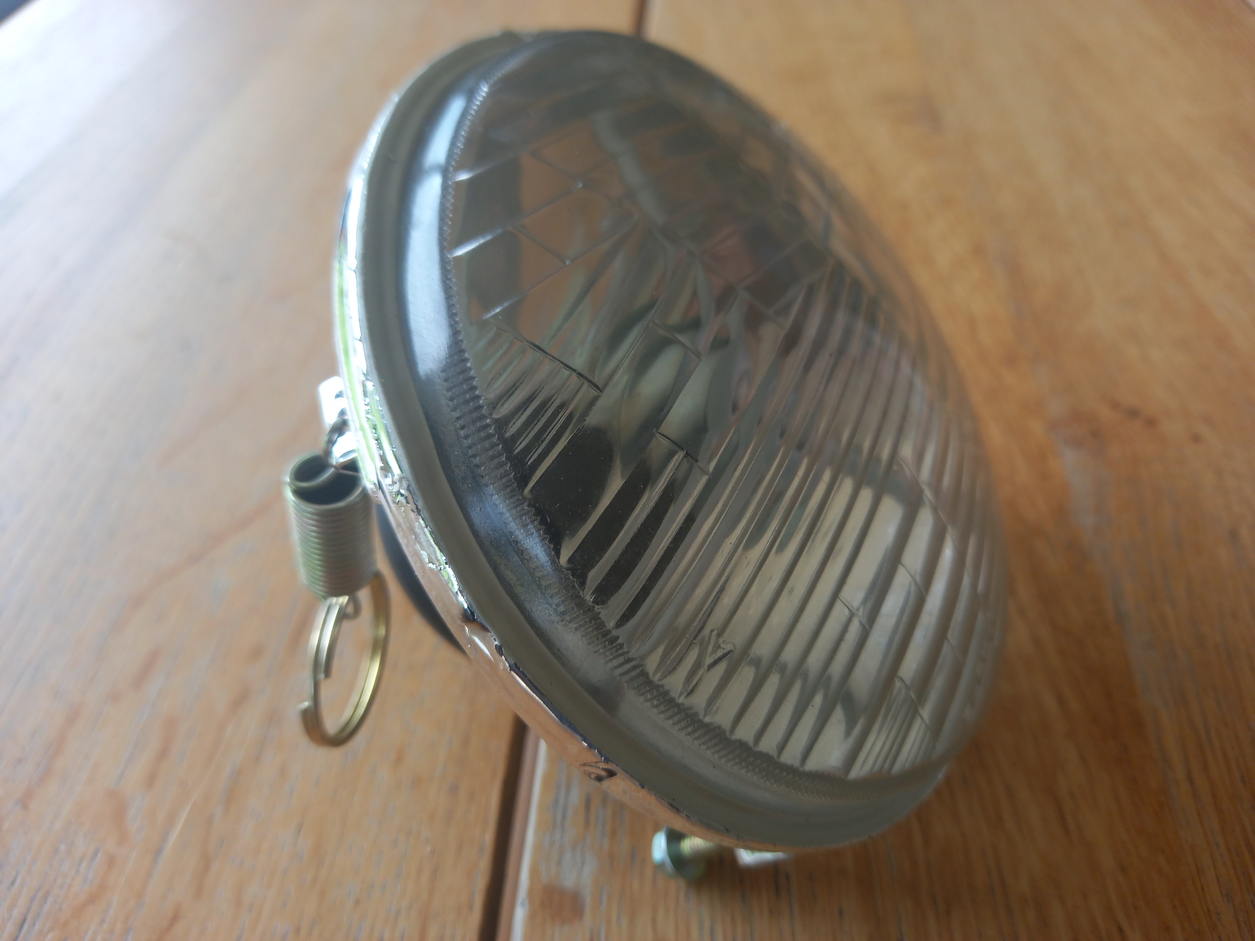

Autobella sell some inexpensive, LHD headlights that they say are of a superior quality to those commonly available. Other than being wrong handed, they also lack the little sidelight as featured on UK cars. This is a source of dampness and then corrosion and I am happy to forgo that.
Drawing on my previous experience, I carefully removed the lenses by using a craft knife to scrape and gouge out the sealant that secures them. Fortunately, it is quite soft. With great care, using thick gloves and glasses over my eyes I eventually levered the lenses out, taking care to vacuum away all the bits of sealant and keeping the reflectors inverted.
The original Carello lenses will be inserted on a bed of PU sealant and I will have the satisfaction of saving a little bit of money and having the best possible lighting (sidelights apart ;) and an original appearance to the car.
