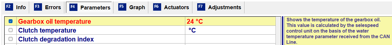

I am concerned for you. you may be going down the wrong route trying to find a sensor in gearbox rather than the robot actuator. Even then the temperature may be calculated by the transmission ecu rather than directly measured.
Almost 100% certainty you will need the tools to connect to the transmission ecu read live data and see what is going on.

Screen print from Multiecuscan below. I assume that water temperature is not the only parameter used in the calculation.
