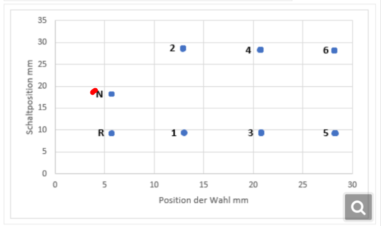

The reason to suspect sensor was the DTC (P0919) came up, the engine running and vehicle moving, but the gearbox voltage when DTC came up was 13.49v
