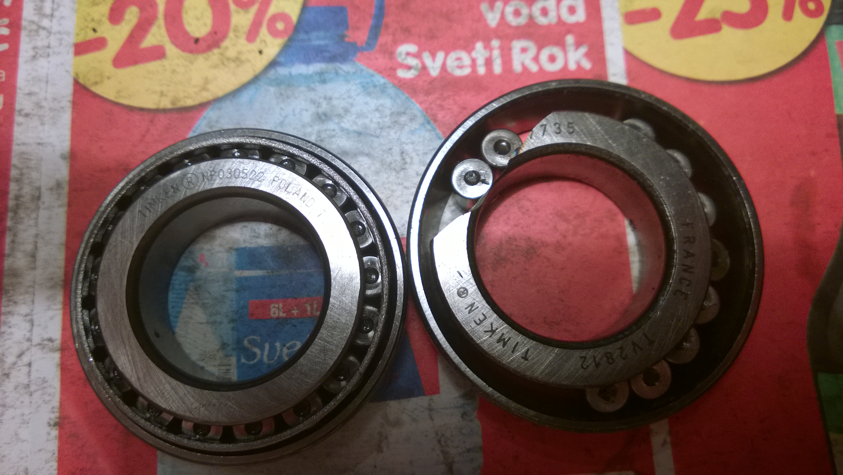

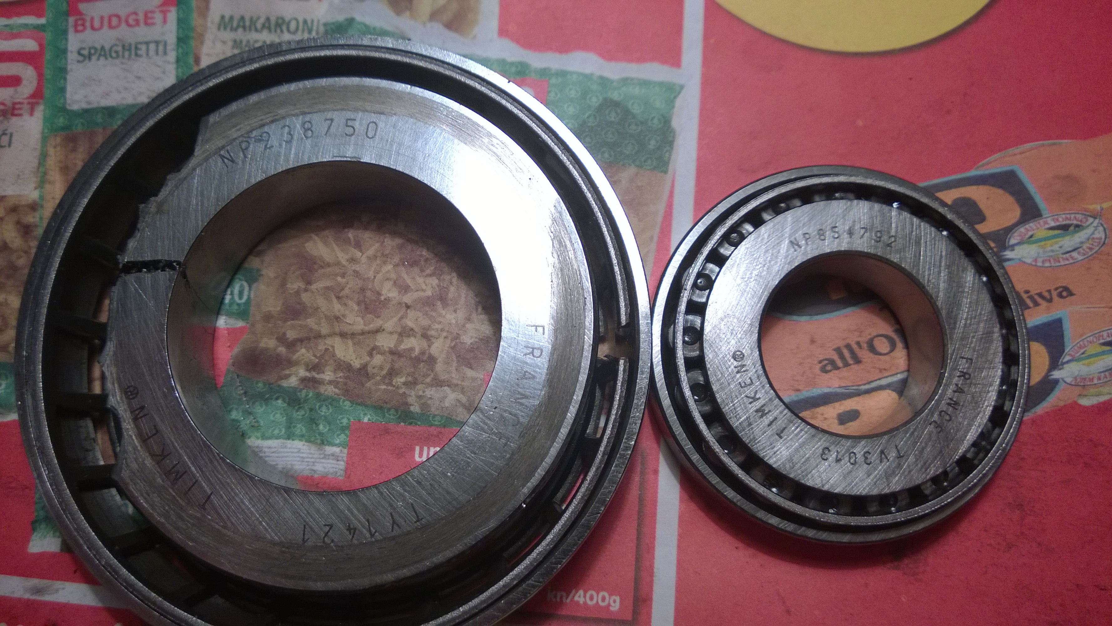

Job is done.
for 457£ (563€).
I gave you wrong info about bearings. Mine had all six TIMKEN (not SNR)
In attachment you could see bearings.
TIMKEN to Fiat Part#
NP854792 --> 55574107 x2 (problematic bearing)
NP238750 --> 55181940 x2
NP797735 --> 55574104
NP030522 --> 55574101
Photos could confuse
They had to cut bearing to remove them. Because NP238750 looks like as destroyed.
Ok, that is more likely.
So while they were in gearbox, those bearings were complete, no damages like those in pictures?
But originally they were Timken, so best quality that you can buy for gearbox, and they still are no good.
And replacing them with the same quality :confused:
