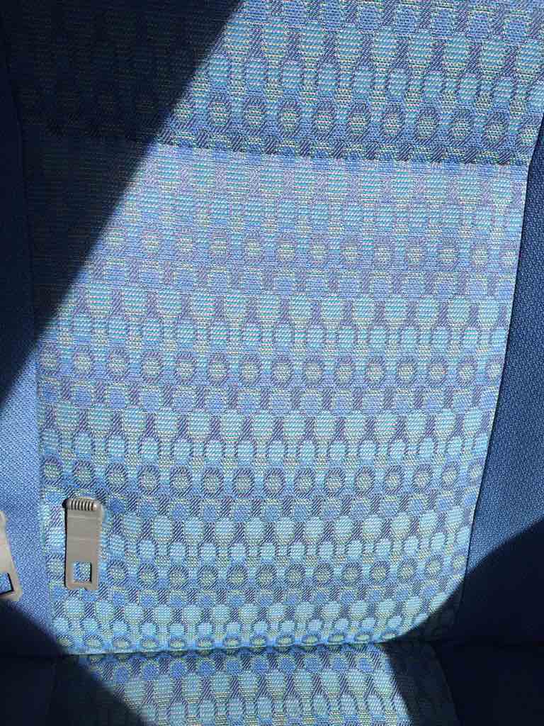

Rear seat base (nice fabric, blue no 224) has split at a seam...anyone got one they don't need?!

ImageUploadedByFIAT Forum1464619411.342228.jpgis this the same blue cloth ? they need a good clean , no holes .free if you want them , you can have the whole car if you've got a trailor ??
Thanks I will have a good look tomorrow & check the match!
David
Well they are very close...I have a brochure from that era & I think your seats are Blue Cloth 234... whereabouts are you? I am Stratford on Avon.
I don't think I need the whole car....but!
Hi David , the seats are in a 1998 60 s not sure of the code , I am in Chesterfield , think we have spoke before at Stanford hall show .
This thread is getting busy! Let me have a think & I'll come back...I HAVE to find the B####Y horn first! 98 sounds good!
