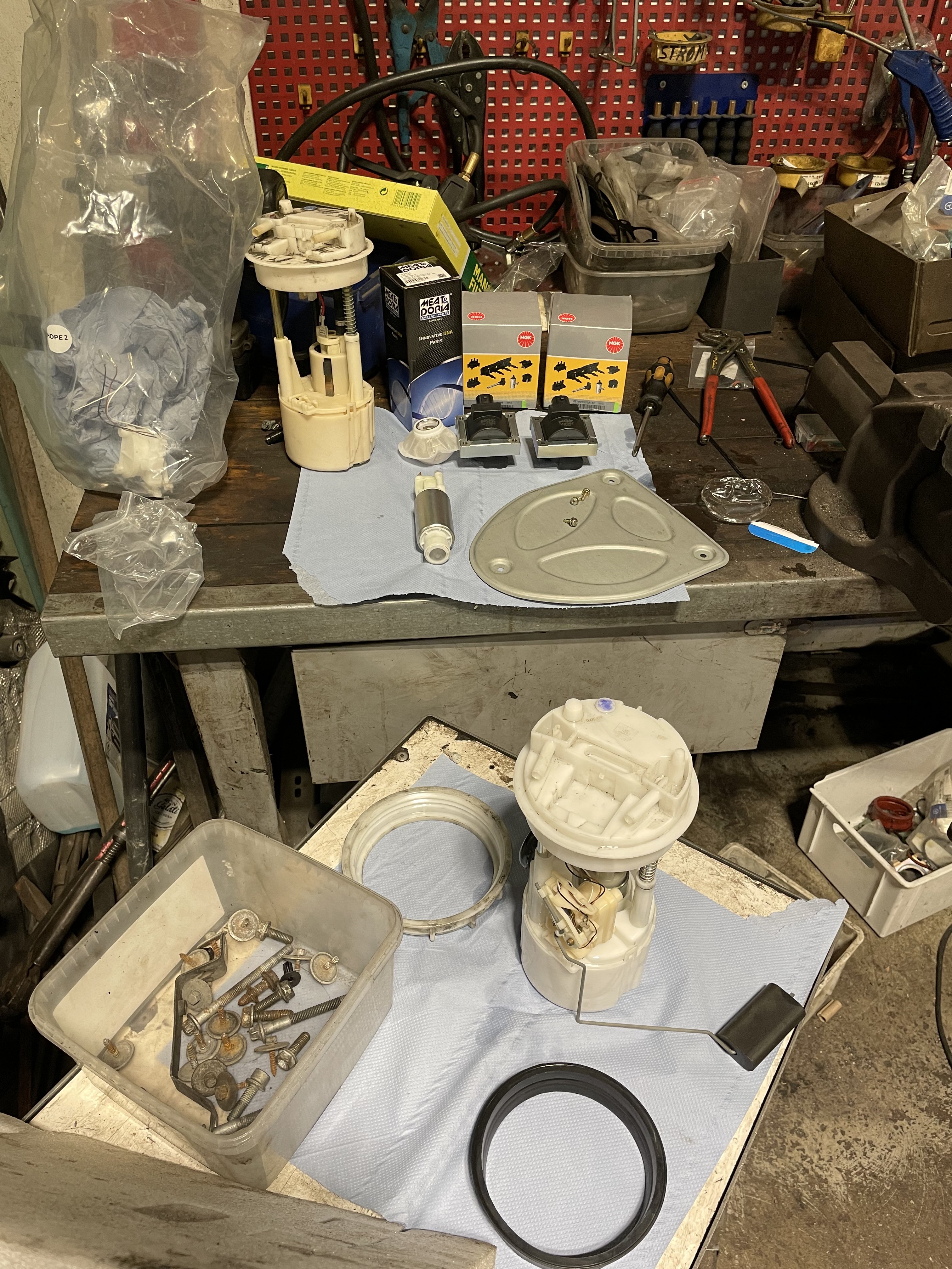

It might be a problem on the fuel house leaver.
My original was very stiff and the new was very light. But i used my old one to the new house because the new leaver bounced too much with the fuel level when i drove up and down.
And for the power, I'll recommend you get new fuel pump and ignition coil. My engine felt like new after i installed that. B84A7812-2BD6-467E-8063-53EDA93CF273.jpeg

Thanks, will look into it, got it out of service this week, will do a trip to see how it goes
