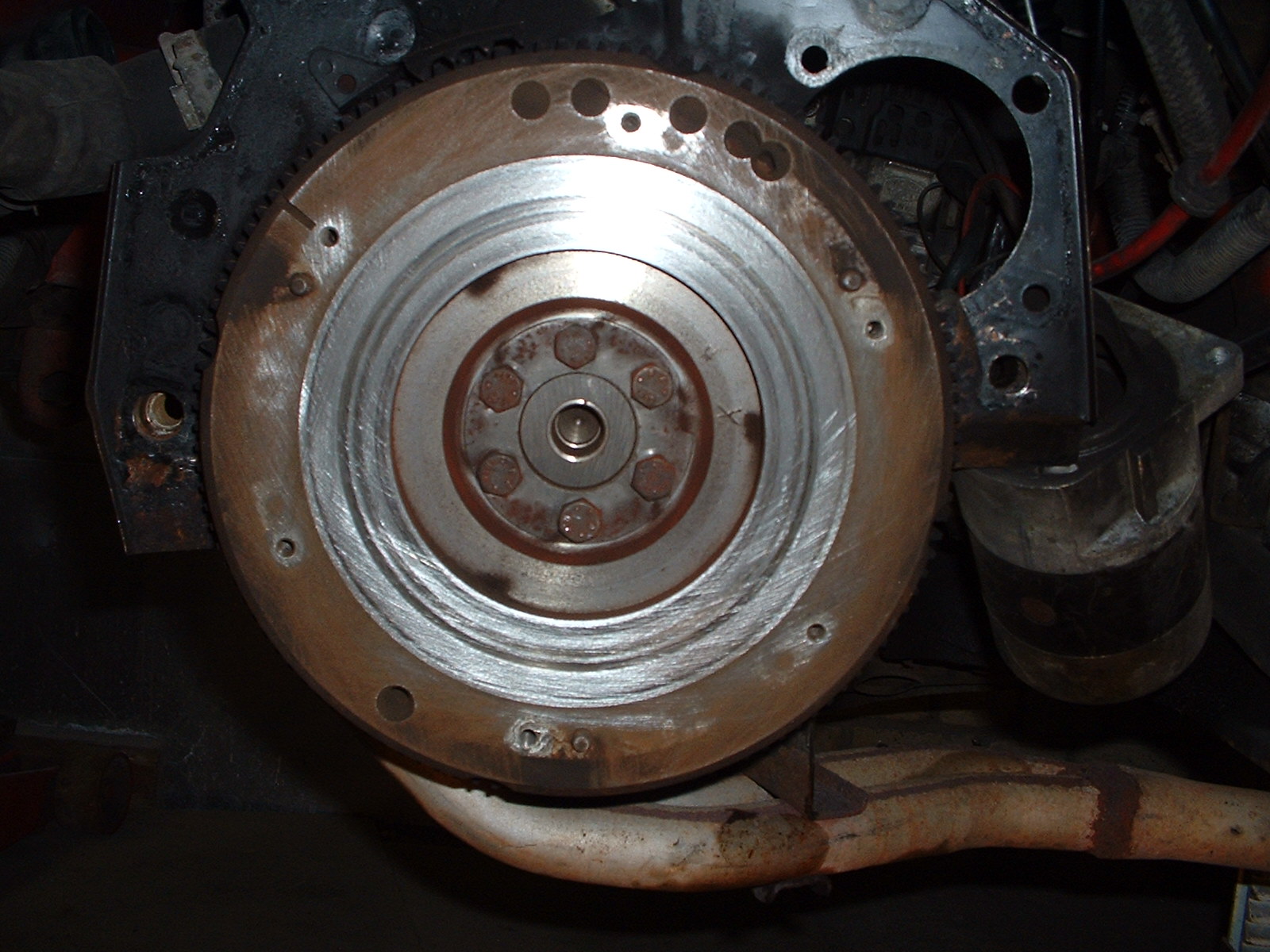

I couldn't find a picture of the clutch friction plate, but these two pictures show my 999cc Uno when I fitted a new clutch to it. One picture shows the flywheel, and where you see shiny metal is actually the diameter of the friction plate. Not very big at all! The other picture shows the clutch pressure plate fitted.
The clutch isn't that big but then again it's 'only' dealing with 45bhp. My old 350 Yamaha YPVS was rated at 59 bhp in comparison!

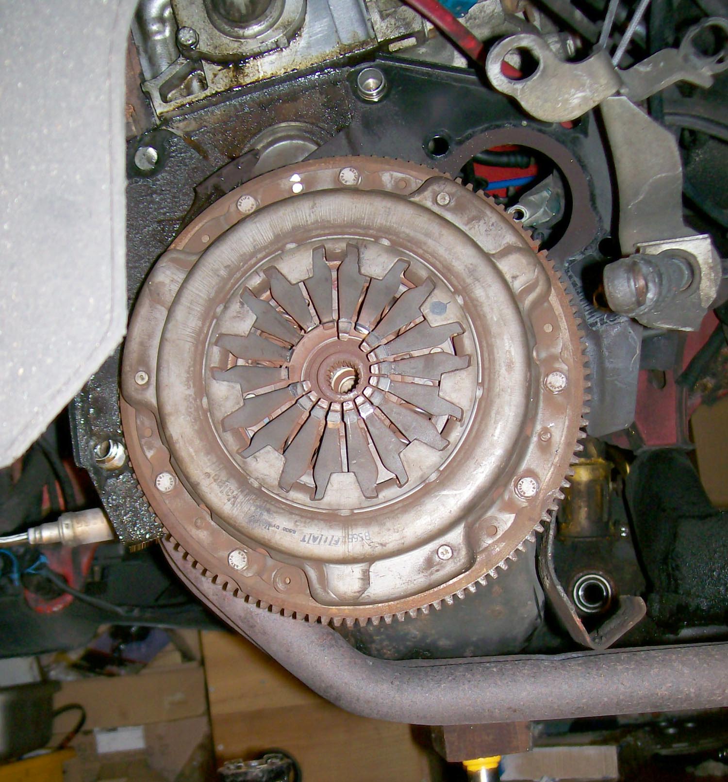

Got the box off today to find I had not much left of the rear engine mount as usual it has turned to black chease. I take it Your not ment to see the release bearing's ball bearings :eek:
The clutch cover has 6 of the 18 fingers missing so I guess that’s why it was rather reluctant.

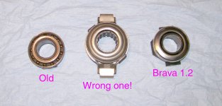

Next I find the wrong bearing is in the clutch kit. As I just happen to have a Brave 1.2 16V clutch kit waiting to be fitted (still :eek:) which odly contains the correct bearing. lucky I thought.. on with the job....

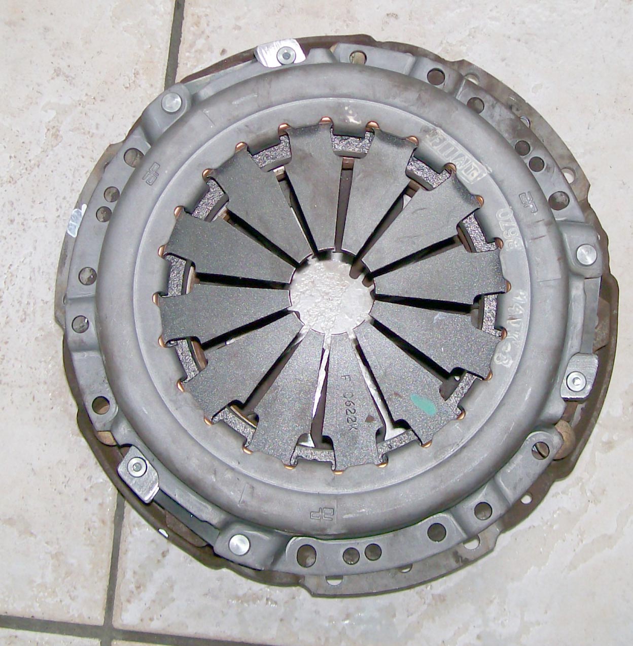

Having removed the cover and pressure plate I notice my new plate has only 3 outer springs but also has 4 smaller springs. The old has just 4 large springs. I thought it may be a design difference as the new kit is an AP where the old is Valio.
It became apparent when I put the 2 clutch covers together that the new cover is slightly smaller than the old. I still tried to line it up on the fly wheel bit there is no way it will fit. Shame the rest of the Brava 1.2 kit is a fair bit bigger.
To answer my own question – :bang: :bang:NO ITS NOT THAT SMALL!!!!! :cry: :cry: :cry: :cry:

Louie, the 'wrong' release bearing you have looks just like the one I had in my clutch kit. It fits fine with the two locating tangs on the release arm on my gearbox. Maybe it's meant for the earlier (bottom rod change) mk1 45 gearbox?
I have found that the part number I have been sent has a typo on it... my kit should end with a 9.. the part number I have ends with an 8- the rest of the numbers are the same so its bad luck it seems :cry:

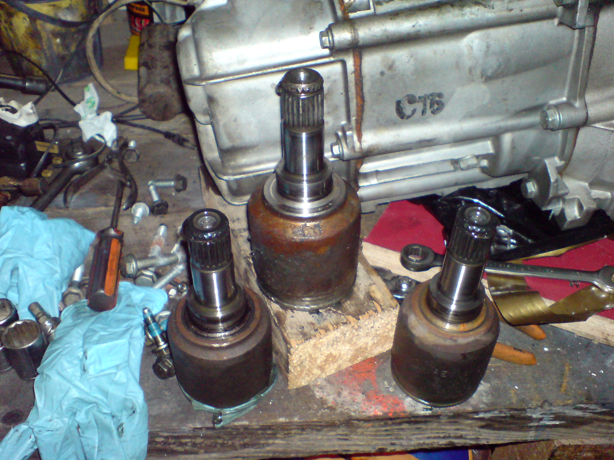

these are the cups i was talking about. These are off a dry box. They spin around and seal the oil in the box. The driveshaft slips into the open end with some grease and the boot clamps onto the cup. It all turns.
If you have this type box, as Emma's will have (in case you ever have to do it), you can remove the inner boot clamp nearest the box. Undo the damper to hub bolts, and wiggle the shafts out and witdraw the box. This leaves all the oil etc in the box and saves removing hub nuts (y)
however by the sounds of it, yours is a wet box in that, the inner boot doesn't turn with the shaft, but is clamped to the bearing on the shaft. the boot retains the oil, and there is no shortcut :(

I haven’t looked under the inner boots but I think they turn with the shaft.
The cups look much like the ends of my shafts. I’ll take a few more pictures before I put it back together.
