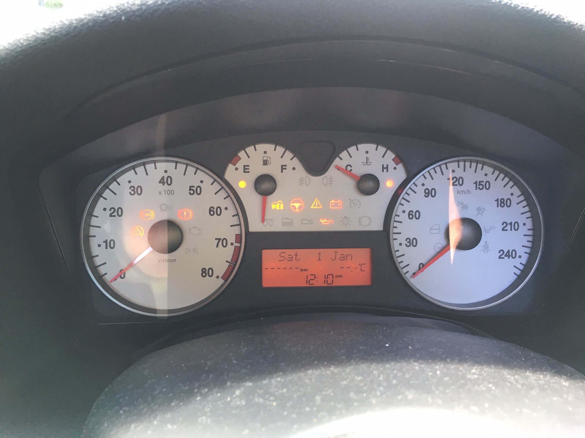

Hi all,
This has still got me beat!
It only happens when either aggressive cornering or going over a big bump. the engine never shuts off always starts and runs great. The dash lights up like a christmas tree (pic attached while running) and dials drop aircon stops and radio, then fairly quickly goes away. Occasionally the ASR and DSP failure messages can remain but normally go out soon after.
here's what I've checked so far...
Grey fuse box and all connectors
Battery terminals and connections and also charge (good condition)
Checked ECU plugs all prongs in good order none sunken etc...
Basic OBD check never has any codes showing?
I have solved it on my stilo.
Disassemble alllll parts of the battery connections, rub them with sandpaper.
Especially the + connection, loosen all bolts, I mean all of them and take photos, you will see what mean .
Elaborate on the 3 bolts under the red cap there
Had this problem on a 1.6
Check all the connection in the battery\fuse box, it worked for me:)
Update - problem is fixed.
It was either a very slightly loose 8m earth bolt on battery strap or the ABS harness.
What I have found is its very tight between the abs plug and the Fuse box with the D4 connectors. What happens is when you lift the fuse box its easy to inadvertently pull the abs plug out slightly and when going over bumps or hard cornering - loose connection + abs messages etc...
