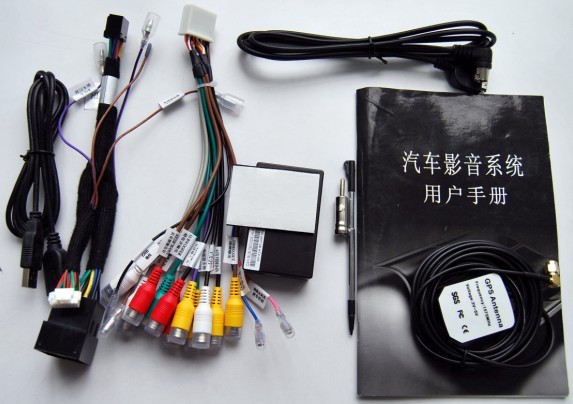

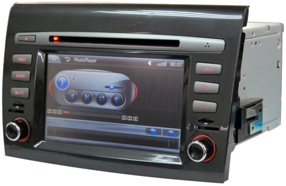

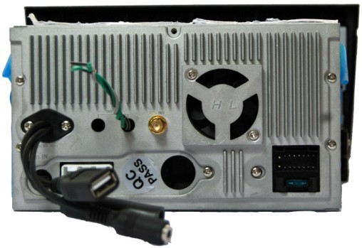

Here are more pictures the manufacturer sent me.
Can anyone familiar with the bravo's HU connectors confirm that this is compatible?

It looks like it'll work but only like a normal 3rd party one would.
It won't be Blue & Me, it won't use the in-built USB socket and, depending further on the connector, I think you would struggle to get reverse, speed sense and parking brake signals.
It is as you said, just a standard HU with a Bravo front to it.
I don't really care about reverse, speed and handbrake signal, I'll get those connected if I want to use the rear camera and TV later. The USB is easy to install and the HU has also a micro SD card port at the front for music and video files, so the USB port is not even a must. (the second micro sd port is for the gps maps)
I have the confirmation from the chinese that this bypasses the blue&me and is not compatible with it but what interests me is if the phone/mute/ buttons on the steering wheel will be detected.
The phone button wouldn't work - this is for blue and me.
The mute button would as this is simply an ATT signal - present in nearly all modern stereo wiring looms.
Accessories:
  • (1) Power cable: 1 harness with CAN-BUS box
  • (2) GPS antenna: 1 piece
  • (3 cable: 1 piece
  • (4) USB cable: 1 piece
  • (5) Remote control: 1 piece
  • (6) User manual: 1 piece (in English)
  • (7) Touch pen: 1 piece WHAT NO FINGER TOCH!!!!!!!!!!!!!
  • (8) Screws for installation: 1 set
  • (9) TV antenna: No ( you need to buy analog antenna additional if you need. please go to page top to choose it in Product Options Dropdown Box.)
I don't know of any touch screens that use pens and don't use fingers...
Just looks like a gimmick to me.
If it needs an analogue TV aerial, it suggests that it only has an analogue TV tuner. TV in the UK switches from analogue to digital only from early next year, so the TV function in it may become redundant then.

It's a resistive touchscreen capable of detecting finger as well as stylus input.
As for the TV, even if it doesn't have Digital TV built in (which I don't know if it has), there's an add-on for that.
resistive touch is slightly better for automotive use, especially in the winter when you wear gloves, resistive will pick that you, capacitive will not
also theres a hand break signal sent to the radio? whats that for? I thought it was just based on speed input from the BC
