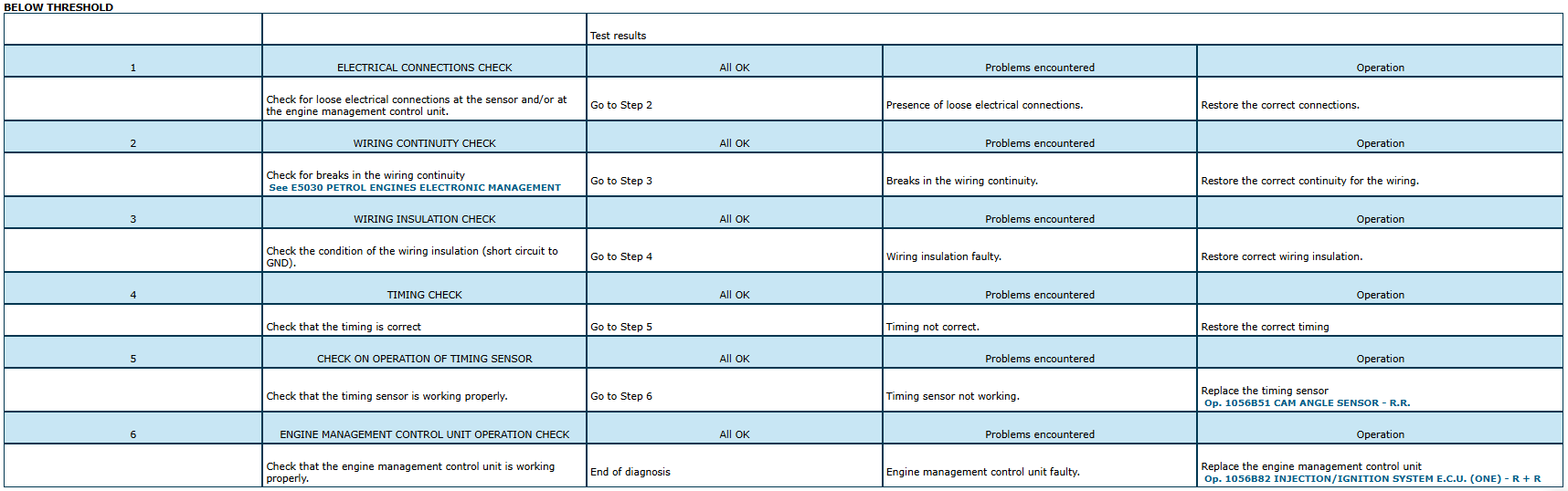

Below the diagnostics procedure taken from FIAT's eLearn module for the above error on the 1,4 T-Jet 90 HP engine:
There are 4 different tables depending on what the error is. The diagnosis is though similar. But I think it's worth to point out that there are two problems that can lead to this fault: an electrical (like a short somewhere; and the fact that the problem appears with heavy gravity load - acceleration or braking might suggest that it could be the case), and a timing problem.

Two eLearn docs attached, the tables reffer to it. I'm adding both EUR4 and EUR5 versions.
It's only a documentation, but might point to a good solution :)
Note that the ELM interface might not be to ideal one. FIATs are best to be diagnosed with MultiEcuScan. However the engine modules should communicate more or less properly with the majority of the pro error readers.
