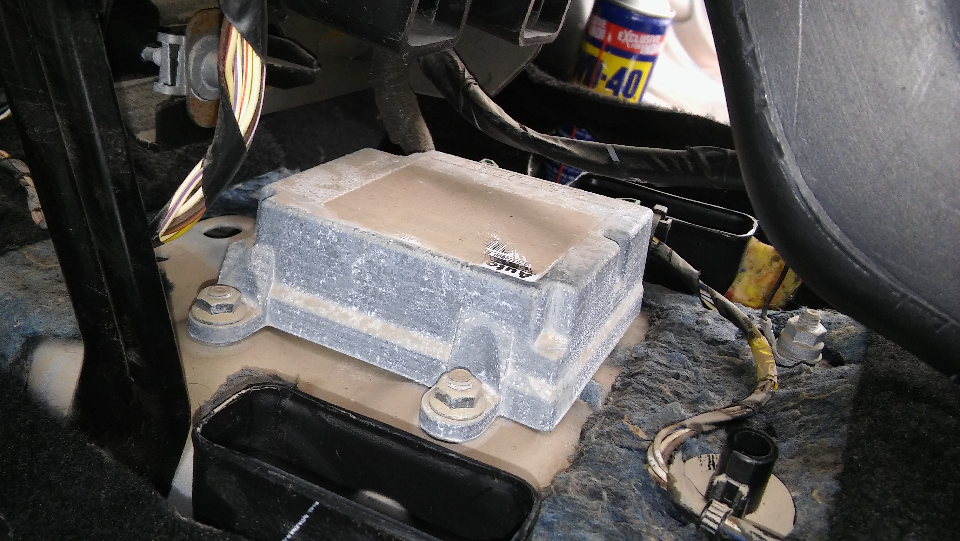

Friends,
Can anybody say where is the actual location of the Airbag sensors in Fiat linea T-jet? It has TWO front airbags. One is on the Steering wheel and second is above glow box in front of the front passenger seat. Its SRS Module is located at the bottom central console just below the audio & A.C. control panel and ahead of gear shifter. Pics attached.
I think the Airbag sensors might be somewhere in front in the engine room under the bonnet, but I am practically unable to locate it. may it be somewhere else too - I am not sure.
Please guide.

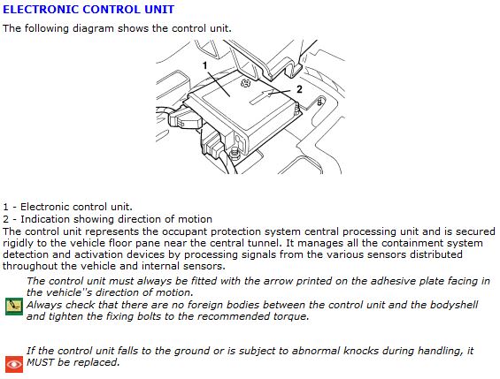

Hi Navin,
the "SRS" you hold in hand is the central airbag's ECU, depending of the trim level your car might be equipped with more satellite sensors, but certainly with the front Early Crash Sensor.
See attached what e-Learn says about those satellites …
BRs, Bernie
