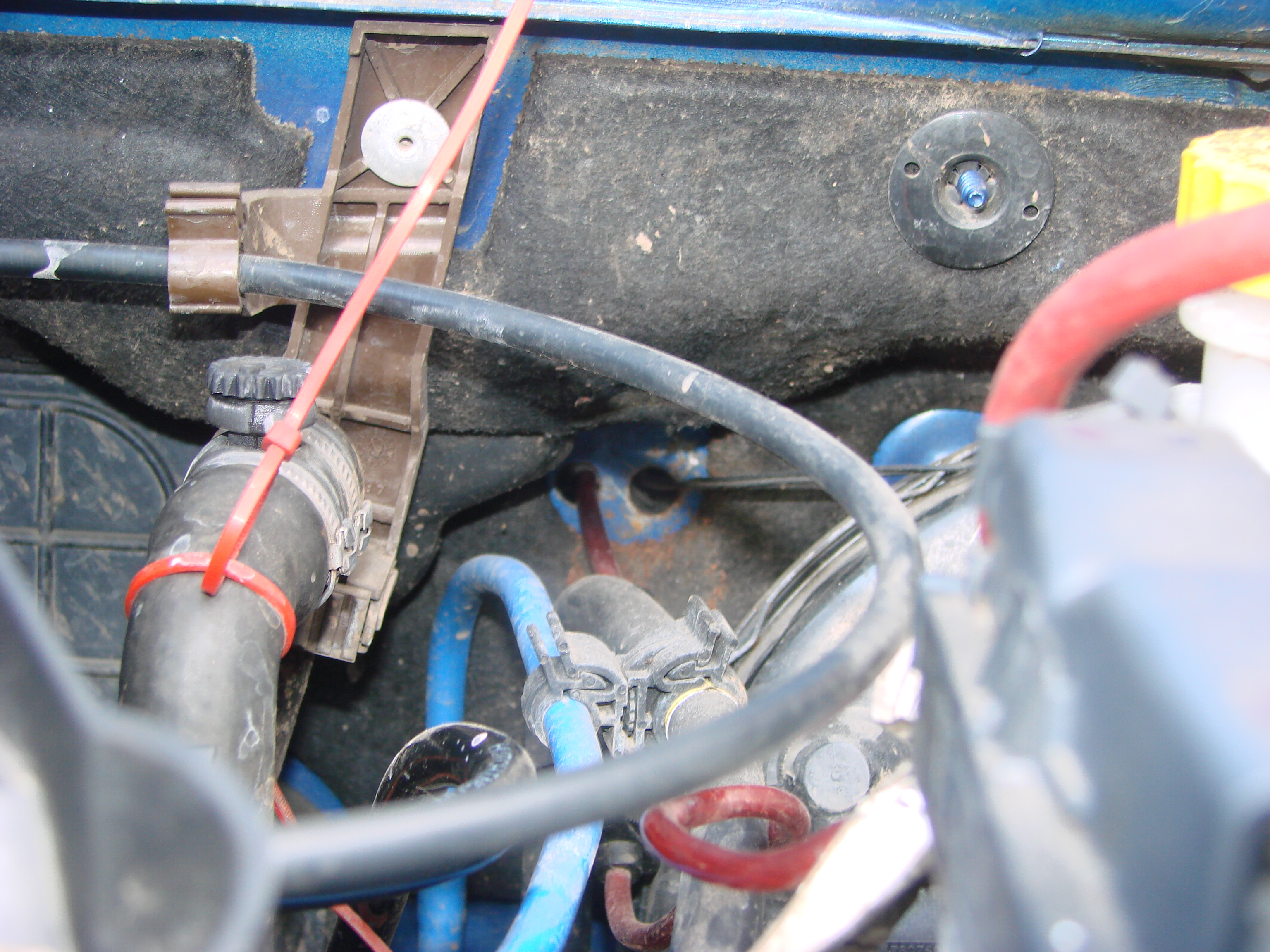

My Panda has one just above the pedals. This is on a danish car, so in the left footwell, about 20-25 cm up.
Hold on, I'll go grab a picture...
EDIT: As you can see from the first picture, it's right above where the accelerator is on a LHD car. If you kind of follow the curve of the center console back on the left side, under the dash, that's where it is. You may have to remove some material below the glove compartment to see it.
The second picture shows where to find it under the bonnet, just follow the red and black wires, they're the power leads for my sub :)
The grommet is right above and to the left of the brake booster.

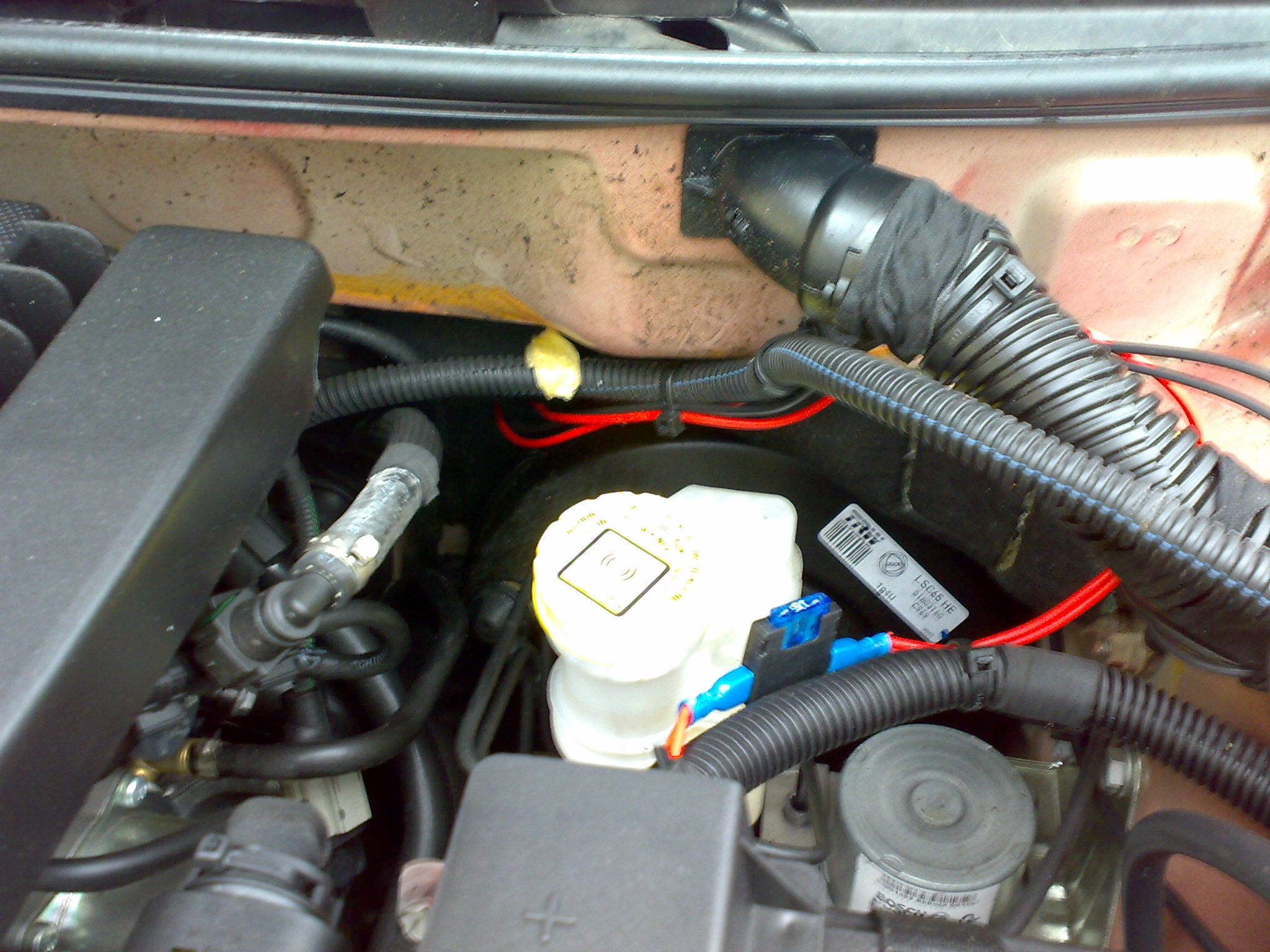

i hav a RHD 2004 panda dynamic, i just drilled a hole in the bulkhead from behind the battery into the passengers footwell and got a grommit from halfords.
I'll post a pic for you.
OK guys took the plunge today and drilled a hole. I removed the plastic bit at the bottom of the windscreen (whatever its called) which was easy as its only held on with 3 screws and a number of clips which slide onto the bottom of the windscreen. I also removed the wipers which are only held on with a nut each under the plastic covers so i could completely lift of the plastic. You need to let the bonnet down slightly to release the plastic completely - be careful as the washer jets are connected on the bottom of this (you can detach the pipe before removal - it attaches at the front of the plastic on the driver side and is black). Then i simply drilled a pilot hole were i roughly wanted the wire to come through on the other side. The first attempt wasnt a success as i think there was a weld where i was drilling but the second time i went straight through. I checked i was happy with the location of the hole and that i wasnt going to drill into anything then made the hole the correct size for my grommet. I just used the one that came with my wiring kit which is not much bigger than the cable itself. Routed the cable down the main wiring channel on the left hand side which was really easy as the 2 peices of trim are only held on with 1 screw each. Audio cabling runs down the centre under the carpet (which required a wire coathanger to get it under) and comes up under the odments tray/power socket. The central trim around the gearstick is only held on with 4 nuts btw. Then put a cut into the carpet on the left hand side to hide the wires as they came out under the passenger seat. I used the rear most bolt of the centre trim as my grounding point after sanding a bit of the paint off. Quite a straight forward job really and no harder than changing the speakers on the panda. Most time consuming bit was feeding the wires under the carpet and drilling the hole. Really pleased with the result but next step is to sort out some more deadening on the doors and improve my speaker mounts.
Just left of the brake servo.
It comes thru to the right of the heater blower in the N/S footwell
i did hav 2 cables (2 amps) but took the sub out to put in other car
Cheers ScottishGuy. Thats where i was originally gonna go thru - the missing insulation makes it stand out as a good spot lol. Went much further up in the end which meant taking bits off but im really pleased with the result. Will try get pics up when i find my camera!

In the case of my car, the rubber grommet was already there. I just poked a small hole in it with a screwdriver and pushed the wires through.
