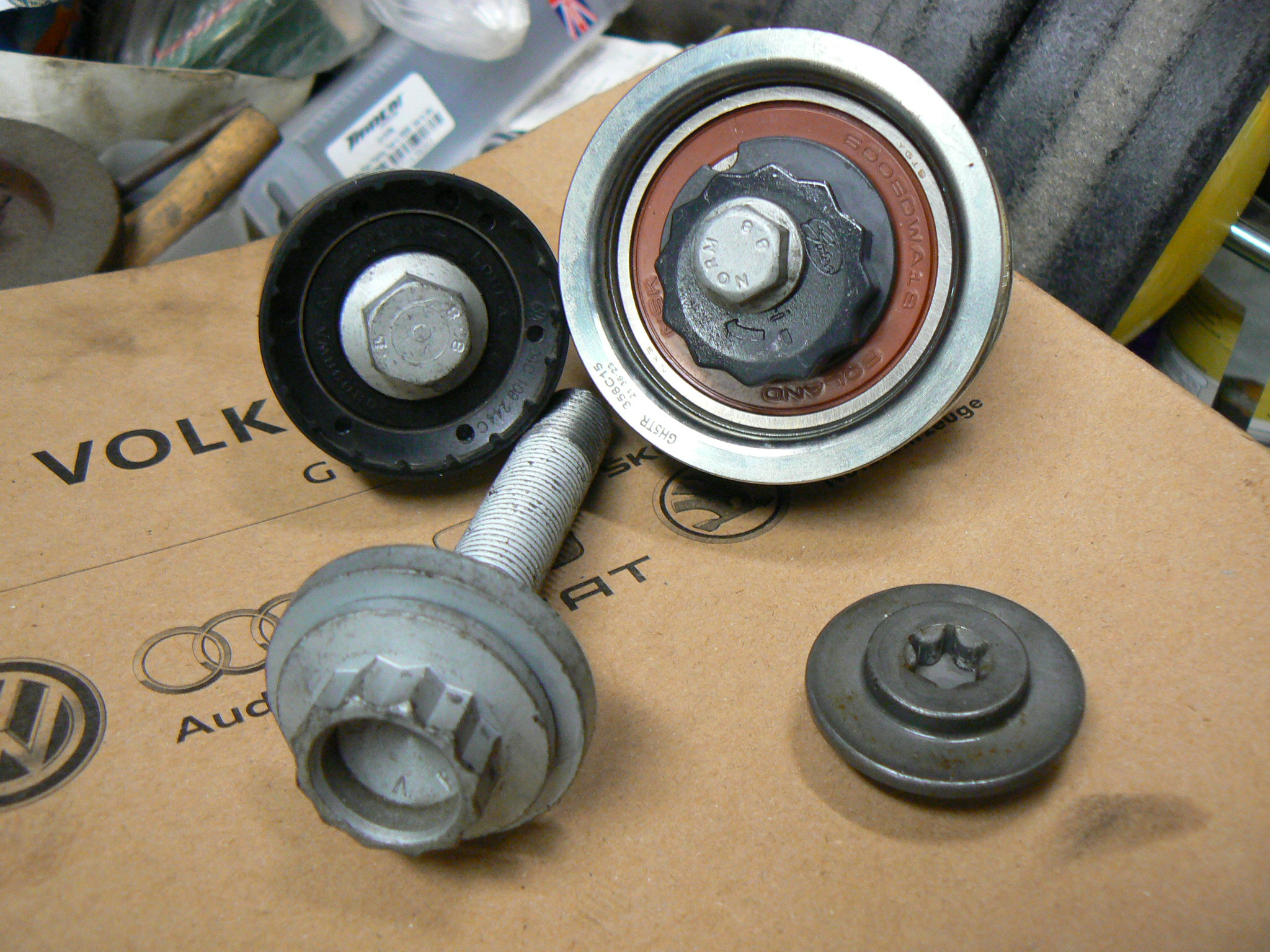

I'd asked them to leave me all the parts removed so I could examine them later - so now for the post mortem. I wasn't surprised to see the spark plugs looked as if they would have gone on for a lot longer - they had only done just over 22,000 miles but at 5+ years old I don't regret changing them and it may make life easier for the coils. So now lets look at the main event, the timing belt. (I am pleased to see the box the bits are in is a genuine VW parts box which obviously had contained the new belt kit) the tensioner and idler both spin smoothly, are not leaking grease and look undamaged so I'm sure would have been good for many thousand of miles more and I was impressed to see the tensioner is an all metal assembly, wonder why they didn't do the same with the idler especially considering the Main Dealer tells me the belt can be a "lifetime fitment". Here's a pic of the rollers and also the very large crankshaft bolt which has to be renewed as it's a use once stretch bolt. Has to be slackened as all the pulleys on this engine are unkeyed.
You can also see the VVT cam sprocket blanking plug which has an oil sealing ring on the other, threaded, side so they like to replace it to avoid leaks. So what's this "lifetime fitment" rubbish all about? Well, I was told by the main dealer that there is no mandatory recommended change interval on the timing belt on these engines. It gets examined at certain intervals (I can't remember what they said the intervals were as I immediately decided that wasn't for me) and only changed if it needs to be. There is a top belt cover which looks as if it could be removed to let you see the cam sprockets and a short run of the belt. Then you'd have to slowly, very slowly if you are doing a worthwhile examination of the belt, turn the engine over and examine the entire run of the belt for wear and damage. I just can't imagine too many workshops actually doing that? Also, in common with a lot of engines these days, many of the engine components, pistons, con rods etc, are pretty light weight to reduce reciprocal and frictional forces to get better fuel consumption and reduce pollution but this makes them less tolerant of abuse so I think a broken cam belt would spell the end for the engine. The cams are a bit different too with roller bearings behind the sprockets rather than plain bushed bearings again to reduce friction. I wouldn't fancy applying any large shocking forces to them, the rollers are definitely what you'd call "needles".

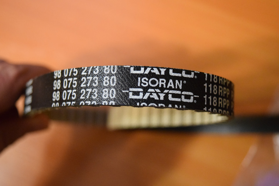

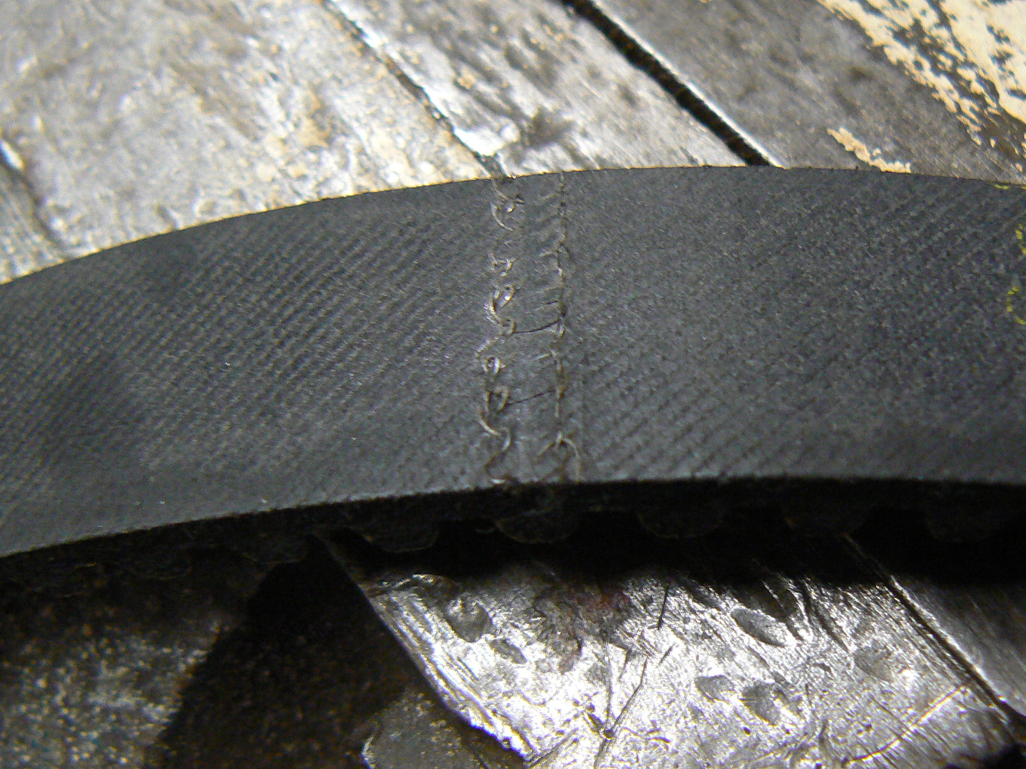

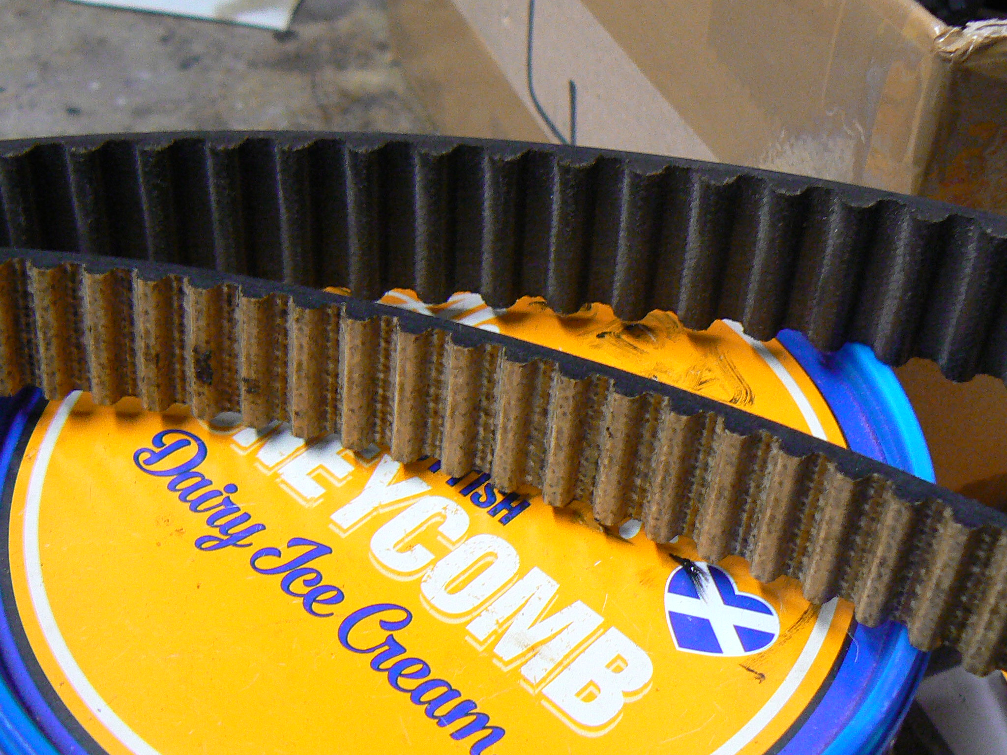

Next I pulled the old cam belt out of the box and got a bit of a surprise - It's a Dayco, says it right there on the belt! I've changed a fair number of Skoda and SEAT belts and, if it's the first change since new, the belts are always VW branded, so what's with the Dayco? I bought this car new so I know this is the first change. Ah well. - Then, almost as soon as I started looking at it I saw this:
Boy am I glad I decided to renew this belt! I can't see anything which might have caused this damage. The tensioner and idler are as smooth as you like and the belt guards are close fitting and undamaged - it's a mystery. If you enlarge the image a bit you can clearly see that there are "hairy" threads pulling out of the surface of the belt. I don't think these are the main cords which give the belt it's strength but I really don't like the look of it and I'm glad it's been replaced. Would the main Dealer ever have found this on a quick cursory examination? I kind of doubt it unless the engine stopped with this bit of belt right at the top. So, "lifetime fitment" belts? Naw, I don't think so! In fact, as far as cars are concerned, "Lifetime or extended interval anything", especially gearbox lube? Naw, I know not so!
By the way, one last observation that I've long wondered about but never put much energy into finding out. Why do Dayco Timing belts - and, as far as I know, only Dayco timing belts, have white coloured teeth? Here's a pic of the old belt alongside a Gates belt I recently changed on one of the other family cars:
Anybody know? By the way, I'm doubly mystified by the condition of this belt as, although I would choose a Gates if available, I've used Dayco before and had no problems at all. Wouldn't really expect what I saw at 20,000 miles, must be external damage somehow but I can't figure out how unless the belt was somehow damaged during removal? in which case I hope the new one was put on with greater care? naw Jock. these guys know what they are doing, it'll be fine! Still, maybe I'll just take that top cover off and give the engine a slow turn over?
Looks very similar to this...
This is the old style Cam belt for PSA puretech engine.
They've recalled these now as they had a nasty habit of disintegration.
New style ones are an entirely different texture and look (best described as looking more like liquorice with a smooth black texture) very different.
The 'damage' may well not be damage, just where the 'join' is, as said above. The teeth all look good, so perhaps good for some time yet, but, like you, I don't like the idea of a lifetime belt. I'd read somewhere that they should be changed at 7 years, which for my Fabia will be January, so I'll see then what my local specialist says.
I'm intrigued that it is a Dayco belt, but the old tensioner has a Gates logo on it. I suppose VW will dual-source as much as possible, and yours got a mix. Both good brands, so no worries there.
Absolutely chris. I read somewhere a wee while ago that these "wet" belts were shedding fibers which then clogged up the pickup screen! I also came across a you tube video showing someone fitting a conversion kit for the 1.8 Ford diesel which changes it over to a chain drive. i wouldn't feel confident buying a "wet belt" engine.

Have to say that at this time I'd not be buying a Dayco belt - even though they are a massive player in this field - Think I'll just stick with my trusted Gates products which I've been using "forever".
As pb says its a join in the fabric covering on the outside of the belt not damage . I saw the join an info sheet from one of the major belt manufacturers on the www.

Thanks Jack and all. I've been right into the "backside" of this as much as I can and learned a little more about these belts than I previously knew.
If I've understood correctly, the strength of the belt comes from a continuous thread, glass fibre/kevlar etc, in the middle of the belt. It's wound round and round the length of the belt in one continuous spiral length with no breaks. On the inside of this band of structural thread is the tooth form which has a protective layer on top to shield it from contact with the teeth and make it last longer. That's the white layer on the Dayco belt - which I think is patented?
Now for the bit that's mainly interesting me just now. Right round the outside of the belt is a layer of material which protects the belt's structural cords from the tensioner and idler pulleys pressing/running against it. As I understand it the whole structure is hot vulcanised, like a car tyre, so bonding all the parts together. The outer layer contributes little to the strength of the belt, so is subject to little tensional force, it's there to protect. I believe, on the Dayco belt the ends of this band are sewn together (a "basted" joint?) before the belt component parts are assembled - I'd guess just to make assembly easier? Then it all amalgamates together into a homogeneous whole during the vulcanizing process? If I'm right then these threads breaking whilst in service would have absolutely no effect on belt strength? I'm guessing that other manufacturers, whilst using very similar construction, don't sew the outer band ends together, maybe just relying on accurate alignment of the parts in the mold before vulcanising? - Which would explain why I can't see any joints in the dozen or so belts hanging on a nail in my workshop right now! (mostly Gates, but 2 FIAT and 3 FORD branded belts - no Dayco though)
Anyway, I've fired off quite a lengthy note to Dayco asking all about what I've observed. If they reply I'll be back with any relevant info for you all.

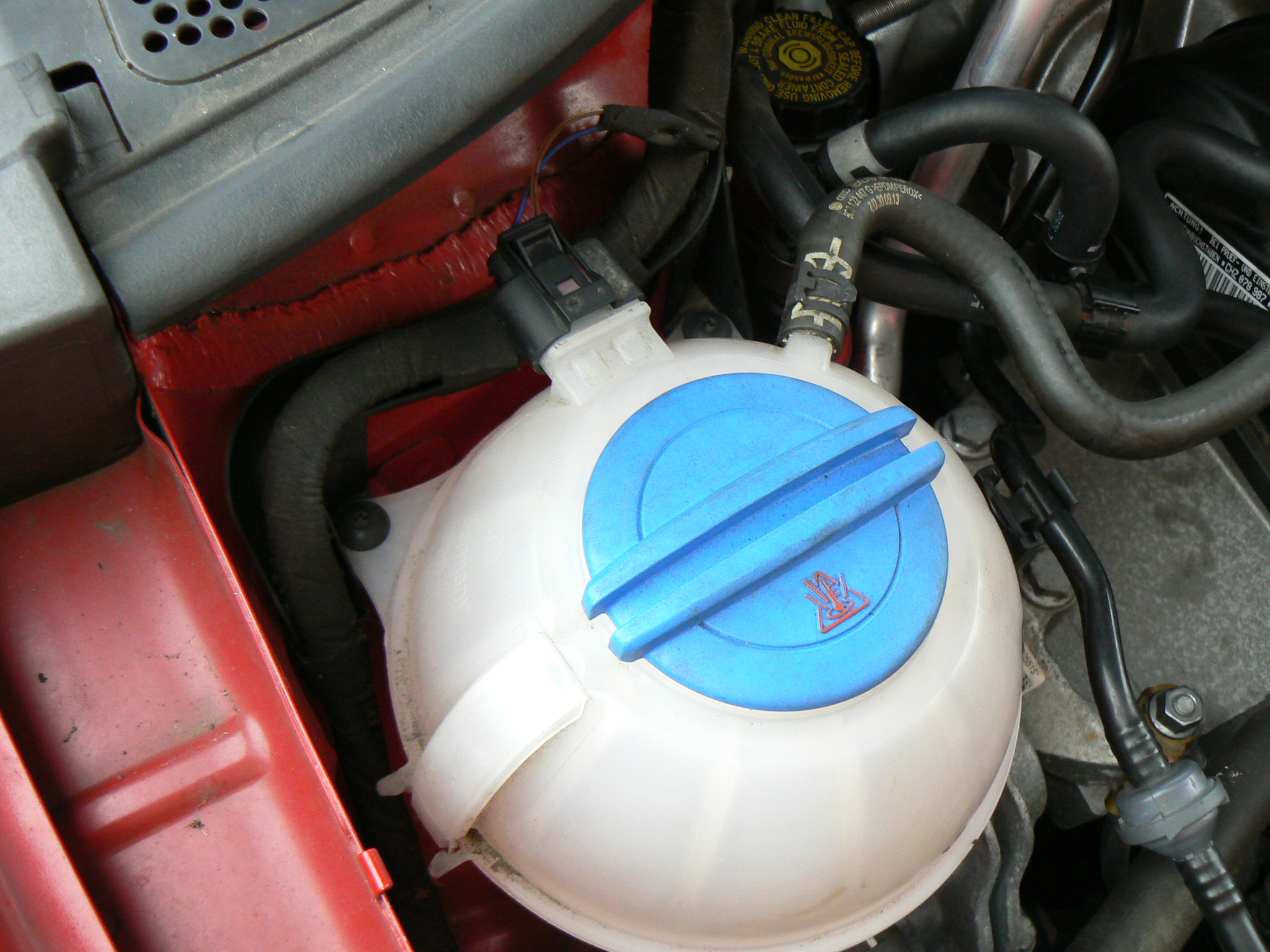

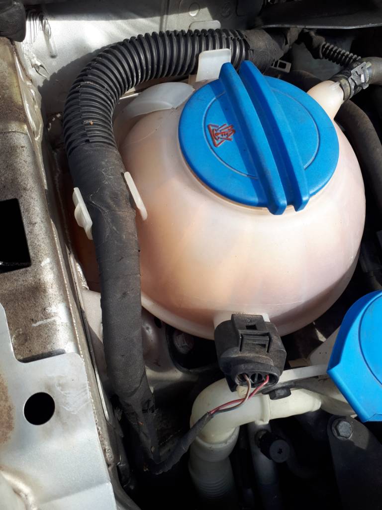

Pics of vag sensor wiring and prongs in header/expansion tank20210913_105840.jpeg20210913_105901.jpeg
Pics of vag sensor wiring and prongs in header/expansion tankView attachment 220241View attachment 220242

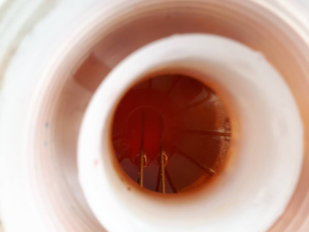

Thanks Jack. Just went out and had a look at mine:
Halleluja, looks like I've got one! It's the black plug at the back of the tank. Looking inside the tank I can see the two probes extending vertically downwards but didn't come out well on a picture. Just need to identify which of the dash lights identifies it now.
Just googled it and I see it looks like a wee thermometer floating in some coolant. Also it displays a written warning on the wee mini panel between the dials. Level has never budged since she was new so presumably Ok. I would hope she needs to get a few more miles on her and a bit more "geriatric" before these sort of problems start kicking in but nice to know she's got this wee feature.
With ingnition on, unplug the sensor connector at coolant tank to trigger warning system.
You will then know for sure what warning you will see/ hear/ read.
