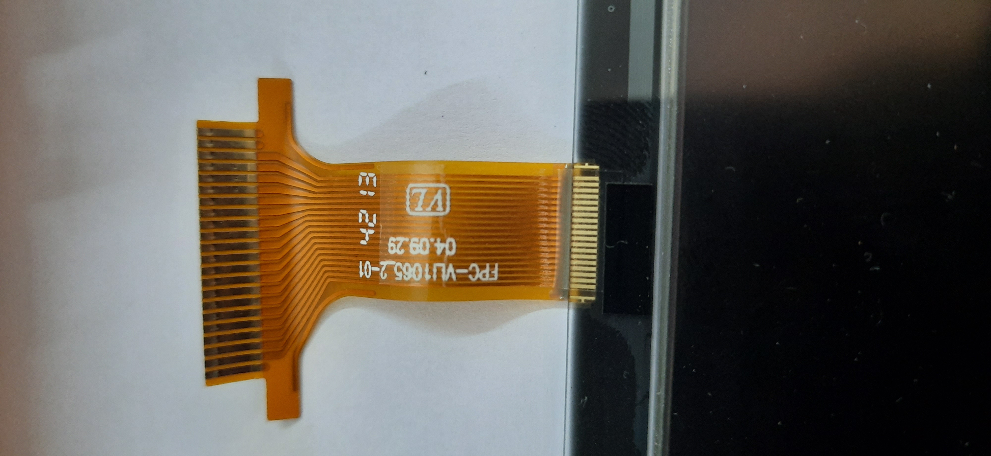

Dear friends,
My car is Fiat Linea T-Jet Emotion (Model:FL-2014 India).
During this monsoon, the lcd display panel at the center on the dash stop showing data of Km, date, speed, time, etc. all of a sudden during one ongoing trip. It just glows the hazy yellow light while opening the door and engine ON condition. All other meters of speed, fuel, heat/temp, odor, etc works properly and ok. Only the central Digital Display is not working.
1. Is this central Digital Display LCD panel available? Please show me the source of it.
2. How to replace it by DIY?
Regards to all.
Navin Talati /12-12-2020

I am updating the matter related to "LCD Display panel required -Linea T-Jet FL2014 India". I opened the meter console and have taken pics of that. Actually what I need is the LCD Panel which is located in-between Speedometer and Odometer.

I don't think individual parts of the instrument cluster are available from Fiat, only the complete module. For example: https://www.fiatdalys.lt/en/catalog/parts/555/10/0/1/3S/0/0/CC1.4/CMBBZ/GDX/operation-indicators-
Additionally, I think the instrument cluster must be programmed to the ECU (for correct milage display, etc) so replacing the whole unit is not a straightforward replacement. If you can't find the LCD module on its own, you could buy a whole instrument cluster from a scrap car and take its LCD out and put it in your own. That way, you shouldn't need to do any programming. If you did need to do the programming, you could look to see if MultiECUScan supports that function.
So you didn't ask Fiat for advice? It is an unusual failure and I believe many car manufacturers might compensate on the cost. This time as you have already opened the whole thing, its warranty is void.
Can someone help to procure the LCD Display screen (with the same specification) from anywhere?

Dear J4MT,
I am still unable to manage for the LCD display screen for my Fiat Linea (2014 India model). I also contacted the Kava Automobile as per your previous post but they have shown their inability for the same.

Where do you reside? Please send Kava pictures of your LCD rectangular display. Also mention the maker, model and year. I know of Kava in south Mumbai who at that time had the same in stock and he had quite a few pieces. he does test the display before he sells it to you. Another place you can check out is Chore Bazaar, as I procrure some of my accessories from the bazaar. This is near Do Taki. I know the shop that sells accessories for FIAT.
