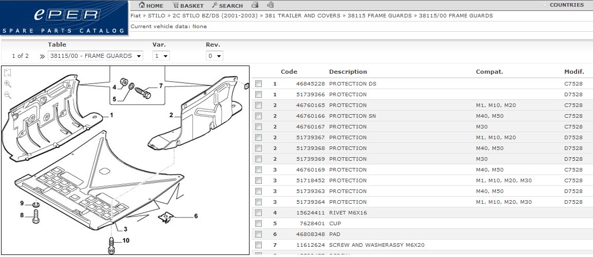

I jacked the car up and found that the plastic that had dropped down was a rectangular piece that sits along the underside of the car from the front bumper back to where the wheel arch ends. There was a missing screw. I dont have one that size so I have improvised with some wire for now. The thing is, there is one on the other side the same size but nothing sitting between them. I am guessing this engine shelf that you are talking about is supposed to be in the middle? I can see the engine and my shiny new gearbox from the underside of the car.
I went and checked my sons car expecting to see something there that isnt on mine and his is exactly the same. So do we both have missing engine under trays?

Many of the cheaper models (1.2, 1.4 etc) never had under-trays in the 1st place although to add some confusion I think at least some of the very earliest did.
The side trays (your problem by the sound of it) were fitted to ALL models
Thanks Argo, I just called the place that did my gearbox to see if they had forgotten to put it back on but they said there wasnt one. However they did tell me to take it back and they would secure the loose bit (side tray).
The complete undertray is made up of 3 seperate parts. A curved section on each side screwed to the car body and a flat section screwed at the front below the bumper and also screwed to both of the side curved sections. It sounds as though you only have the right hand (driver's side) and middle sections.
If you need to buy any new sections, all 3 sections were modified during February 2004 and the individual sections currently available from from Fiat will not fit onto earlier sections. Fiat's solution to this is that if you need any one section for a pre February 2004 car, you have to buy all 3. The right hand section is about £55. The left hand section is about £35 and the center section is about £120.
If you choose to get any individual sections from a breakers, they would need to be from a car that is the same side of the modification date (Feb 2004) as your car. There are also different versions for different engines. 1.2, 1.4, 1.6 and 1.8 are the same but 1.9 and 2.4 are both different.

Thanks for that info Davren. I actually have the two side pieces but nothing in the middle, same on my sons car. I will make sure the side parts are secure but aside from that I will leave it. I have spent in the region of £1000 on this car since buying it in June and I have the MOT coming up in December. If its not an essential or a legal requirement its not going to get done. I have way too many other expenses right now.

Only problem with not having them is that there's a slight chance that road debris could get into the auxilliary drive belt. If that belt broke, bits of it could get into the timing belt and cause that to break.
Hopefully it's only a slight chance, because my center section has been missing since I bought the car 2½ years ago. :eek:
As someone already mentioned, not all Stilos have the whole area protected by a cover. As your car, FionaB, is an early model (non-facelift) & not a diesel (which more often seem to have covers) i would bet it never had a cover over the middle section. I presume the fitment of the covers is engine and/or age-dependant and not dependant on trim level (Active, Dynamic etc).
With even something like engine covers varying so greatly in design and presence on Stilos, it's no wonder the car nearly made Fiat go under - they must've spent a fortune will all these different parts (gearboxes & headlights are another minefield that springs to mind). :rolleyes:

Hi i have sourced them under trays and soon will have them for sale complete 3 pcs set at circa £85 + PP just wondering if any of u guys here will be interested as i can see many of them is missing on our cars.
