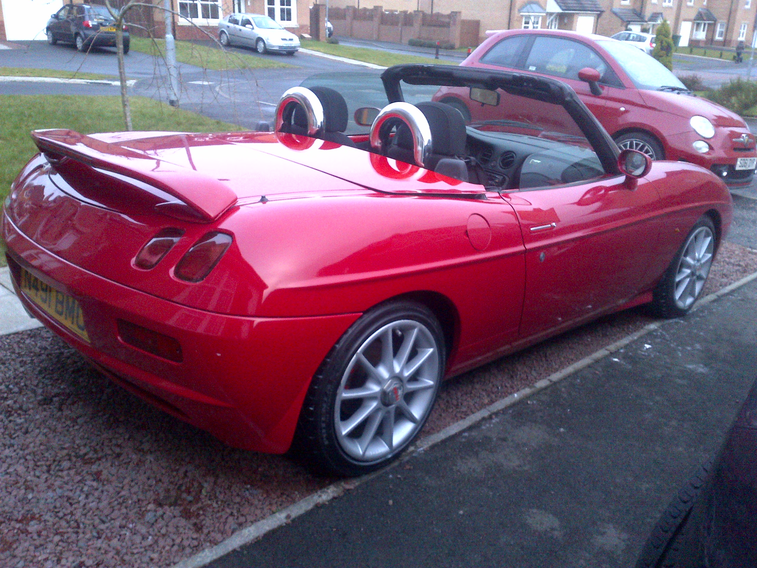

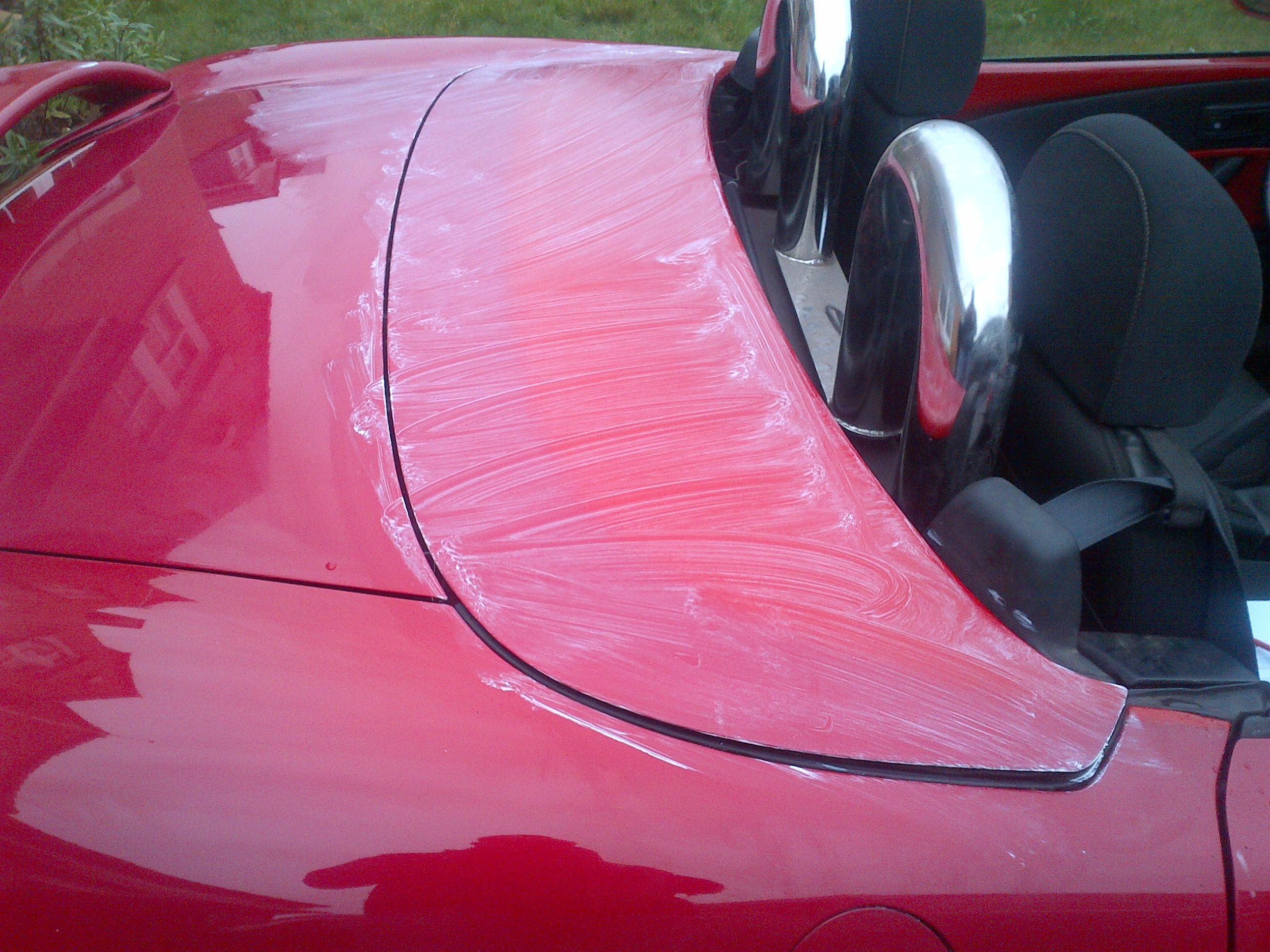

Spent a few hours this afternoon trying to get the colour back to its former glory
This is the result
Reasonably happy with the result but still a long way from the original colour. This is most evident on the panel that covers the soft top when it is down.
I have only compounded it by hand at the moment but might need to dust off the mechanical polisher.
Any advice would be great.
Thanks
Dave

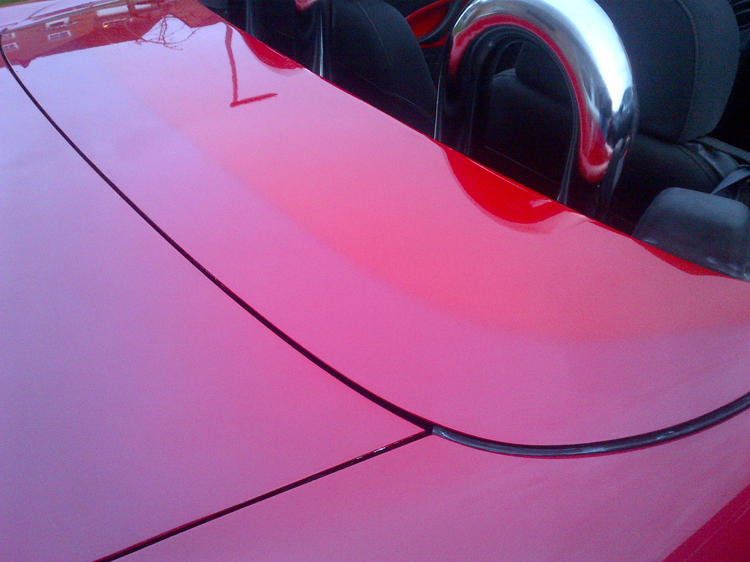

This is the result
Thanks
Dave
Dave,
Looking much better, but oxidised /faded paintwork can only really pop back by machine polishing unless you want to develop some serious hand /arm muscles. :D
Morning kc3,cpuld you recommend a machine polisher?and morning Dave,I am enjoying looking at your photo's,especially as I won't be seeing my car until tomorrow,again.
I use a Flex3401, which is a forced rotation Dual action polisher, Its generally safe to use on most paints with a small learning curve, also have a Rupes rotary and also a smaller DA6pro Dual action polisher I use to glaze paint.
My favorite is the Flex.
Although there is a new DA machine and polishing system from Rupes called the big foot which is getting rave reviews amongst the detailing world.

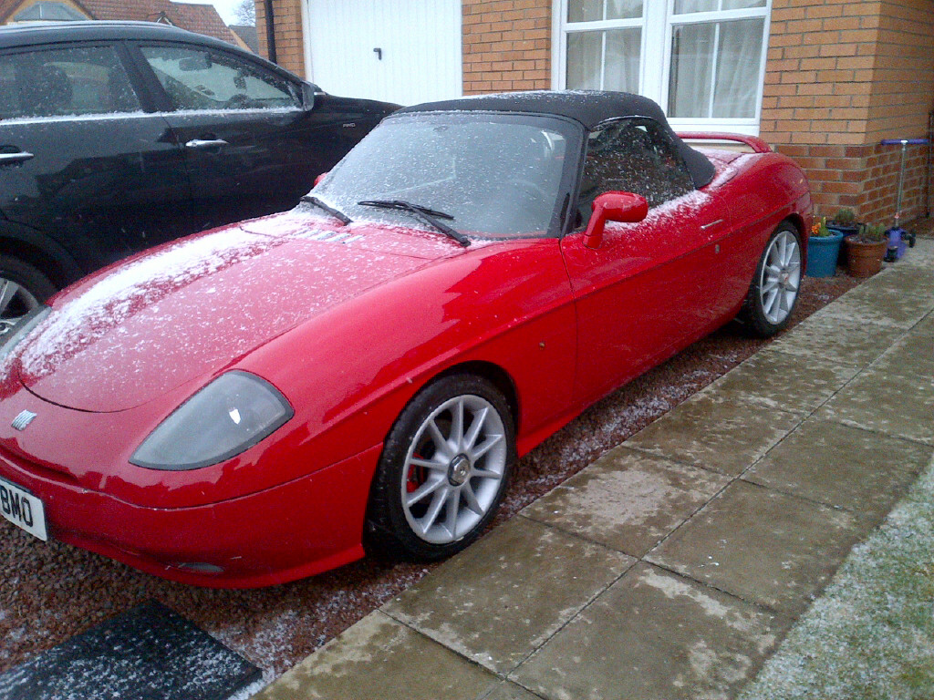

In the snow yesterday, I managed to test the traction control without putting too much strain on the drive train. Basically, it doesn't work. Tried all of the settings but the wheels would spin with no hint of power being cut to the engine.
However later in the day, whilst on the M8, she developed a misfire! If you imagine the sound a Subaru Boxer engine makes, that was what she sounded like. So back to the garage for some more head scratching.
The plan is to take the Racelogic system out of the equation as it isn't functioning to see if that improves the situation and also make sure all the earths are ok.
With it being -7 in Glasgow yesterday, the power steering pump was making one hell of a noise so they are going to give that the once over too.
I was hoping that the to do list was getting shorted not longer.....
