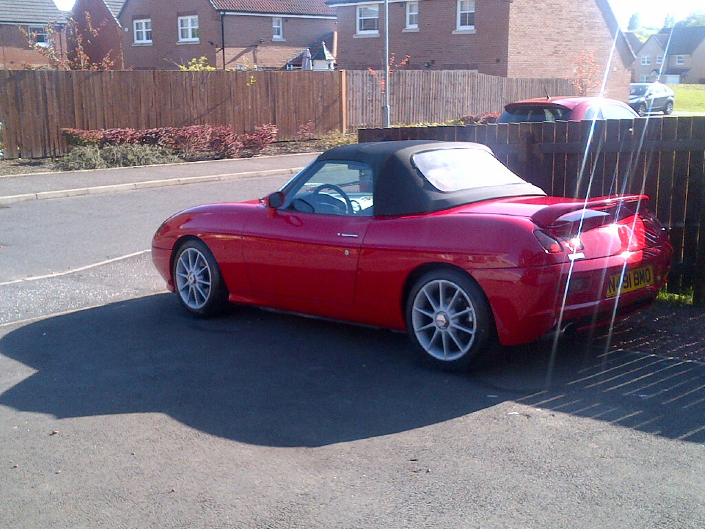

I got the Barchetta back a couple of weeks ago. Running really nice with the head rebuild with new valve stem oil seals, one valve guide replaced and the original cams installed. No more lumpy idle or flat spots. Pulls like a train with a nice exhaust note

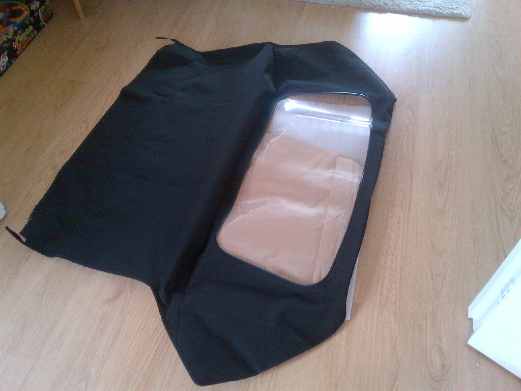

On my way back from the garage i took it to the car wash. One of the ones were three guys do all the hard work whilst you sit in the warm and dry. Well not that dry given that the hood has still to be replaced

With all the mechanical issues I almost forgot to say that it needs a full respray as the paint is too far gone to be brought back to life.
