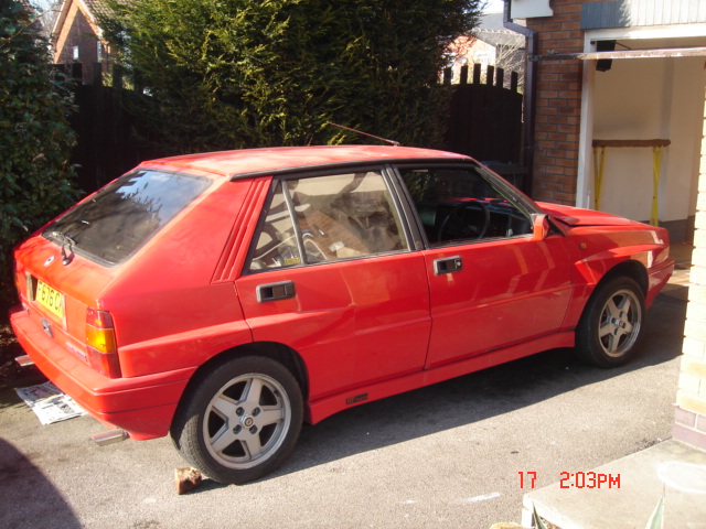

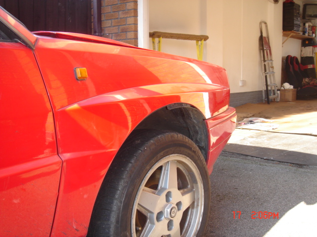

Go for it feller!! ive just bought my dream car, an integrale!! that needs quite a bit of tlc, I aint scared, and have kept a promise i made to myself! hey beardy i'l take you for a spin in her seeing as tho your a mancunian ha ha Ant!

integrales were only ever built as LHD, there were a few converted by John Whalley or Mike Spence IIRC at great expense when either new or near new.
The cosmetics i.e dash board etc are from RHD models but were the purity is lost is in the mechanical changes.
integrales are often cited as having just about the best steering in terms of feel, feedback & directness of it, whereas on RHD conversions they used the rack from a Fiat Regata which meant there was an extra turn lock to lock and a loss of feel, tho many are prepared to accept this to drive on the correct side for this country. There is also mean to be a little change in brake peddle feel, though having never driven a RHD one can't really comment only go on what has been written on the owners forums.

eagle eye chas!!! yes it was converted from new 1 of 20 i believe, and ive got the letter from lancia voiding the warranty from 3k ha ha, i would of had a left hooker no probs but a bit of a bonus it being r/h i suppose as the misses can take for spin and not bash it in lol, and i can safely thrash it around anything in my path, FRAAAPPPP!!!! just sourcing parts at the mo as am going to run 16v loom with 3 bar map sensor, got strut braces new oe shocks with eibach springs, intercooler mod, g/s flowed head and performance cams, stainless pipe, uprated breathing system, new roof panel, 2 front doors and tailgate, just need some correct wheels and rear spoiler, and maybe sills which i cant find, only from autointegral, which are hand made no oe, but prob repair them as not to bad would of been ok if previous repairers hadn't jacked the fook outa them, straighten them and plate them,, going to start very soon, just been busy getting all my jobs done on the golf and UT,, did all my rubbers on the front of g2 on sat arb's tca's etc Ant!
The 16V integrals run two map sensors 2bar and 3bar as standard so if running 16V loom you will end up with wiring for both so may need both.
Rear spoiler only fitted to EVo models as standard as it actually reduces the cd back to the same as the narrower 8/16V models compensating for the increased width and frontal area.
Genuine 2nd hand adjustable aluminum spoilers are very expensive now, I've seen them go for £300+ but bargains as always do pop up. There are grp one piece fixed spoilers but mean to sag and not be that nice, there are also carbon fiber ones from Enrico the guy who runs http://www.scara73.it/ very easy to deal with, and all his parts are meant to be pretty good.
