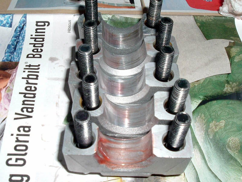

I have got only about 15 8v FIRE heads in my garage and none of them has got bearing shells or any other kind of bearing. Neither had the ones that I modified nor any I ever have seen on any car. And noone in the factaory where they are being produced has seen any bearings in them either, because they haven't.
It is common practise for heads to be just line bored without having any shells.

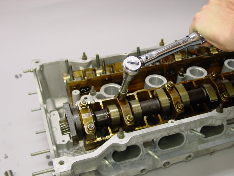

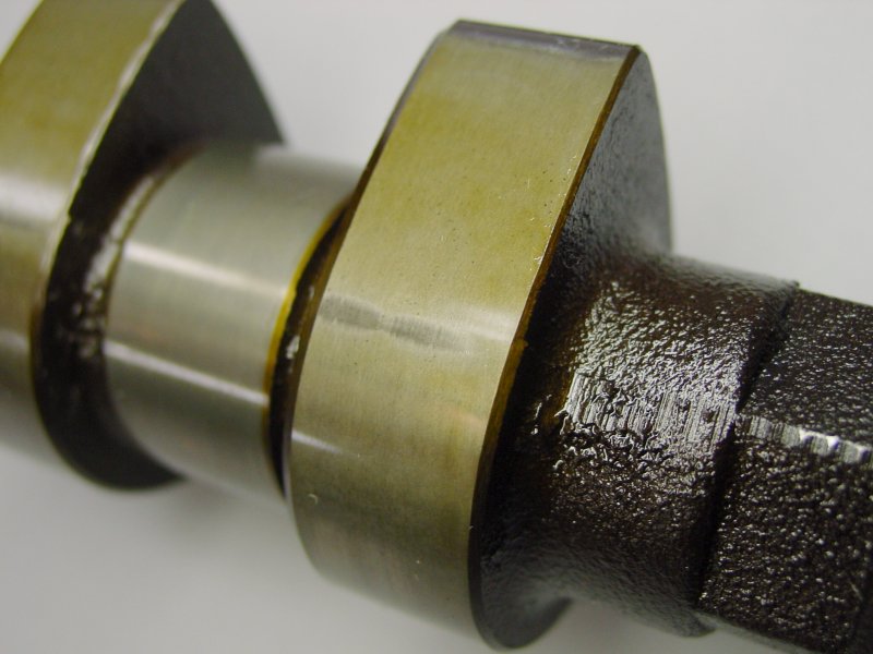

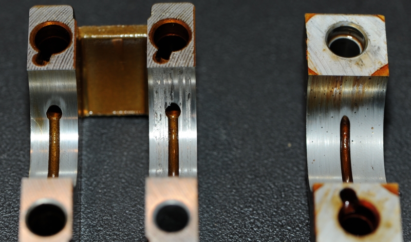

Cam caps are properly known as camshaft bearing caps.
Ok when the camshaft is placed in the cylinder head the camshaft caps hold it in place to the head. There are machined parts of the head, the camshaft and the caps as well - there are no bearing shells if that makes sense there are just the caps which due to the machined surface are the bearing.
If for some reason wear has occured on these machined surfaces then the camshaft could move slightly side to side - hence when you pressed against it, it was held in the right place untill it moved again.

ok so the brackets (i have 3 of them ) 1 in the middle and one at each end the brackets holding the cam down .... are the bearings or cam caps ?? is that what your saying ?? lol
sorry to be a pain
and (QUOTE)If for some reason wear has occured on these machined surfaces then the camshaft could move slightly side to side - hence when you pressed against it, it was held in the right place untill it moved again.(QUOTE)
i think the reason for the wear is that the person who did the cam had done it to tight
sorry to be a pain
Right (y) I would change the oil and see if there is any swarf/bits of metal in there :eek: also invest in a torque wrench if you havent already as they are essential to have when assembling things like this.
