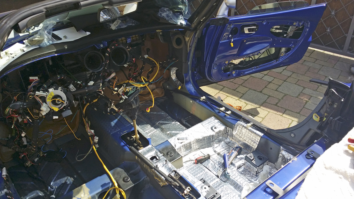

It’s very simple to do and makes a big difference. I know the Barchetta was designed to be noisy and you are meant to feel the car through all the vibrations - or maybe it was just cheap! - but I feel the car is much more fun and feels more solid. All I can hear now is the exhaust and the induction. It sounds great and driving, even for hours, is a pleasure.

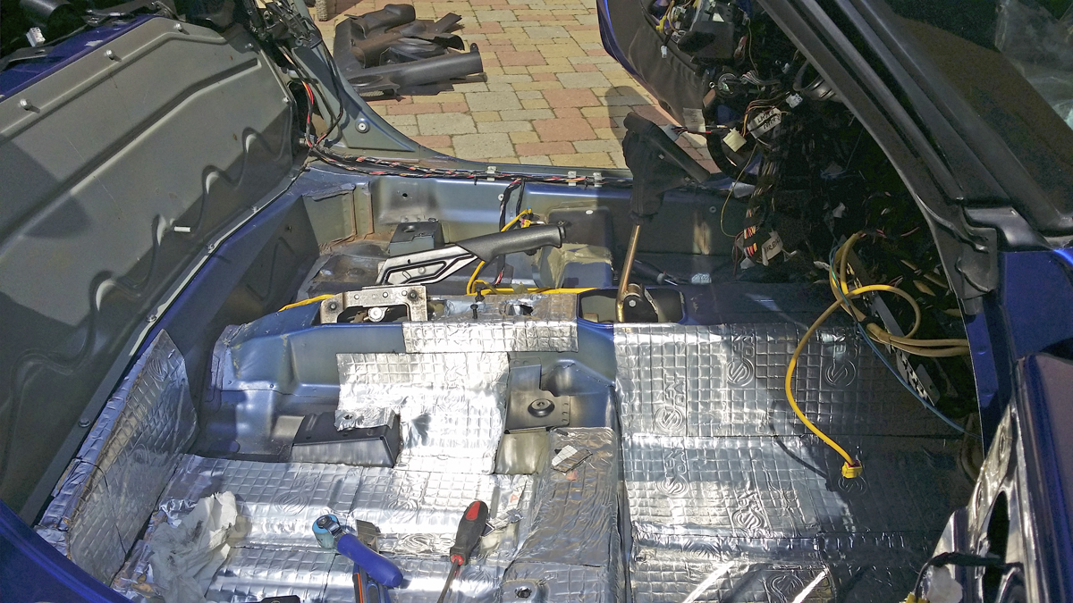

You have to strip out the interior - the seats, centre console, seat belts and the rubber matting. I used Silent Coat tiles that I bought from amazon.co.uk then overlaid it with Silent Coat foam. I made sure to cover every part - all the floor, the tunnel and side panels. I did behind the speakers too (made a big difference to the audio - shows FIAT were being really cheap to not put any there..). I also did inside the doors.

I also bought a roller from Amazon as you can see in the photo. Application is easy. Make sure the surface is clean. Just be careful of your seat mounting holes - don’t go near them with the tiles. The sticky black backing blocks up the holes and makes it a nightmare to put the seats back in. You can see in my photos that I didn't stay away from them which is how I know it creates a nightmare..
